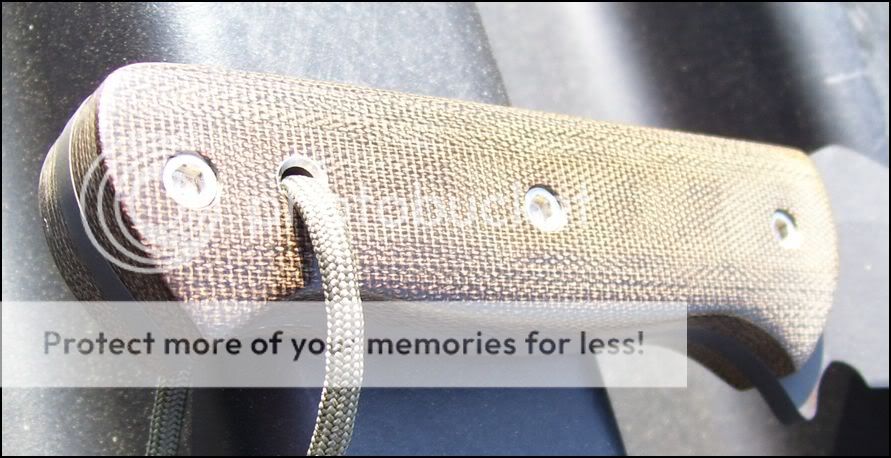

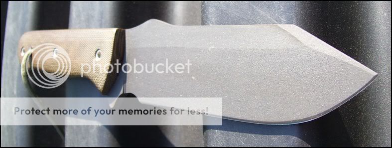

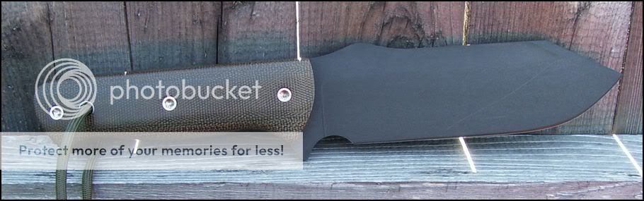

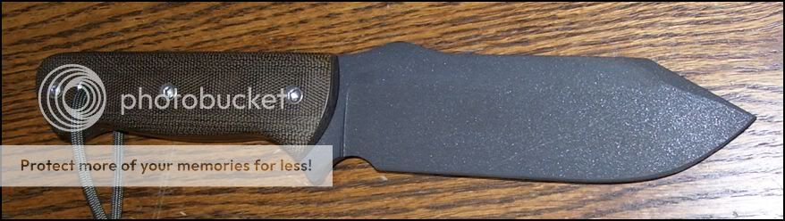

This was a project I did several years ago. It started out as a stock Becker Crewman.
I stripped it, sanded it all down & got rid of all the tool marks, reprofiled the handle, guard area, thumb ramp, made a choil and made new scales out of olive drab canvas Micarta.
The knife was then bead blasted and Parkerized.

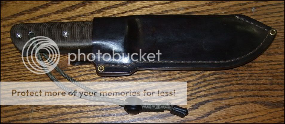

I also made the leather sheath for it.
The scales are removable as well.
In the close-ups you can see the attention I gave to fit and finish.

Terrible fit and finish, I clearly see an eyesore of a blemish near the tip in the last pic. You can't possibly be happy with a knife like that, therefore you should send it to me at once. :P
Thanks! I think...
J/K. It's been used a few times since the Parkerizing so there is a little spot near the tip and a barely noticable scratch as well. But this thing is meant to be used afterall.
I love the way the handle feels now. I removed about 3/4 of an inch from the back of the handle.
The subtle contours and shorter handle really helped.

I chose the Crewman over the BK2 simply because of the thinner blade. I think it's a great size and thickness for camping and bushcraft. Not too thick, not too thin.
It's a really good knife.

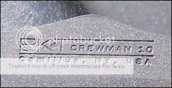

If I'm not mistaken I see a picture of the Crewman Head stone... now that is classic:)

I am curious about the hardware you used, one side looks like a rivet or corby, while the other side is an allen head, what's up? I'd like to do that to my Ontario 12" cutlass machete, but with hickory scales.
You're right, I did use 1/4" Corby's on one side, epoxied in and sanded flush.
The Allen heads screw into those which makes the scales removable. Also, the Corby's are long enough that they index into the existing holes in the tang. Worked out great. It's a trick I might use when I re-handle my BK14.
