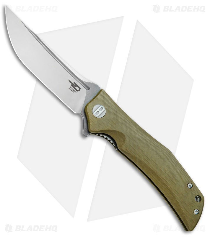

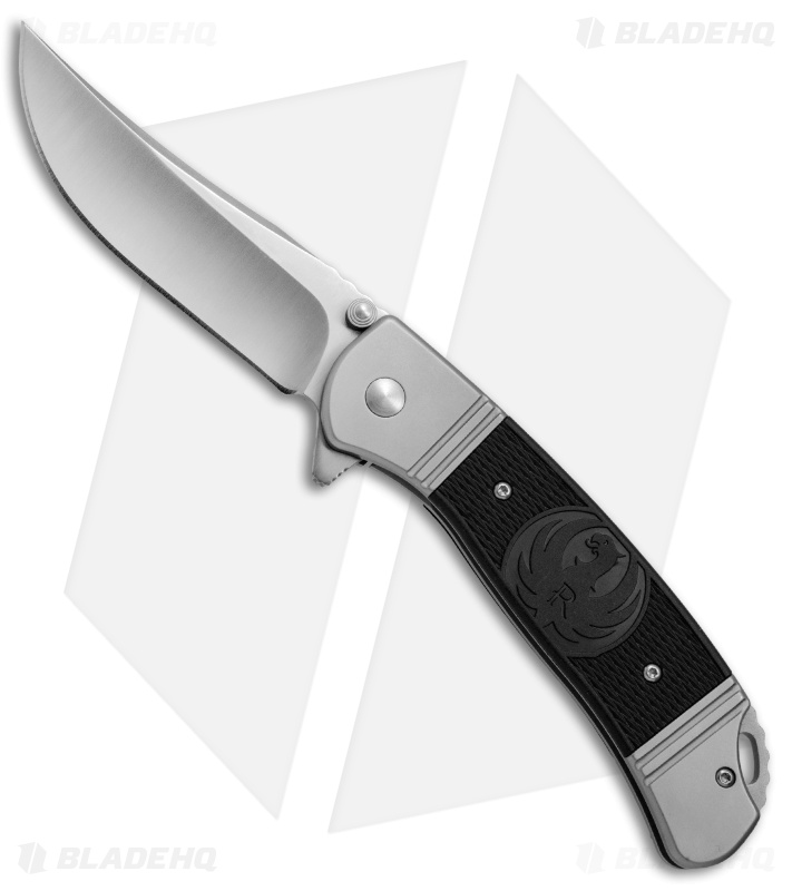

Why not just find a folder for under 50$ that has a sharpfinger like trailing point blade? I think that is a much better solution.
For example:
Bestech Scimitar 52$ at bladehq
CRKT Ruger Hollow Point 42$ bladehq

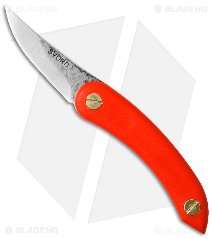

Check the svord peasant out.
https://images.knifecenter.com/thumb/1500x1500/knifecenter/svord/images/SV160a.jpg
You can modify it's blade, make a blade from some O1 steel available online to put in its handle, or just make your own knife from scratch using this very simple very old folding knife design.

Hey all, I know this thread is old as dirt, but I was working on the same problem as the OP, and found the thread via search. Wanted to share what I came up with, as so far I like it a lot.
I am a huge sharpfinger fan, and haven't found an inexpensive folder for EDC that touched on the things I like about the sharpfinger. So I got a svord peasant mini, and figured out how to modify it. I've done it 2x now, and it only takes me 40 minutes to go from off the shelf to fully modified. Bench grinder, belt sander, some sharpening stuff, and 40 minutes later, it is how I want it, and shaves my arm.
It isn't exactly a sharpfinger, but it has most of the things I like about an old sharpfinger:
  • Carbon steel (svord steel is good enough. Gets sharp easy. Doesn't stay that way forever, but life is all about compromises.)
  • Curved blade, w/ a point (svord blade shape is not very useful IMO, so I changed it to be more sharpfinger like. In fact, I think the svord peasant blade shape sucks, but the sharpfinger is almost perfect). It isn't a trailing point (so it differs from the sharpfinger in that regard) but the cutting edge and point are similar in profile and functionality.
  • Great ergonomics. This is where sharpfinger, along w/ the above departs from all the affordable folders I could find. Sharpfinger allows you to control knife position just in the pinch between thumb and forefinger, to invert the knife and do the same, and to not lose track of where the sharp part is when I'm elbow deep in a deer. And you can't slip up the handle onto the blade. It is great for gutting, skinning, popping joints open, opening boxes, etc. The sharp parts and the pointy parts are intuitively where I want them all the time with the sharpfinger. The reshaped svord isn't the same knife, but it gets it pretty close and it hits the high notes. The only thing not perfect about the sharpfinger, is when I need a folding knife for EDC, as I don't want a sheath on my belt, it remains a fixed blade. This modified svord mini fixes that problem.
It's light. Cheap. Easy. Super functional. And if I wanted to geek out and use some spalted burled maple to make different scales, I could make it super fancy. Which I might do for a gift, if I come across anyone who deserves one.
The key moves:
  • Buy a svord mini.
  • Fire up the bench grinder and:
    • Grind out a place for your thumb, with a slight rise
    • Grind out a finger stop, a bit behind where the thumb rise is (hold it and see where your thumb lands)
    • Change curve of the blade for a more even upswept profile, and more of a point (easy! careful not to burn it. touch it, then dunk it, touch it then dunk it. especially near the tip).
    • Trim down the handle so its a bit less chunky.
  • Fire up a belt sander, and get the primary bevel right in the area where you reshaped the blade. Careful not to burn it. Especially the tip. Touch it. Dunk it. Touch it. Dunk it.
  • Rough out the secondary bevel. I use a chainsaw file, because that's how I am, and it is just a $20 knife...
  • Use sharpening gear to get it really sharp.
  • Done.
