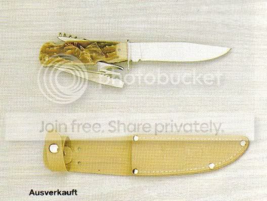

Scottman, there has been knives made very similar to what you described (if I understand your description) for many years.
There were some early models from Germany I remember with stag handles and a saw or blade that opened out of the handle.
I tried to locate a pic of one but could not find one.
Oh, I think you would love the Revolver series, they work perfectly, and have for four years now.:p
Robbie Roberson.;)
something like this ?
current model , availiable ex Germany

The german design, as shown by Myal, is certainly ugly, but you get a (supposely) full potential fixed blade, and some folding tools that would probably a bit awkward to use but not that much.
Another design that is quite goofy, but seems to work on paper is that russian "balisong multi tool" (sorry I can't find the pics back): it is a lot like the revolver design, except, instead of having a rotating handle, the handle works as a balisong, releasing one blade while it protect the other one. In theory it would be more reliable mecanisme, but more pivots could also mean higher britleness.
Another idea that seem smart on paper is the system seen on recent leatherman hunting knives such as "steens", were the saw folds other the edge, an improvement other the spyderco vagabond system. But that system probably require too tight fit, and might probably let you down in the field: not robust enough IMO.
Honestly, if I had to choose among all those designs, I think I'd choose the "german" one which is really ugly, but seems the less complicated and most robust. I think many german and/or Czech maker have done that sort of pattern, but those have gone out of fashion, since they are pretty ugly and not significantly better than a fixed blade+a SAK.
