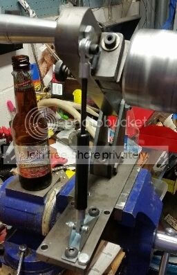

Did the gas shock upgrade last night. Another inexpensive upgrade.
Brought to you by big butt doppelbock
You may want to flip your piston, to keep grit out of the seal as much as possible.

McMaster Carr part numbers
9416K11 Gas Spring with Threaded Ends, 40 Force, 5.90" Extended Length, 2.36" Stroke
9416K29 C-Style Eyelet Bracket for .24" Eyelet Diameter, Gas Spring with Threaded End
9416K84 Zinc Eyelet End Fitting for M6 Thread
Once again, courtesy of M.G.
