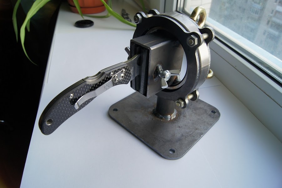

small vises
soft bearing rotation
short tube 55 mm wide allows to work with exotic blade forms

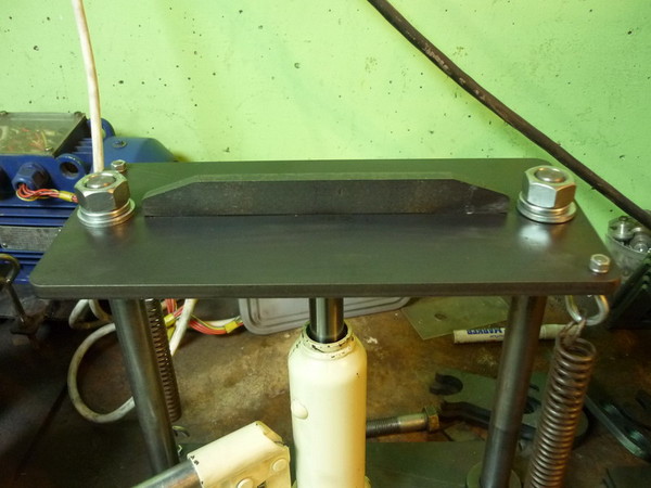

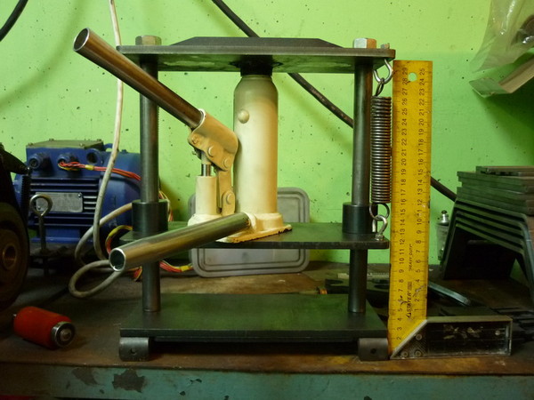

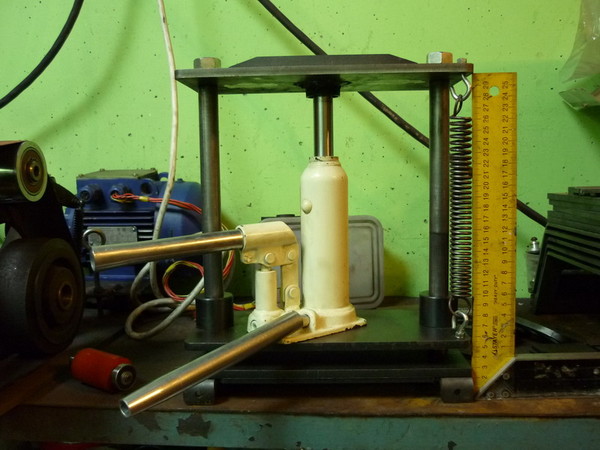

to day two big devices
1) quenching press with fast changable heavy metal plates

Making tools is a much fun as making knives :)
Great work. Love the quench press
