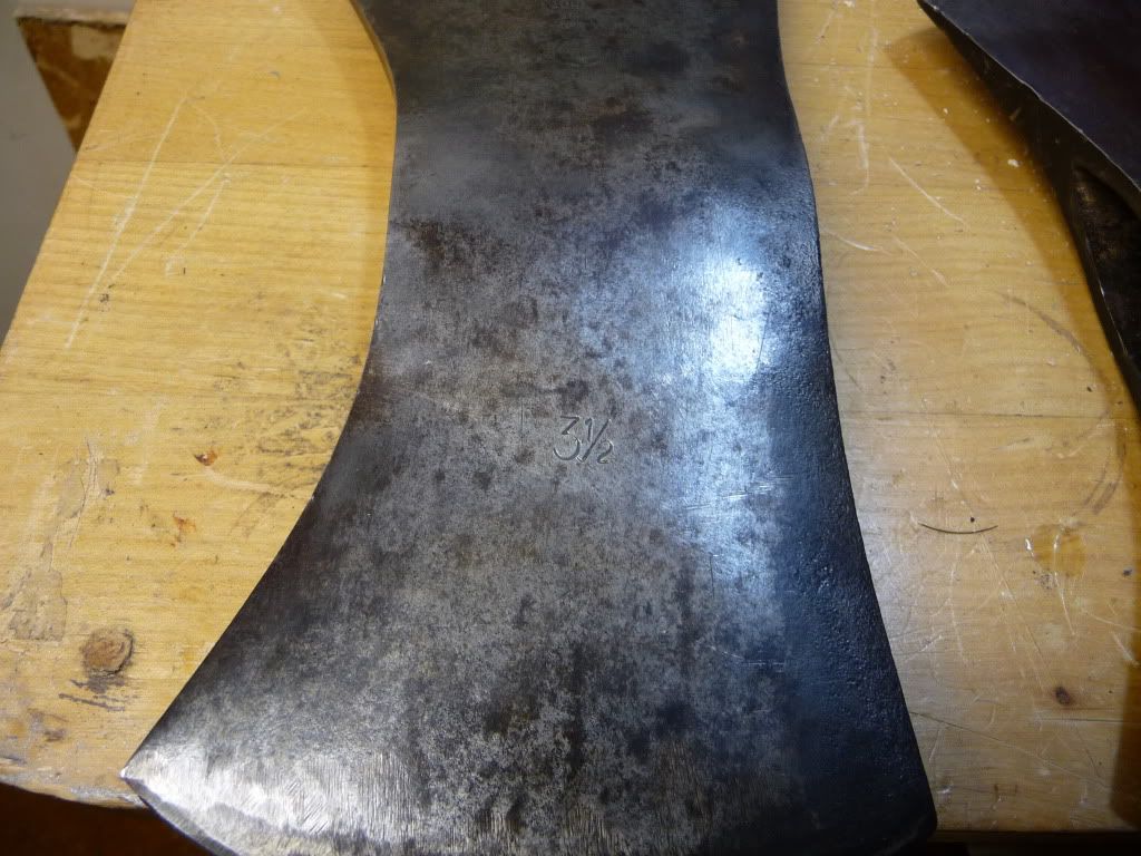

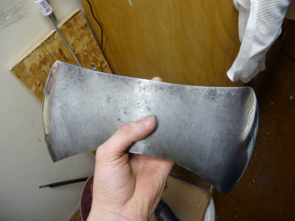

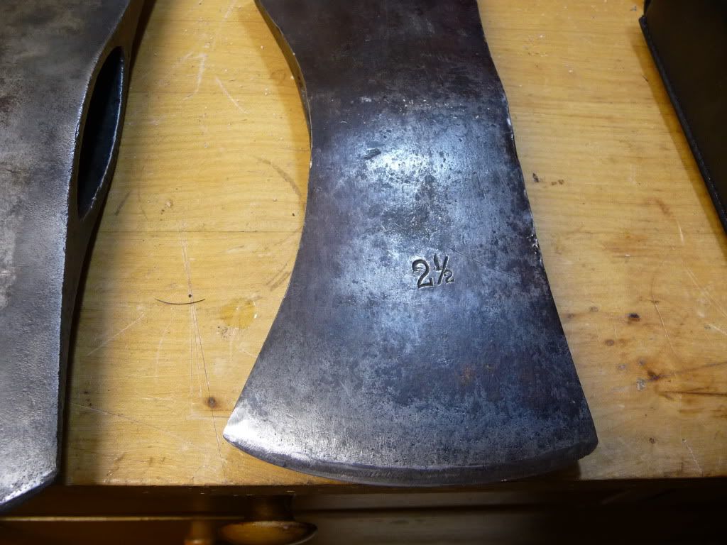

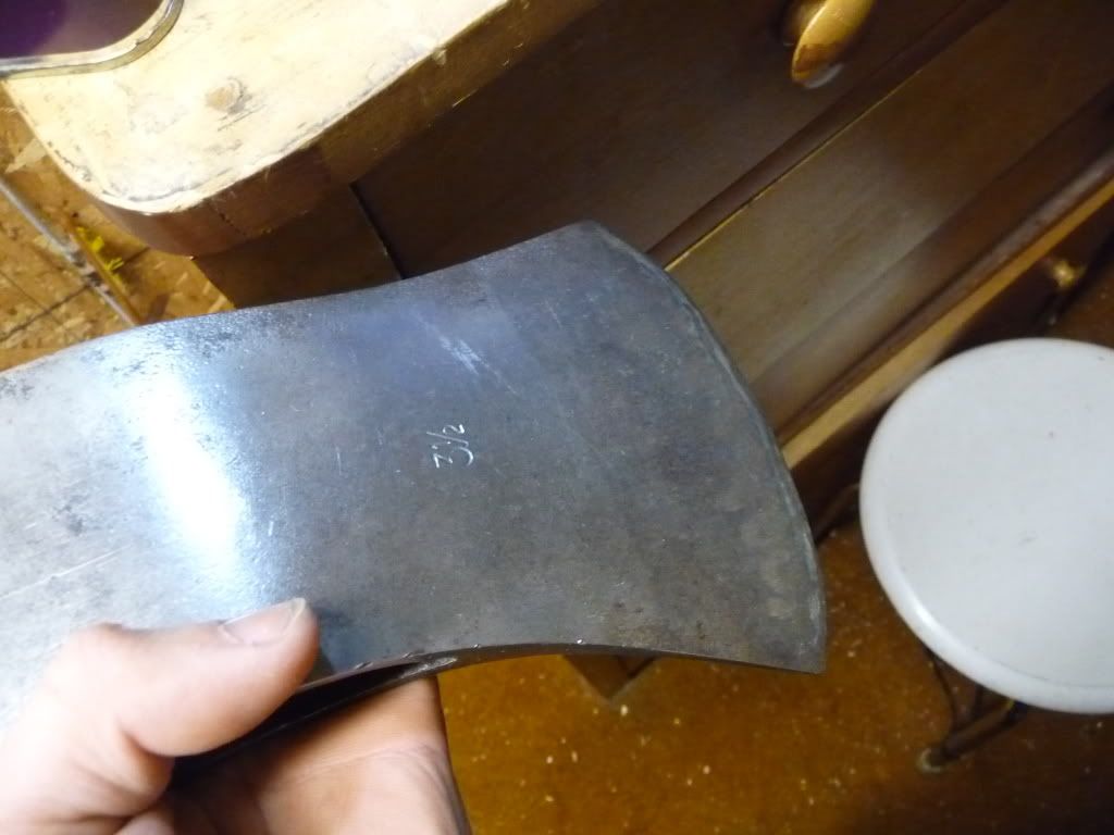

The first is a 3.5lb head, about 9.5" total and with a 5" cutting face.
The second is a 2.5lb head, about 8.25" total and with a 3.75" cutting face.

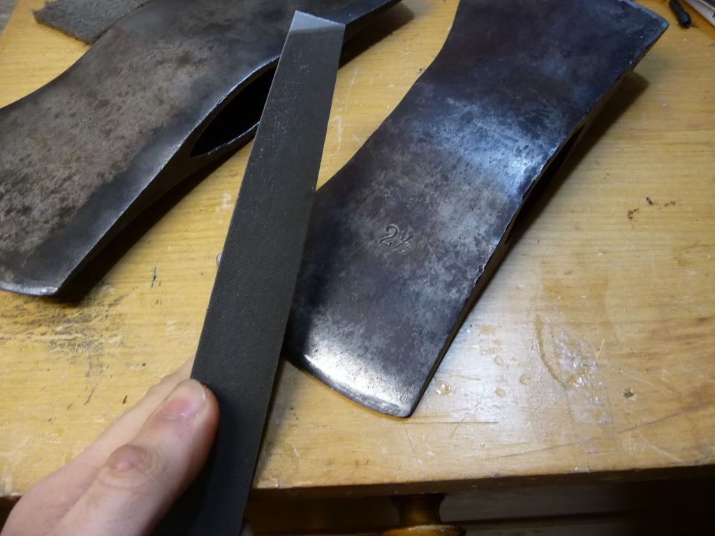

Right off the bat, I tested them with a file to see if the temper were still there... the file (a nicholson mill bastard) skidded on the edges unless decent pressure were applied. Having two GBs and a wetterlings on hand, I can say that the heat treat is definitely similar (a 56-58 hrc edge).
Without further adieu, pictures! :thumbup:
The two heads:

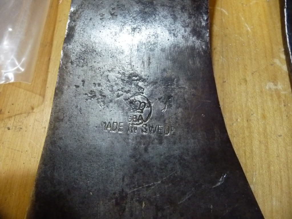

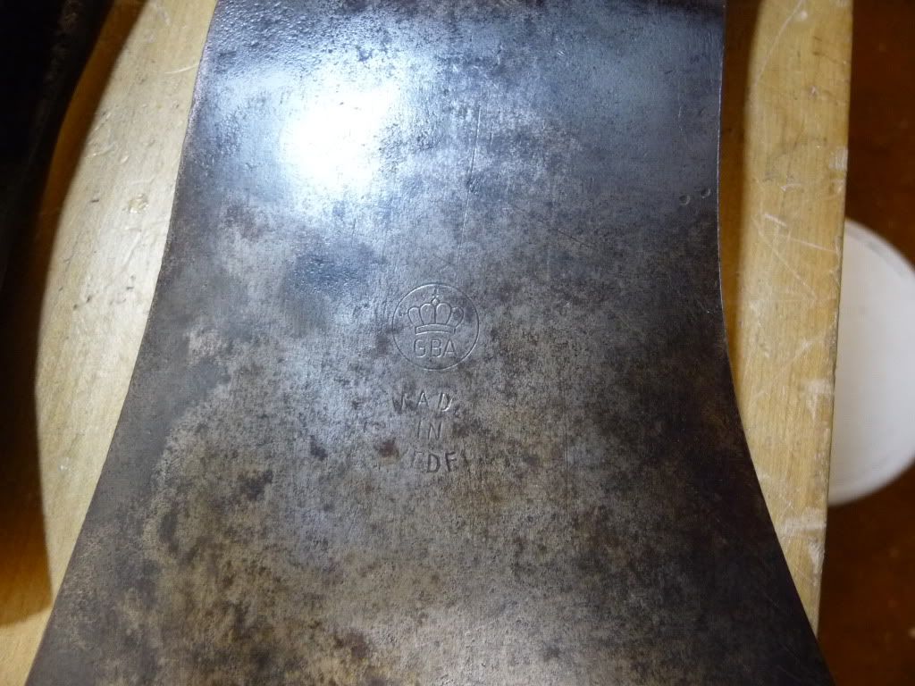

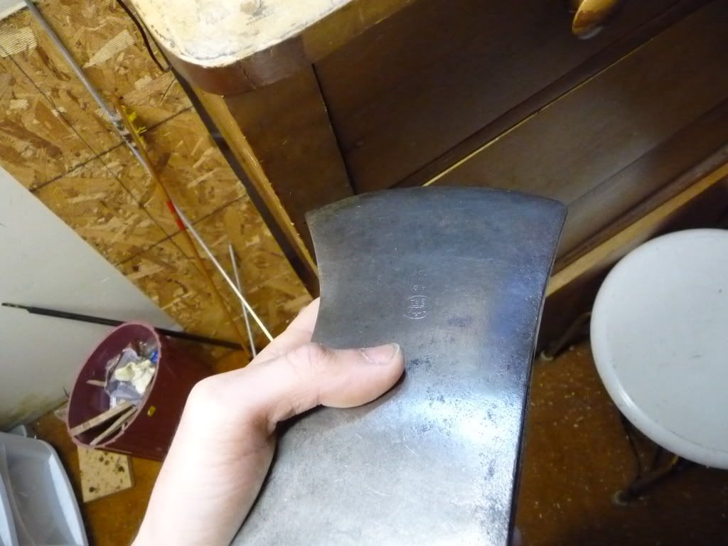

GB stampings (sadly rather worn out on the 3.5):
Weight stampings:

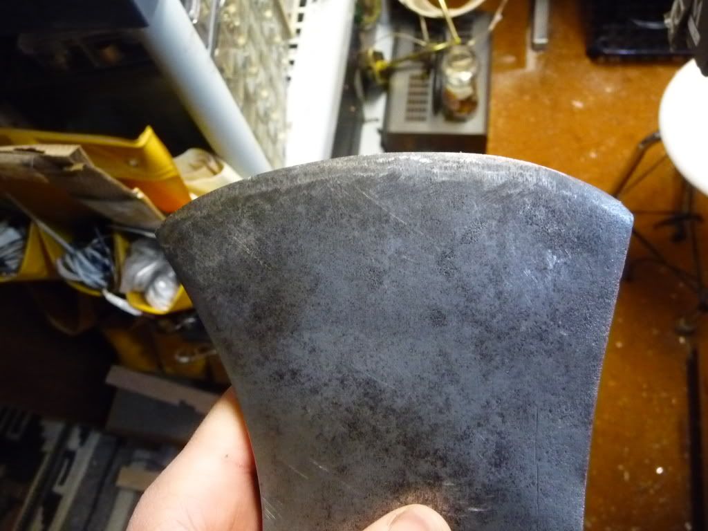

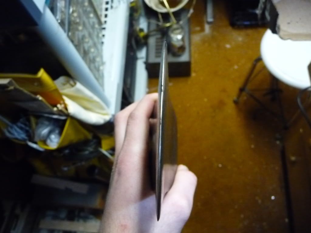

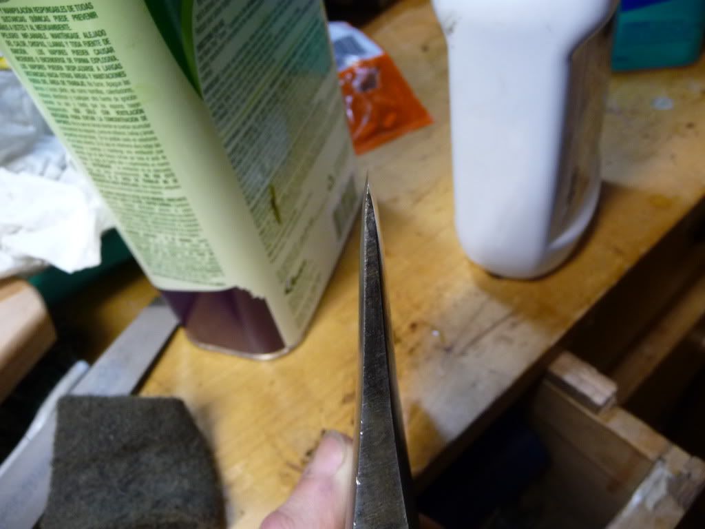

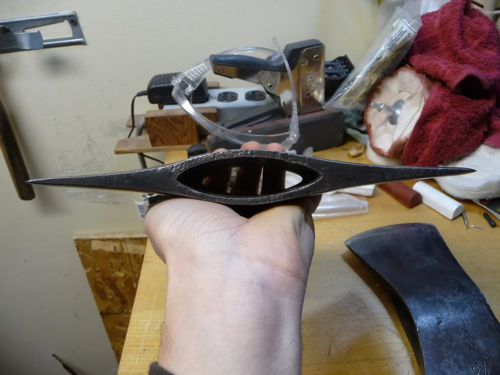

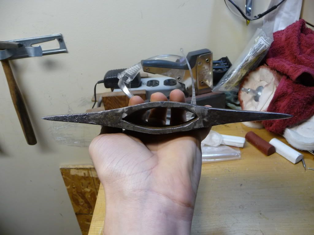

And the profiles:
Tested the temper on each with my trusty nicholson:
I think I'll try to take off the rust with a vinegar soak followed by scrubbing. Thankfully the edges are in fairly good condition, so I won't be having to sharpen out large dings... the 3.5lb does have a bit of an uneven profile (you can see that the upper corner/toe on the right side is a bit more intended than it probably should be).

I decided to work on the 3.5lb first and started off by trying to clean it up a bit. I didn't quite have enough vinegar to totally submerge it, so I went ahead and used mustard instead. After letting the mustard do it's thing, I scrubbed the head up with dish soap and a scouring pad. Rinse and repeat with another layer of mustard.
At this point, the hamon line really popped so I decided to take a couple of shots:

Alright, so the 3.5lb head looked pretty decent in the above pictures, but the edges actually had minor depressions making for a wavy, and not very consistent, curvature. I trued up the edges by filing along them, which of course means a flattened edge that needs resharpening.
Trued up:
But a very flat, dulled edge:

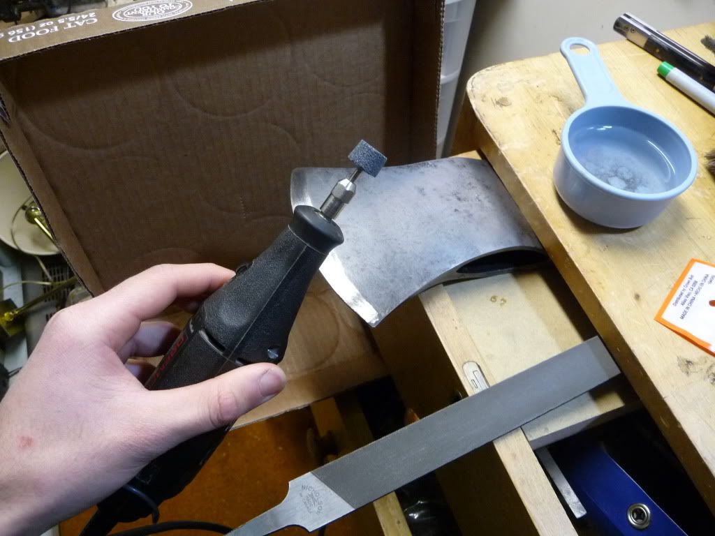

And since there's going to be a lot of metal that's going to need removing, I'm opting for a method that I tend to use in lieu of a grinder/belt sander: my dremel + a grinding wheel (after which I use a file then a mousepad + various grits of sandpaper to create a keen edge). I know everyone is going to berate me for potentially ruining the temper and grinding along the edge instead of towards it, but the head is constantly cool: I only do one quick pass with very light pressure before adding water so the metal never has no chance to heat up. The tools that I've re-profiled in this way have never had temper problems so I've decided that it's perfectly fine method of re-profiling / doing massive initial sharpening.
I'm fine with your method, although would prefer to see a flapper sandpaper wheel instead of a stone. You're clearly more then capable of doing a good job with the stone though. It will be all good in the end.

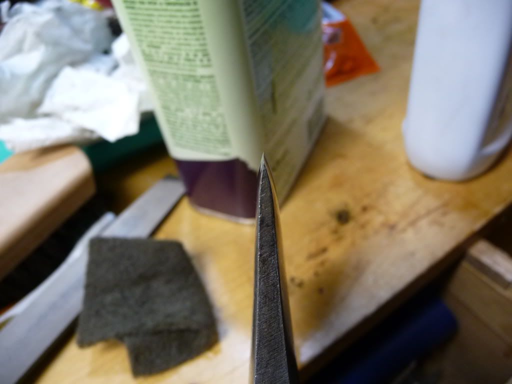

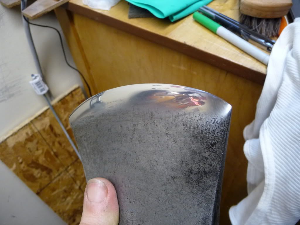

Alright, so now that Ross is gone, here's the fruits of my labours. I put off food and sleep on a couple of occasions and my forearms feel like jelly, but I'm quite pleased with the results. Oh, and I also only used the dremel for the more obtuse edge - the re-profiling of the more acute edge was done entirely by filing as that side was started around midnight and the other residents of this household might not have appreciated the noise :o

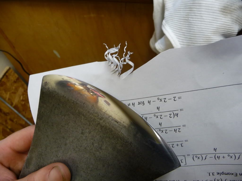

Final product. After the re-profiling with the dremel and file, I sharpened the edges with 100 then 220 grit sandpaper on a piece of mousepad. After that, it was given a forced patina with more mustard then scrubbed and sharpened further (400, 800, 1000, 1500, and 2000 then stropping on .3micron chrom oxide loaded leather). Necessary? Heck no. Pretty? You be the judge:
Obtuse edge:
Acute edge:

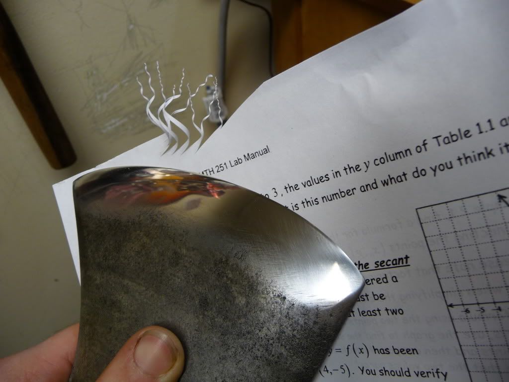

My lady friend is pretty cool with my affinity for sharp things, but not so much with my looking like I have mange, so shaving a small patch of hair every time I sharpen something has become a no-no. Instead, here's maths!

My concern right now is that I'm not 100% sure I got my edge geometries right... but I guess I can't really test that until I get it out for some chopping. I based the profile mostly around my GB Scandi as I know how that thing chops with its given geometry. I made the obtuse edge a wee bit steeper than the Scandi, but not by much (I want it to be tougher for working with harder wood, limbing and maybe working near the ground, but I'm not planning on deliberately smashing it into knots or grubbing with it). As for the more acute edge, I made it a decent bit keener than the Scandi and really narrowed the cheek out so it should bite very deep - wondering if it will have sticking issues though.
Whatcha guys think about the geometries? I'll probably start on the 2.5lb head in couple days, but I thought I'd get some opinions on this first before moving on...
