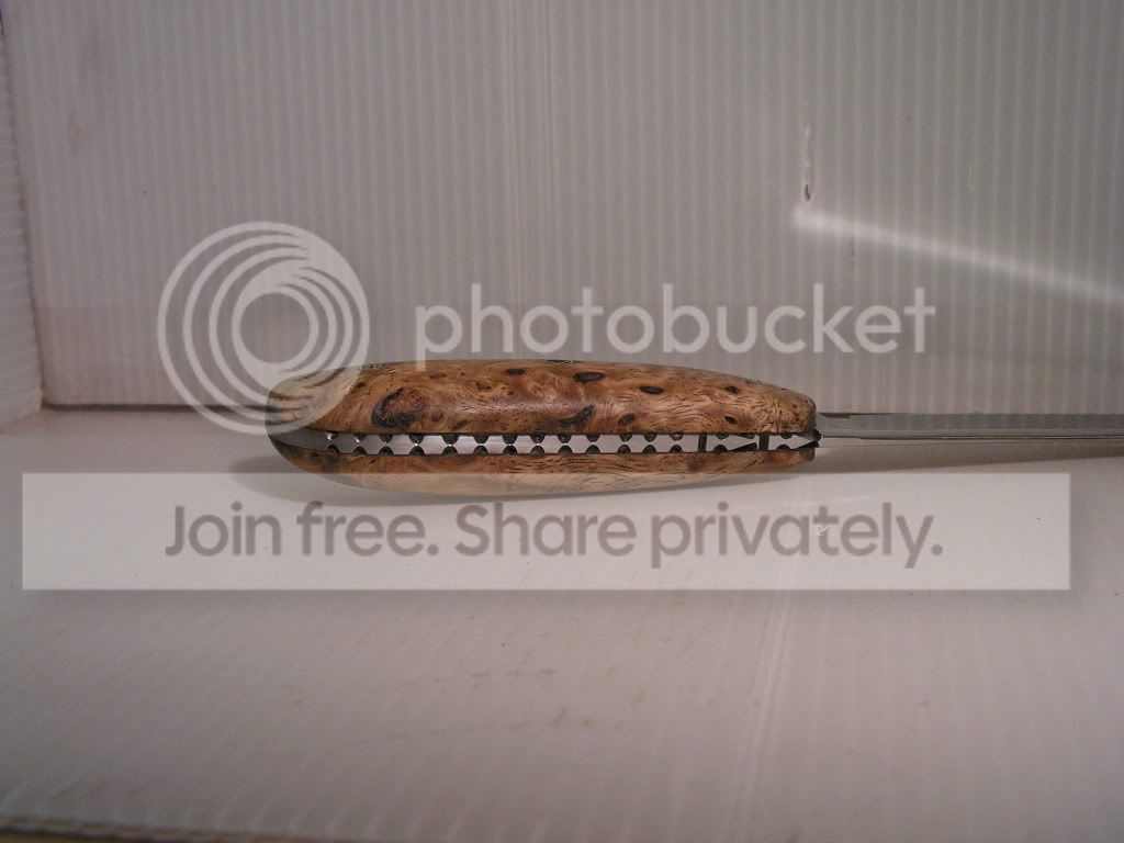

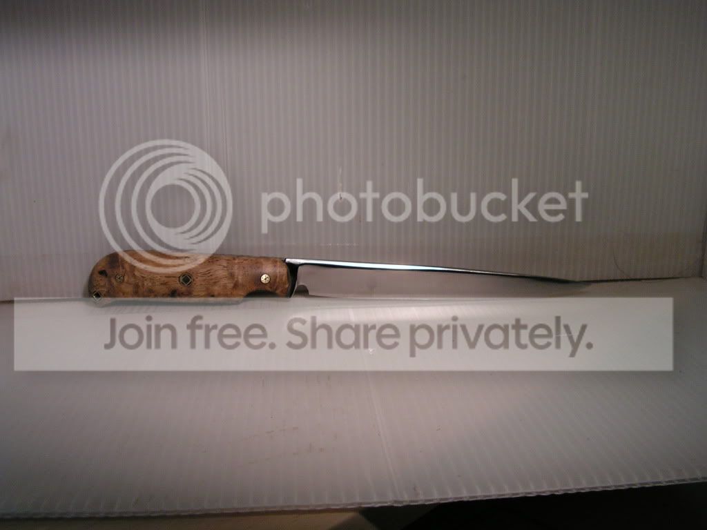

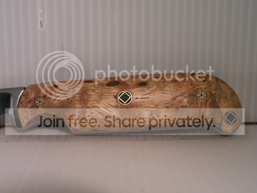

I told several people Ide show some knives. This is my latest I finished last night no sheath yet its being made later today. The wood is stabilized Amboyna wood with 440 c steel rc is 59 to 60 I really like the wood hard stuff just the way i like wood to be. I had to resand it once cuzz the buffer did some slight staining so I resanded to 600 and then wiped with tung oil and buffed with a plain new buffing wheel no compound. kellyw
Thanks ive been trying all kinds of different woods lately , ive done alot of iron wood so I figured its time to try other stuff. This wood sands like steel as hard as ironwood just bt feel but my ironwood isnt stabilized so im sure thats why it feels harder.
