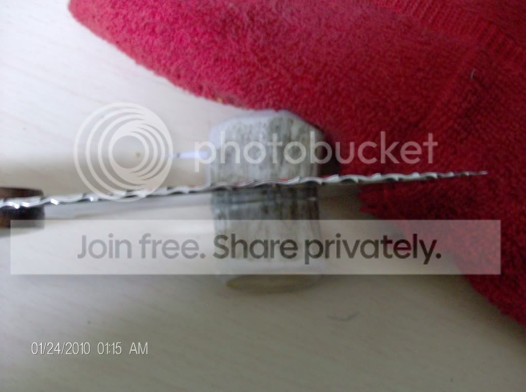

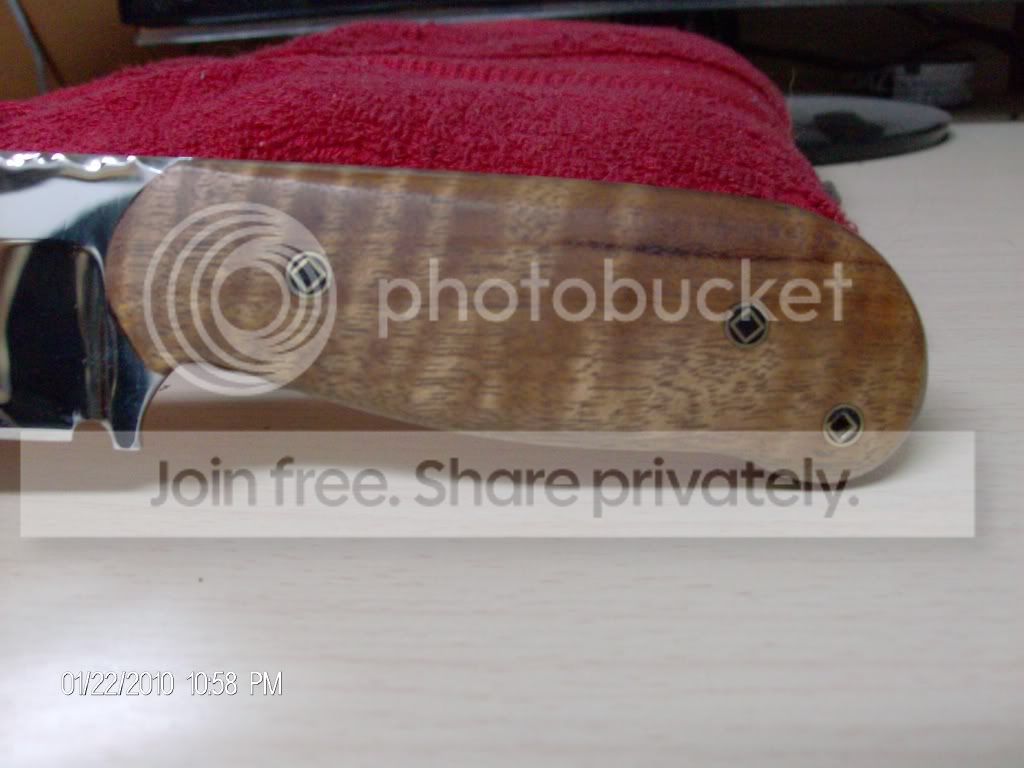

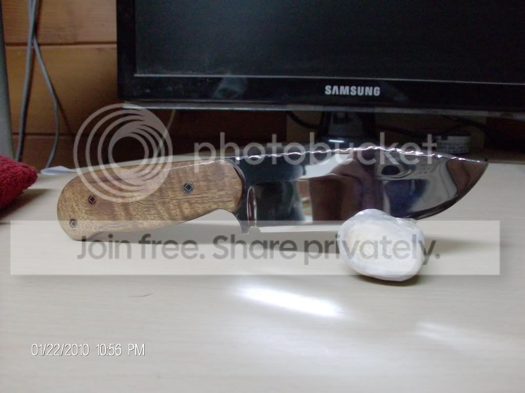

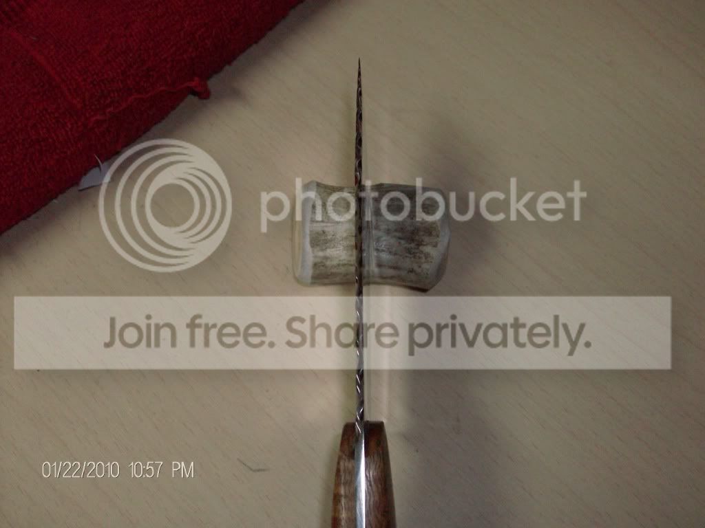

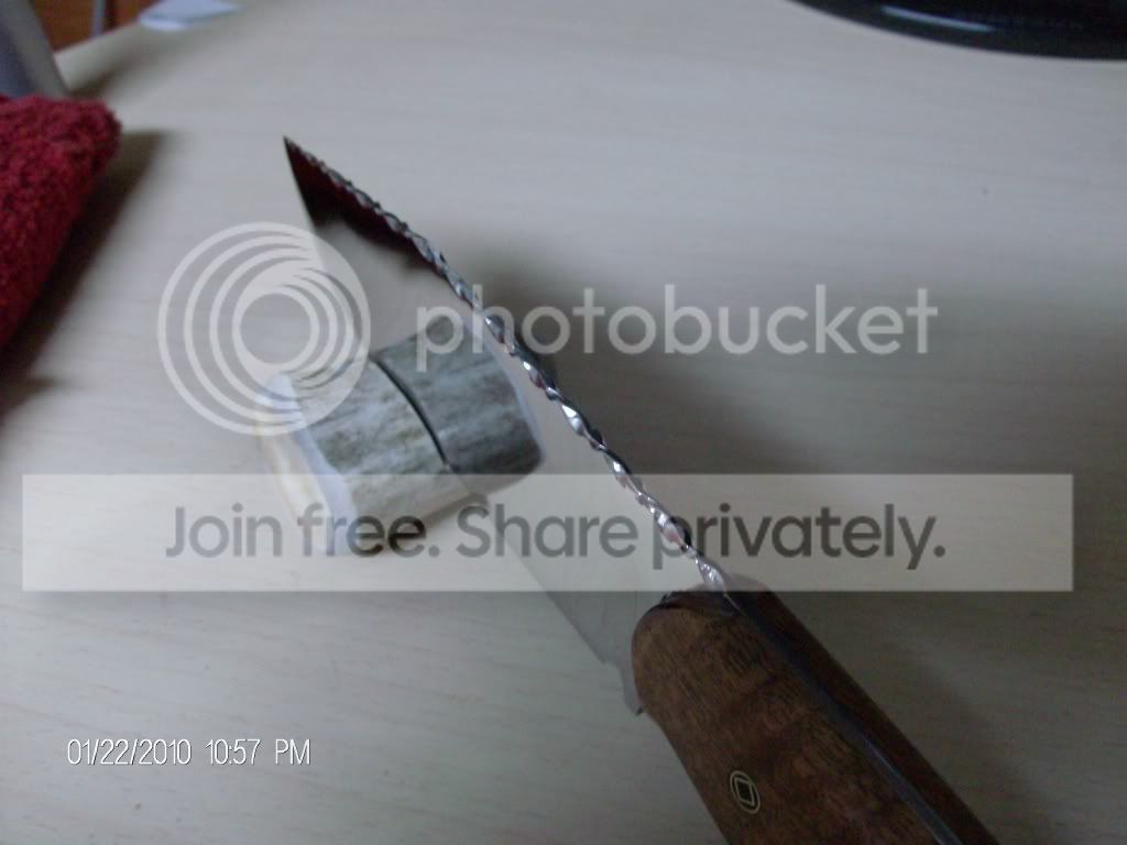

The wood is KOA the steel cpm 154 rc 60 my own mosaic pins , creeping vine filework sorry my picture is poor. I resanded twice cuzz I was not happy but I think I got it to shine now after taking it to 1200 grit for 20 min then buffing for 30 with green and white compound. This one was a challenge.
I like the idea of matching mosaic pins and thong tube. Nice filework and buffing too.
It looks like the scale on the right in the bottom picture is a little less tapered near the blade than the one on the left. It might be something to look at.
I think that is just the angle of the camera playing with you:D
On the side that looks bigger you can see the side of the blade
Its just the angle you are seeing it. look at the blade and you can tell its angling to the left!!
