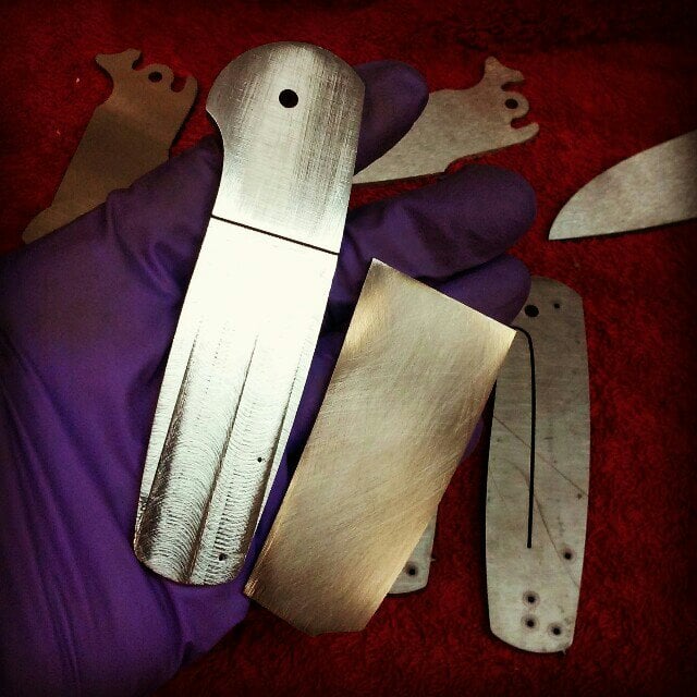

Manual milling done on RF3 frame for Zirconium inset... Zirc inset roughed out and square on end.
Zirc clip holes drilled, counterbored,chamfered after being roughed out on bandsaw, Zirconium spacer roughed out.

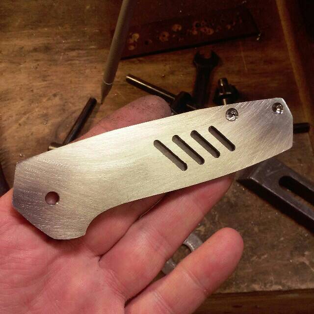

I'm doing a black Zirconium inlay that will show through slots milled in this RF3 Tanto frame show side.
Layout one and milling has commenced! I'm doing everything by eye and by counting mill handle turns.
See through...
Inlay cut, ground to size and quickly blackened for mock up...
4 hours into the Zirc insert/relief in the Tanto so far... it's looking good!
