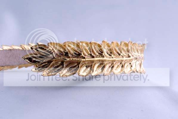

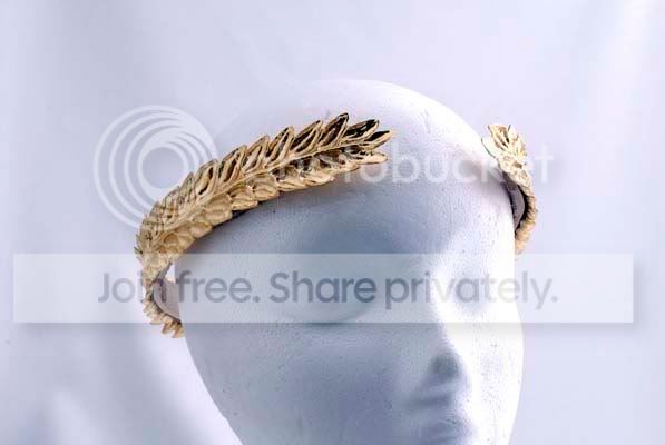

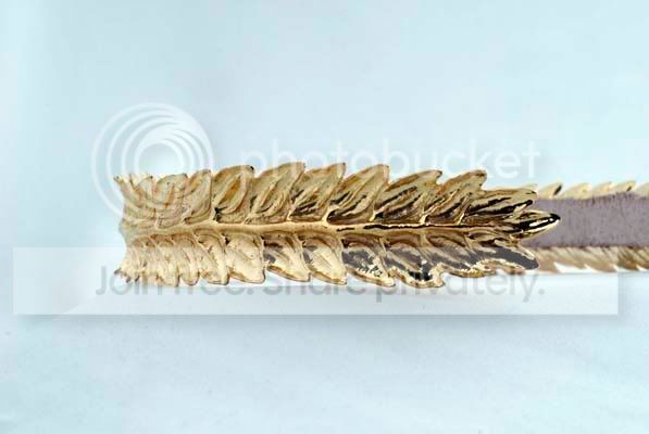

I just thought I'd share a couple pics of my latest piece, it is sterling silver, repousse formed from 20 gauge sheet sterling silver, then goldplated. It is for an award in the Society fr Creative Anachronism. My customer has earned the SCA's highest award for excellence in the arts and the laurel wreath is the token of achieving that.
I have about 90 hours into this hat, some of the relief is more than 3/8 inch deep.
Thanks for looking
-Page

Wow! Page that is cool. I dig this kind of work. Was looking at repousse tools the other day, though for a different application. That's really amazing. I didn't realize you could do that much relief in repousse. Is it the gauge of the silver that allows it? If so, is there a rule of thumb for such things? You can tell how ignorant I am of this but I've always thought these practices might be applied to knifemaking, and I look through the Rio Grande catalogs with that in mind all the time. Thanks for the inspiration!

The gauge of the silver is one partially limiting factor. If you work just straight up and down 20 gauge will start to blow through in sharp transition areas, With proper annealing and upsetting metal into transition areas I have been able to get almost 1/2 inch relief (that's detail relief, not general raising depth) Thicker metal is harder to move but allows more transition relief.
Silver is extremely good to work with, high karat yellow gold is great, copper is good, high copper bronze is workable, mild steel is painful and stainless doesn't work.
The repousse tools in Rio are a good start, but very clumsy, I have modified all of the tools that came in the set from Rio. I make my own now from square water hardening drill rod.
-Page
This piece has close to a half inch relief in the sharp edged ridges on the base level of the bottom layer, it is also worked in repousse from 20 gauge sterling. My first attempt I didn't move metal into the transittions, and had several ruptures
What you see here is the second attempt. I have kept the first one as a teaching tool for when I teach repousse.
