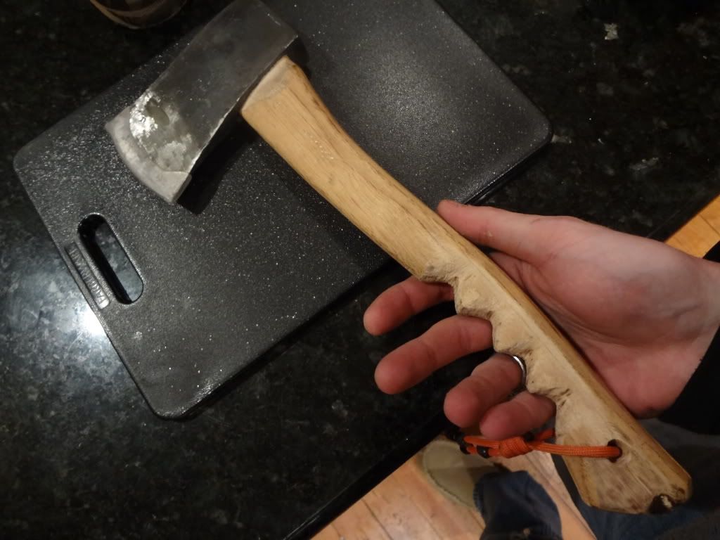

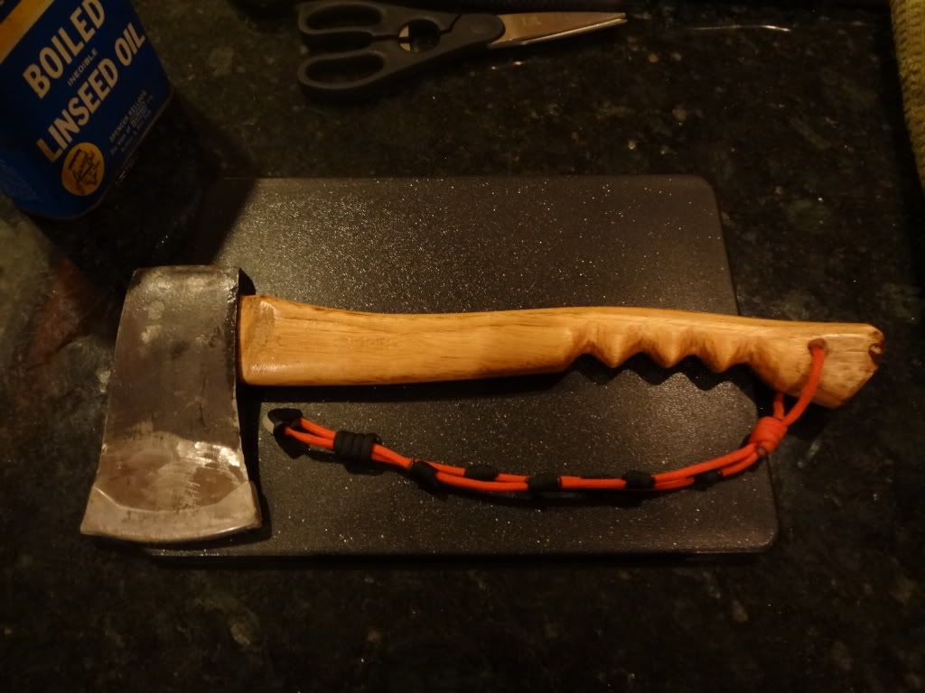

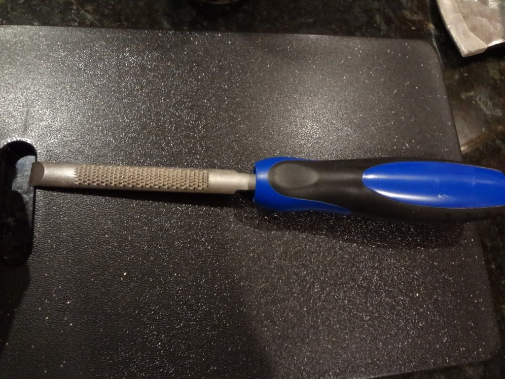

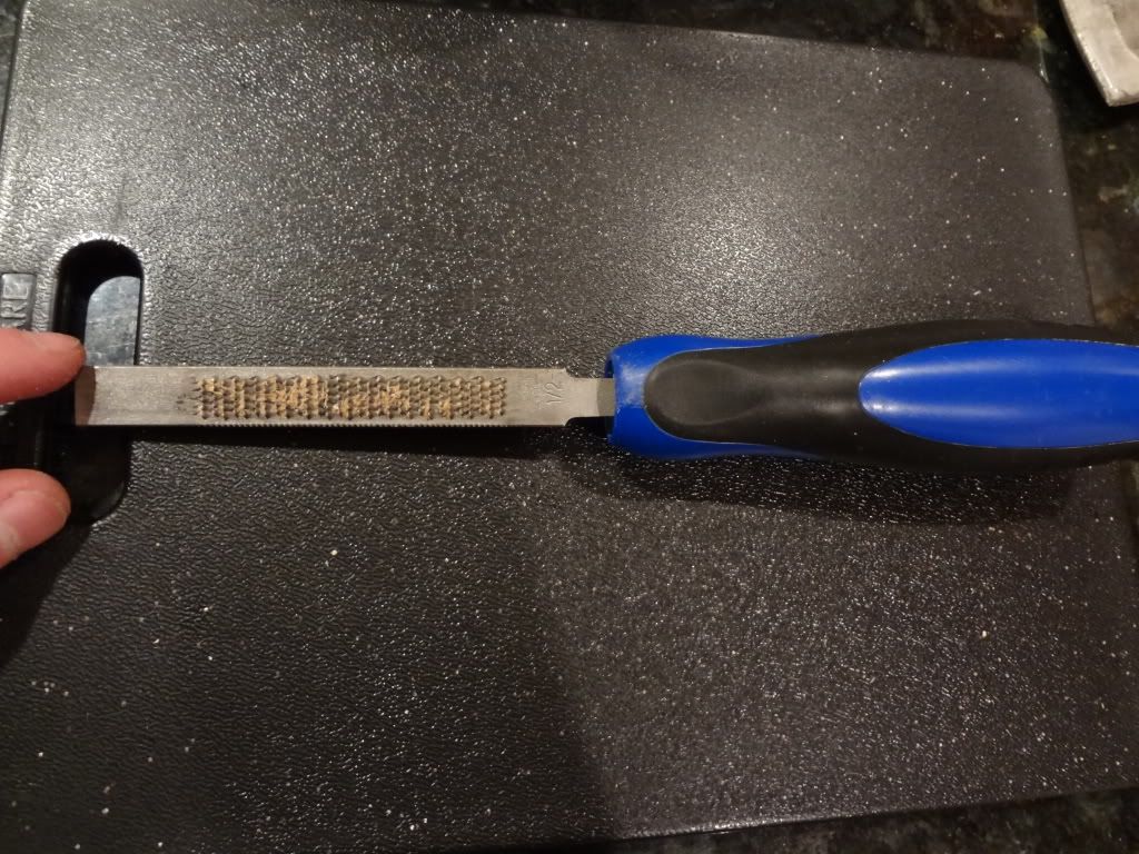

Well I decided to do a little filing with a Kobalt file that has a flat side and a "half-moon" side. I still have got to go over it with some fine sandpaper and then some extra fine sandpaper. Also going to wipe the handle down with Boiled Linseed Oil. I will get some pics of the final product up as soon as I finish it though :) thanks for the inspiration on this one thriller. I must say the handle is much more comfy and feels like I have more control. If your wondering about all the grinder marks on the head of the hatchet I just havent gotten around to filing those away and making it looked more polished. I had to remove some of the blade because it was too thick near the edge for my liking. I find a hatchet that has a little thinner metal near the edge goes into the wood easier making it more efficient. I hope it turns out good after I finish it completely. The very next thing I'll do is file the grinder marks away with a bastard file. Anyway here are the pics haha
The File:
After a little 320 grit sandpaper and some boiled linseed oil to help stabilize the handle and bring a more uniform color out. Still think I am going to go to lowes maybe tomorrow and pic up some 600 or 800 grit to see if I can get rid of all the file marks. Then I shall put a couple hours into getting the grinder marks out of the metal. I am always open to suggestions to what I might be able to improve on so if anyone sees any flaws or just something you think you should say please post it up.

Wow, kudos on all that elbow grease, like the new look of that axe. For the last one, be careful removing too much wood for those finger grips, if you chop too hard it's a weak point and no telling where the sharp end will end up.
I appreciate it thriller. Also I thought about how much I could remove before sacrificing the stability of the handle. I have tested it out on some Fatwood/Fatlighter and it did pretty good. I am also gonna test it on some hickory and oak that I have split up in the back yard. I have been hit in the chin with friskers 17" camp axe and let me tell you it hurt. This happened about 2 years ago but it defiantly taught me to think about the structure of the handle. If this one does break I will replace it again and remove just a little less on the grips until I find that sweet spot. I just like having the deeper finger grips/choils so I can feel the grips coming up between my fingers which gives a little more control and comfort. I did leave enough at the top of the handle so I can use it to make tinder sticks or chop up kindling. As soon as I take the chainsaw to the fatlighter stump I have I'll try and remember to get some pics or maybe a video of the hatchet doing its job. I have got to head off to the woods here soon and get a few more fatlighter stumps. Gone through 3 so far this winter. Ill defiantly let y'all know if I removed too much on the handle and it breaks though.

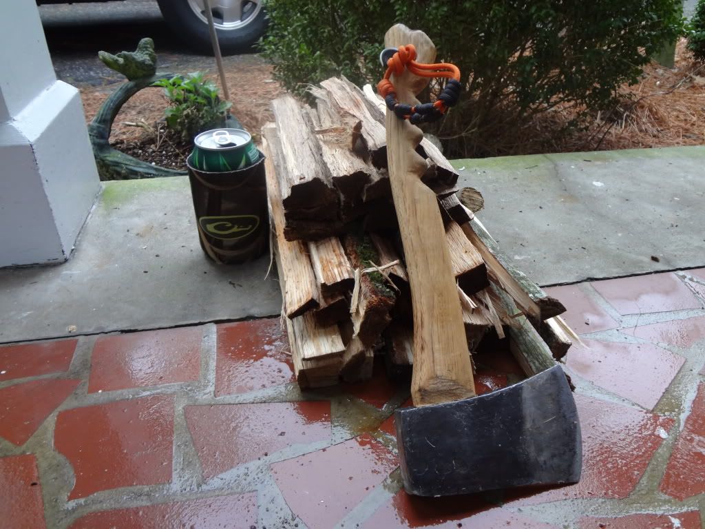

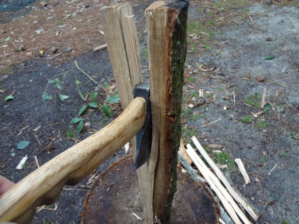

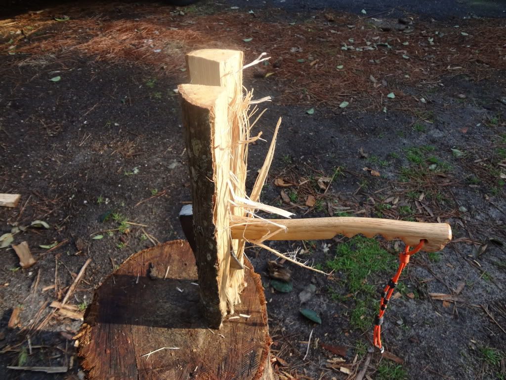

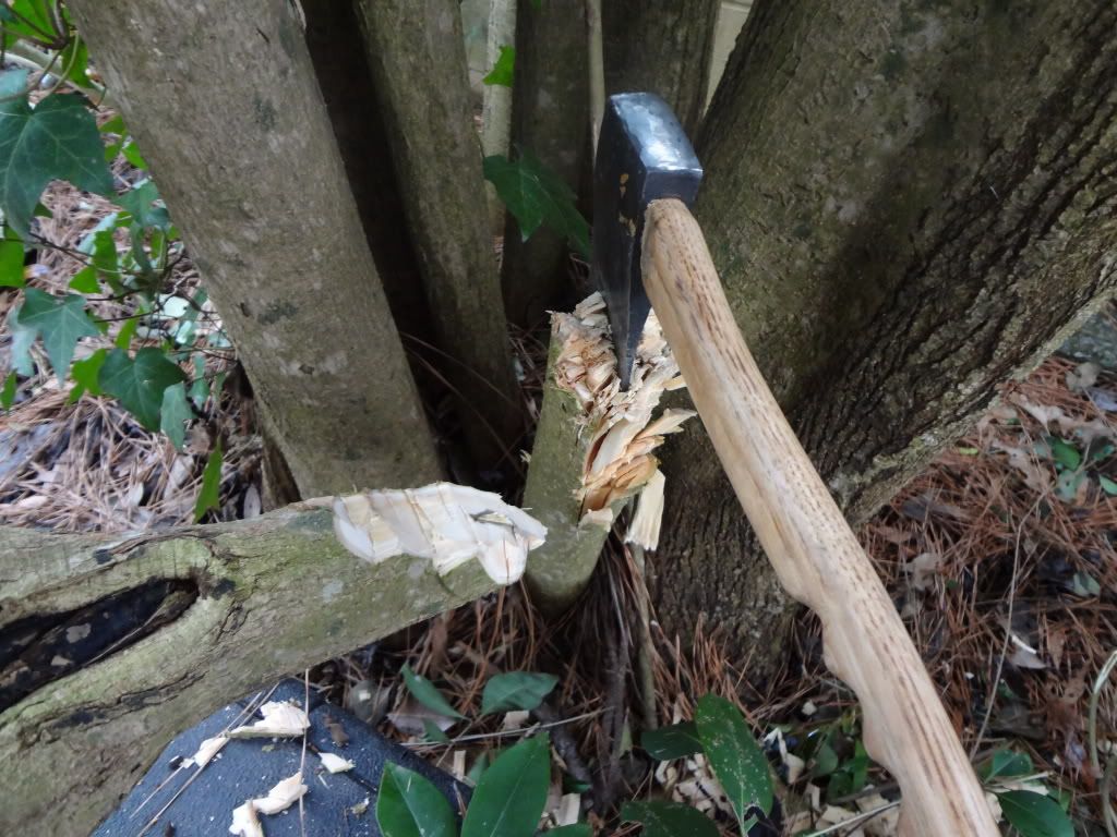

It's been a rainy day here so I figured why not do a few tests on the handle. Anyway here are a few pics.
Hickory:
Red Oak:
The total outcome:

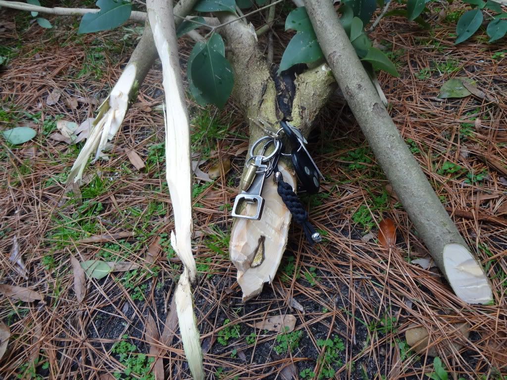

Overgrown Privet Bush (Ligustrum). Its pretty well much a tree as it was planted when the house was built (1938). Needed trimming on the lower part.
I did have a few glancing blows to the handle right behind the head and the handle held up pretty well. I will have to continue testing to see if it will continue to hold up and not break. I do agree the handle may be a little on the thin side but I can say it is comfortable. There are no hotspots so I'm pretty happy with it but for the next handle I modify I will take a regular circle file and make the handle grooves a little more shallow to increase the stability of it.
