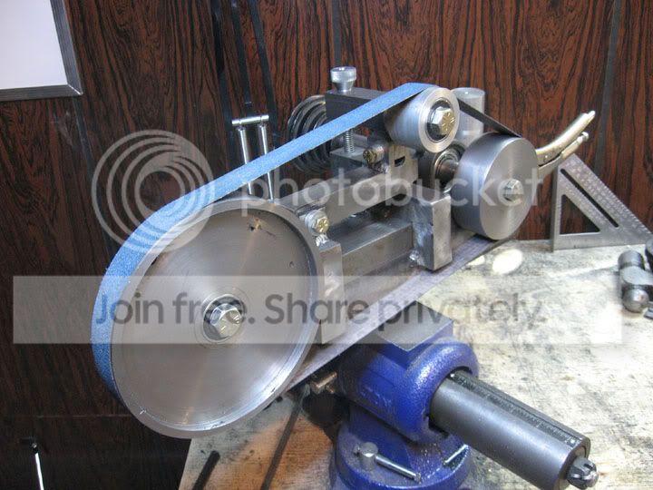

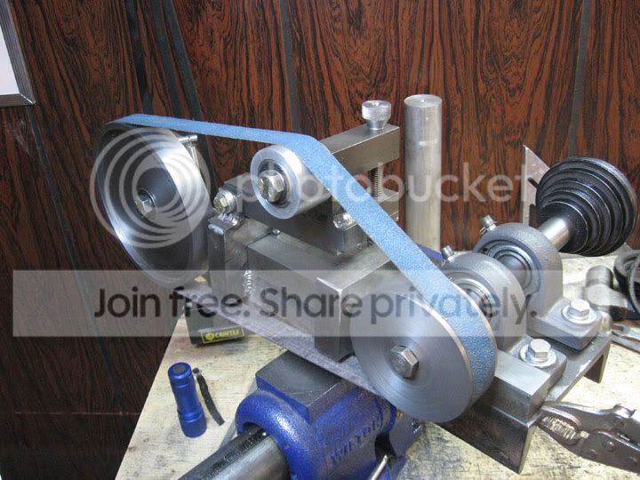

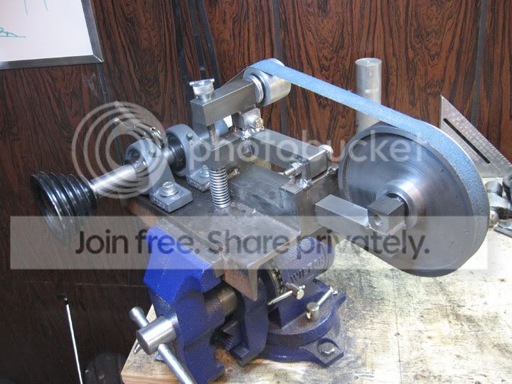

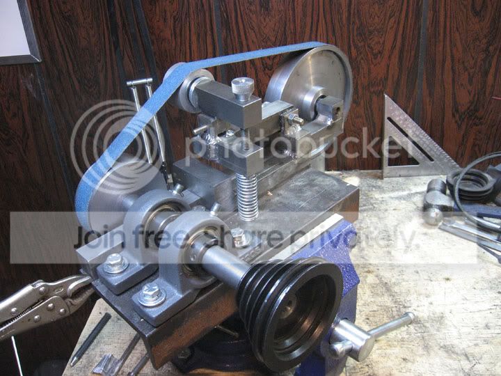

So I have spent a couple afternoon's working on this thing, and it's finaly looking like something. Its a 1x42. will build a flat platen, and figure out something for slack grinding/contouring(probably just a removable platen, and between two small rollers). It's kind of a r+d model, with future hopes to build a 2x72, or maybe something even larger.
Comments, Critiques, Suggestions encouraged, I am a newb at this stuff.
Soft wheels will help you a ton when you get this thing going. Doesn't Bader make some 1" wide rubber clad wheels? would be cool if you could make it somehow Bader wheel compatible.
Preety cool. I agree with Los Angeles about a softer wheel. I think that USA Knifemaker Supply is carrying a couple 1" wide poly wheels now.
Seems like you are only some 2" wheels away from a 2x72. Just extend that tooling arm out and viola!
That's very true
If you want to try it and keep the DIY approach intact, you can find some inner-tubes for tires a bit smaller than your large wheel and cut a few 1 piece bands that will fit snug over your wheel.
Did you cast your own wheel ? I think I see some casting inclusions...?
The locking shaft collars are both on the pulley side, wouldn't you want one on each side to prevent play in both directions ?
Actually it was scrap tubing with a torch cut plate welded into place, I didn't do that great of a job welding it in and there were some inclusions that didn't come out during turning, and I didn't bother to go back and fix em. Locking collars should be a big deal(it's not going anywhere as is I don't think??), but I can flip the one side around, and have them both to the inside, but both outside would interfere with my tooling arm.
