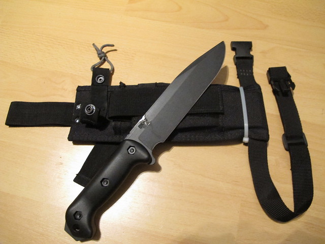

My BK-7 arrived here a few days ago, and of course I almost immediately started thinking about the mods I want to do to this knife.
I like it a lot so far, feels a lot lighter than you would think, but still has enough heft to chop well. Of course, living on 450sq ft in the middle of a large city doesn't give me much opportunities to chop stuff, but I'll have a day off work on Friday, and I AM getting some dirt time, no matter how hard it pours with rain.
I've started with making the sheath somewhat usable, adding a drop leg loop and a leg strap. There's still some finishing work to do, a little bit of clean up, but all in all it's pretty okay (considering it's a stock sheath :D)

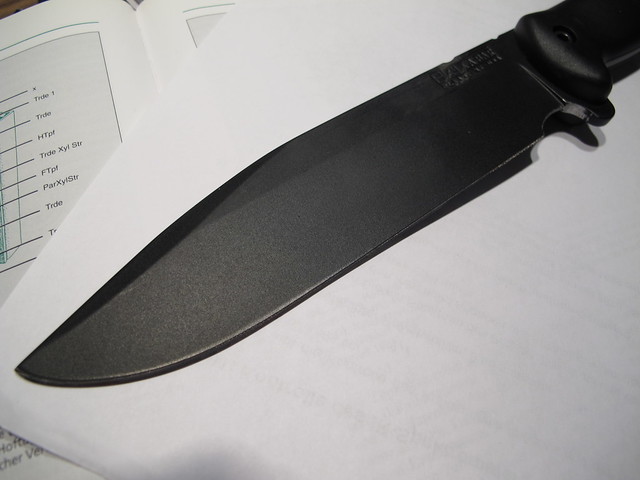

And here's the knife. Drop-pointed, de-ramped, choiled and firesteel-notched.
The blade shape kinda reminds me of the CS Trail Master. weird.

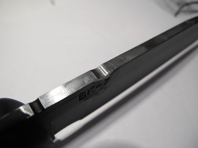

I love the choil, makes it easier for me to choke up on the blade and do finer work. The firesteel notch is something that I first tried on my BK-2 and I've come to like it a lot. It's also super useful for shaving fatwood into tiny little fuzzies.
The next things I want to do:
- remove that piece of metal protruding from the handle just behind the choil. I don't really like the looks of it.
- convex that sucker. Maybe I'll try to Fisk it.
- round off the swedge, so I can grab it to hold the knife like a drawknife.
I'm contemplating stripping it when the coating really wears down some day, and re-coating it with Cerakote, probably a medium gray. Think Navy ship gray. The problem is, Cerakote has to be baked on at 120°C. I know knives are tempered at temperatures above 200°C, but if the tooooj could chime in and tell me it's safe, I'd really appreciate it.

You are way off on your Cerakote bake temp...it needs to cure at 250 for two hours. Fear not as this will not damage the temper on your knife at all. I do it for a living and have done TONS of knives. 250 degrees is nowhere close to ruin a temper.
I think he was talking about centigrade/celsius there, hence the difference.

Every time I see those choils on the 7s and 9s I wonder, Does it dig into your finger while you are choking up on it? Ive never handled a moded one with a choil so I'm curious. Looking good so far man. I'm contemplating taking the ramp off of my 9...........maybe after I finish some other projects.
Looks nice. Do those fire notches really work that good? I'm debating adding one to my modded BK-9.
Awesome stuff meat. What not reshaped handle and wood scales? The bk2 needs a big brother
The fire steel notch works great. Grind it out for the width firesteel you have and when you strike it in the rounded notch there is more surface area being scraped thus more, bigger sparks
Is that Fahrenheit or Celsius? Cerakote Website states 120-150°C.

Great work Meat. I LOVE the choil i put on mine. Makes it 2 knives in one. Does not cut into my finger at all because i softened the edges of the choil with some emery cloth.

I rounded off all the edges near the choil (even the blade edge, to some degree) with a flat jeweler's file. It's very comfortable for a choil that's been cut into the blade.
250°F is exactly 121°C, so we were talking about the same thing, jforbush. Thanks for the input, I'll consider it.
