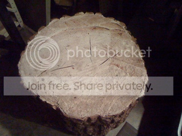

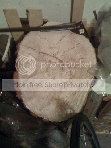

I snagged a couple of tree trunk cut offs and dried them just for this sort of thing. I put house paint on the ends while they were wet and they didn’t even crack open. Seriously; surprised the heck out of me.

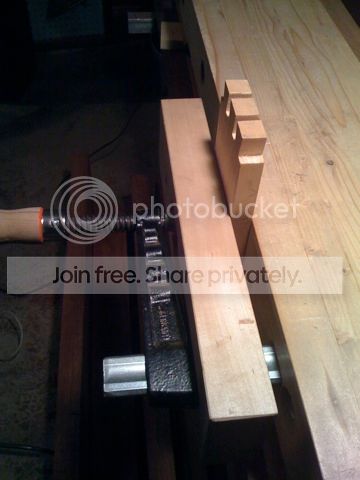

I used that through bolt consturction for my first real wood working bench. No Glue. More of a westernized Japanese planing beam. Used it to make my traditonal Scandinavian cabinet maker’s bench but that’s another story. But yah . . . SOLID bock of wood you have there !

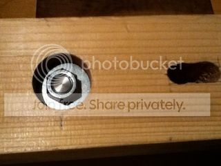

As for the stand I used fir from home depot 4x6. One 12' and one 8'. Had them use their radial arm saw to chop it at 17"+ so it was easier to manage. I setup a fence for them at home depot to make sure they were within tolerance. I had a full wood shop, but I don't keep those tools setup, just the cabinet table saw which I use a lot. Beware though home depot's saw does not cut square. So I went home and trimmed everything on my cabinet saw. Setup some aluminum to make a square fence on my drill press and drilled everything. Saw these large head carriage bolts at OSH and thought they looked cool so used them. Bolted 3 blocks together widest part together and then counter bored and screwed two together with 4" screws, 9 screws per section. Then screwed another section to the two that were already screwed together, etc..., until it was one solid piece.
If you're going to go this route. Plan ahead and order the long bolts online and save some money at OSH they were $8 ea. Then by buying them online and saving money you can use the bolts cross wise as well, just not as long. I noticed after it was together that the 4" screws are strong but shift a little so if your block rocks you can tap on them with a sledge to adjust.
Mine didn't rock, but it did fall as I was screwing it together, boy was I pissed. That's how I realized the side 4" screws shift a little. It doesn't move on it's own and with the anvil on you're good.
Next time I would use 5" 1/4" lag bolts for the cross screwing. I drill pilot holes for my 4" screws so I could take it all apart and just lag bolt it together, but I'll see how it holds up to pounding on it. Plus I need to let it dry out a little so the lags would bite in better.
