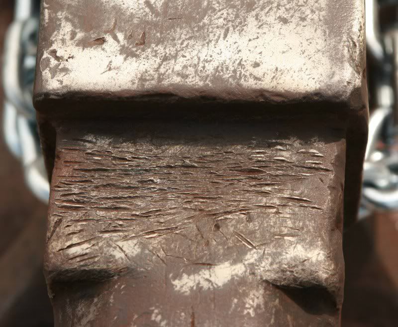

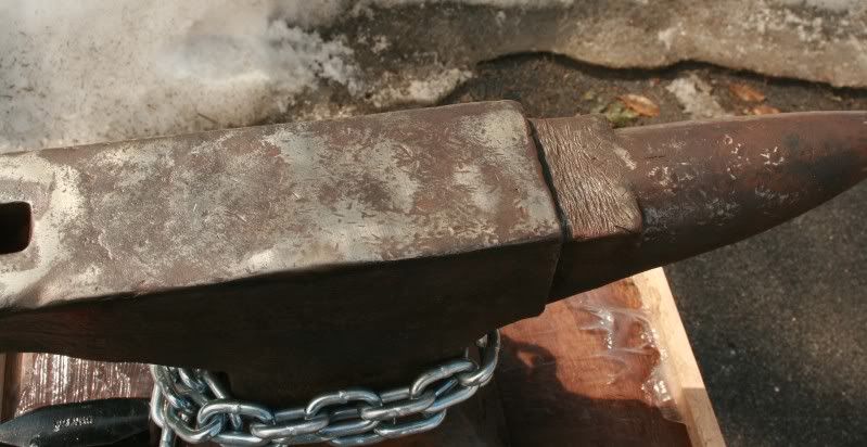

I purchased this anvil locally. Its dimensions are 24x 4.5x11 and weighs 167 pounds. It rings very well and rebound appears good as well (although I have never felt other anvils). I built the stand, added the chain and put some silicone under the anvil to help reduce noise. I also used a sanding block on the face with 150 grit paper for a few strokes and removed some rust with a wire brush on my hand drill. Now for the questions:
Anyone know what the maker may be? There are faint markings on the side but I really cannot make anything out.
Does the face look good enough to forge with or should I try to have it surface ground?
What can I do to make it look cleaner? Continue with wire brush, paint, or any other suggestions.
I can more pics if they would be helpful.
A propane forge will be here Wednesday and I can wait to try this out.
Thanks
John

' don't know who made it.....I would want the face ground though...
as it looks like it may have a little bit of sway...

need a close up of the right side please, It may be a Peter Wright. looks like it has a lot of sway. Definantly get rid of the silicone. decent learning anvil or a decent fixer upper if you want to put a lil $ into it
Jason
Nice anvil, what they said about fixing it up. Looks like the previous owner(s) used the step for hot cutting :( Either get some thick copper/brass for a saddle to hot cut on, make a hardy tool or learn to be careful.

where would I go to have the face cleaned up and by the looks of it what is the ballpark price.
I'd suggest asking at a shop that grinds heads. As for the
cost....? Only the shop could tell you.
Any well set up machine shop should have a table with enough capacity to machine/surface grind that anvil. FYI, when I had my block decked on my old Mustang, I think the cost was around $30-40 per side. That was at an automotive machine shop, so hard to say otherwise.
--nathan
Looks like it's had some repairs already, but I don't think it looks too bad. Why not forge on it for a bit and see how it works for you. My anvil has a bit of sway...I try and use it to my advantage.

It looks like a well use blacksmiths anvil. He cut where he was supposed to. You could take a hand held belt sander and work on the surface yourself, or get it milled at a machine shop. If you do it with the belt sander,start with a 100 grit belt. Use a straight edge to check the sway and dips often. Get it close to flat, and switch to a 220 belt.

I'm with Mace and Stacy. First , try it out and see what you find. Second, You can clean it up yourself. Depending on the maker of the anvil (take a piece of paper and some charcoal and do a rubbing of the markings to get a clearer picture of them) you may have to be concerned about grinding through the top plate of the anvil. If you take it to a shop and say "make it flat" they won't care a whit about flattening through a top plate and leaving you with a wrought iron anvil.

Stacy, I know you cut on the step but I was taught not to cut there without a saddle. Guess I should have been more complete in my answer.
Like others have said, clean it up and use it. I would use a wire wheel on hand held grinder (be sure to match wire wheel with the RPM's of the grider) to clean the rust and build up off. I looks like a Hay Budden to me, from the horn end look on the left side of the foot and you should find the serial number there if a Hay Budden. Good luck, Don

Will, I didn't mean that you were wrong. I was referring to the fact that it hadn't been ruined by a lot of cutting on the face. In my experience, a lot of old anvils had most of the hot cutting done directly on the step. In the modern world, a saddle or some sort of cutting block will make an anvil stay pretty longer, but the old timers probably made twenty to fifty times the number of hot cuts that we do today ( no power bandsaws). I bet they didn't stop to put on the saddle very often.
Stacy
Stacy, no problem. I was just explaining my answer. I have an ugly anvil and don't care to mess up my Sea Robin by hot cutting on the face.
Nick, I saw one of your posts about the silicone so decided to give it a try. It still rings pretty lound, so I hope the neighbors dont complain. If I did have it milled, or ground, how would I know when to stop (or have the machinist stop) before getting to the softer metal?
Thanks
Check and see if there is a visible seam under the face of the anvil. Some anvils were hard-faced with a hardened plate set on a cast iron base. Often times, you can see the junction, maybe more so with a light clean up of the top 2" of the side of the anvil. If I were having it machined, I wouldn't worry about taking all the sway out if there was excessive sway. I would rather flatten as much of the face as possible without having to remove too much material in one spot so you can have a good size work area. It doesn't have to be the entire face. From what I've seen in pictures, I would think the hard plate on top would be on the order of close to an inch thick, but maybe some of the others can give you an idea of how thick it would actually be.
