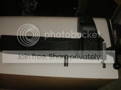

No paint,pick up some Permatex rust treatment at any auto parts store.Knock off the loose rust and wipe on the Permatex.Gives a very nice dark plum/black finish that is very tough and easy to touch up if needed,just wipe some more on.I used it on a vise I rebuilt and liked it so much I used it on a fab table I built.Gave the table top a nice finish and as a bonus I can use it as a chalkboard with a soap stone pen and just wipe it off when i'm done brainstorming
Pic looks very black but in full sun it has a real nice dark plum sheen to it.
