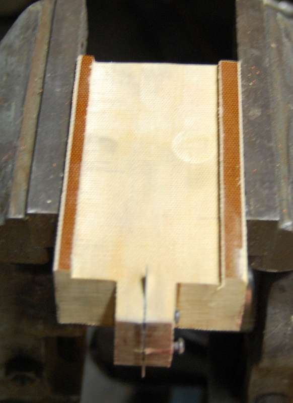

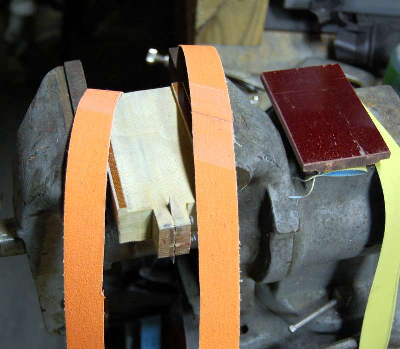

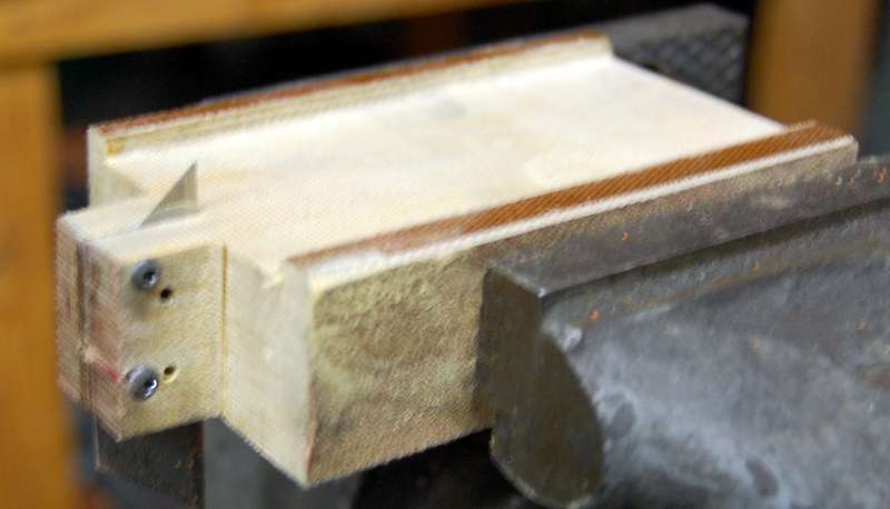

I milled today from micarta I got tired of ripping belts and messing them up. Really was easy to make its funny they charge something like 60 to 70 dollars for one. I will probably make a real blade from some thin stock.
But for now it works like a charm

Yep, that's all you need. Don't bother making your own blade for it-the utility knife blades will do fine. I'd recommend about 1/4" more protrusion-the belt will quickly wear a groove in your blade, and, at the height you have it set, the tip will break.
The top plate is nice, but, you can just use your thumb ;)
