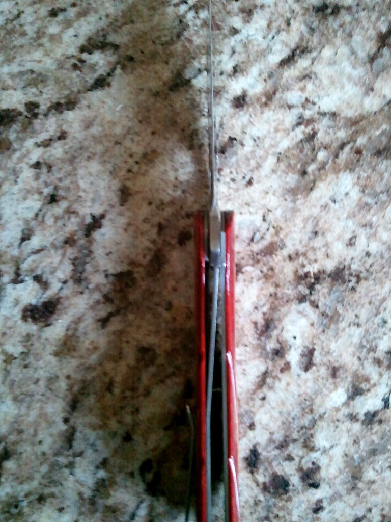

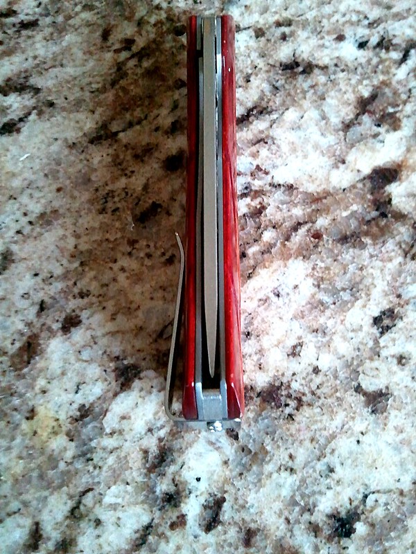

Update
Followed the video to the letter. Sanded the inner edges of both liners to make them nice and smooth, thoroughly cleaned the pivot area (including washers) - it was gritty, lubed and reassembled paying particular attention to the lockup liner side orientation.
WOW! Very smooth flick opening with "only" about 50% lockup (was essentially 100%) and a dead centered blade. Hard to believe the difference.
If you are thinking about doing this, I would recommend it. Take your time. It's not too difficult and the rewards are well worth it.
Pics to follow.
