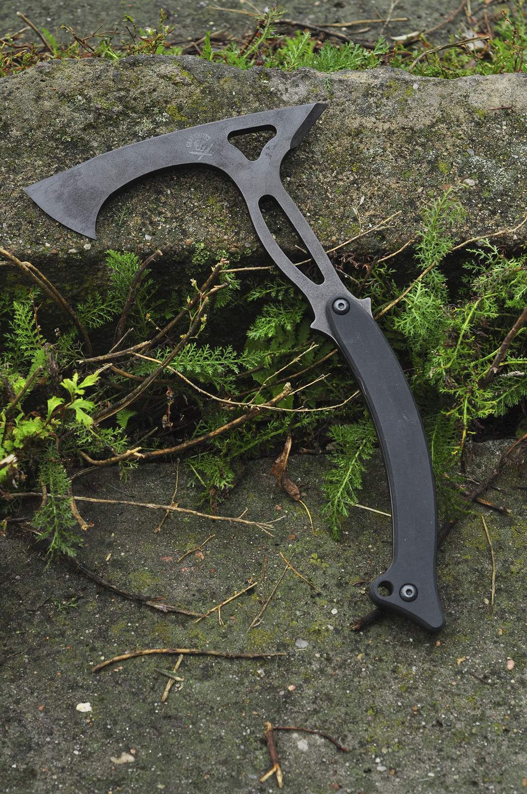

I wanted to show you my new hawk.
Lightweight, hand to hand combat oriented.
8mm thick 4340 steel (like always), about 450grams (1 pound) and 320mm(13 inches) long.
micarta handle slabs over skeletonized tang.
I wanted to make something completely different than anything available.
Short, compact, and with carefully thought-out every angle and line.
and... I've made a have which turned out to be almost identical to Iranian bronze age hawk - like four thousands years old design. This is what I call NEW :D
Anyway.
Hawk is optimized for fighting (based on McLemore "Fighting tomahawk")and works great.
Whether is is cut, chop, jab or rake - there will be excellent cutting power.
Edge geometry causes "guillotine style" effect - deep hit is started on the tip and is continued on very small area each moment.
Car hood, wooden door, zombie skull - penetration up to the handle every time.
Side effect - it is useless for utility work :D Will not chop wood at all.
That deep bit reminds me of a Francisca which is, to me, the most aesthetic axe-like implement ever made. I like how you steered away from the "well beaten path", I rarely take a 2nd look at any tactical tomahawk (anything "tactical" for that matter), but this one is original, so I did :). Guess I like some curves on my blades and less ugly angles :p, and yours fits the bill :). Nice.

For a DUEL - I would choose a long blade, because of agility, dexterity, and a pointy tip, which allows you to keep distance.
But for a combat - where there is no choice of environment, and aim is to quickly overwhelm the enemy - a hawk.

IMHO the short overall length combined with the light head reduces the penetrating force compared to that of the same head on a longer handle.
Very light “battle axe” heads are indeed thousands of years old, but those had longer and straight handles.
The most recent, widespread military use of those in Europe was that of the ‘fokos’, commonly used during the Hungarian uprising lead by Ferenc Rákóczi II in the early 18th century, both by the light cavalry and infantry of the ‘kuruc’ freedom fighters.
Also, I think the curved handle locks the grip in a certain position and the spike is reduced to a slashing implement rather than a penetrating impact point.
Consider the difference between a short vs. longer handled framing hammer.
Did you consider a version with a straight and slightly longer handle (45-50 cm)?. It will be still much shorter than a fokos.
I know nowadays photogenic looks and clever advertising sell more products than functional designs, and most of these “pocket hawks” will be purchased by collectors, but maybe you can offer a straight handled combat version for military personnel too. ;)

Looks like a solid fighting design to me, with some historical precedence. It's actually less funky than the Iranian ax. I am curious how the edge being that far forward will affect how it handles impact, but it gives a looooot of hooking ability to catch and re-direct limbs and necks.
