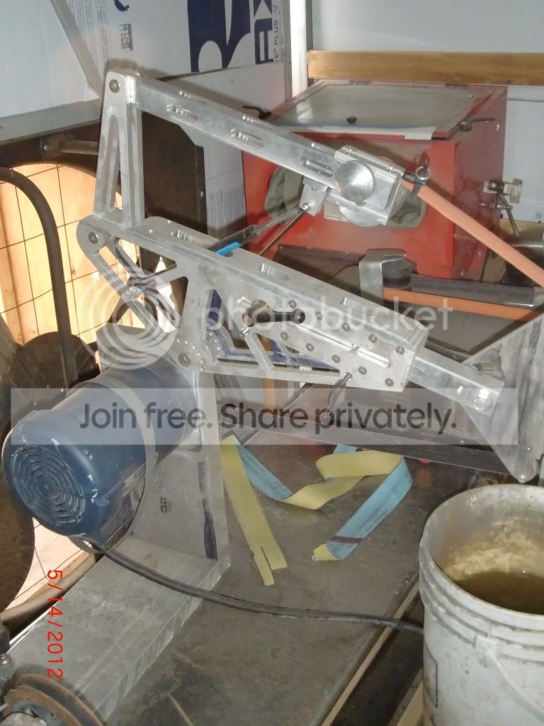

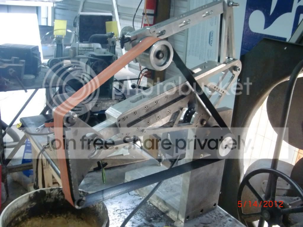

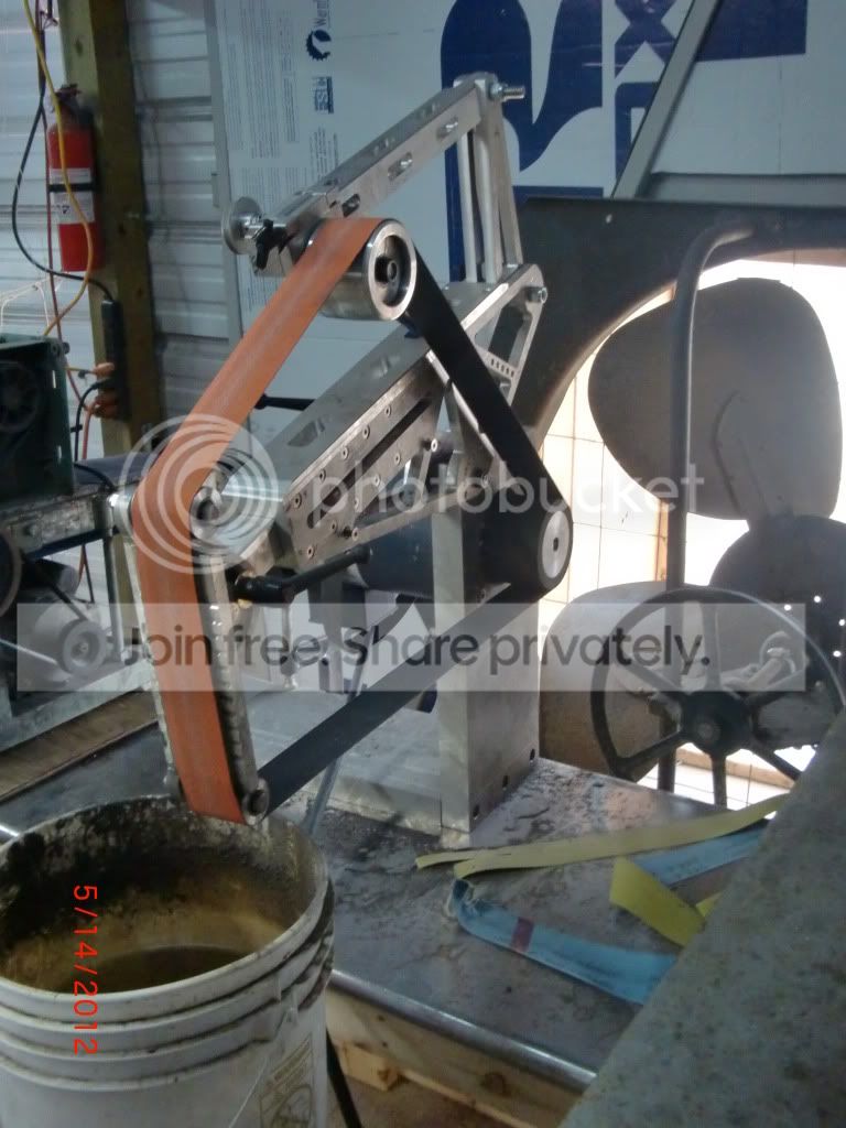

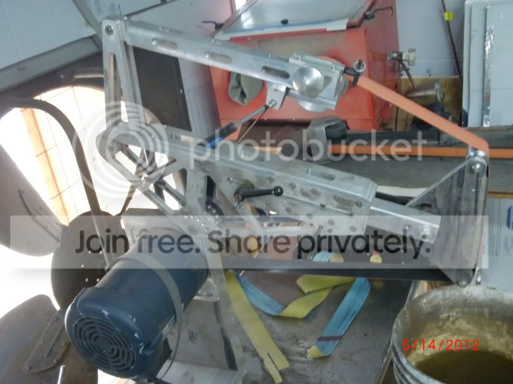

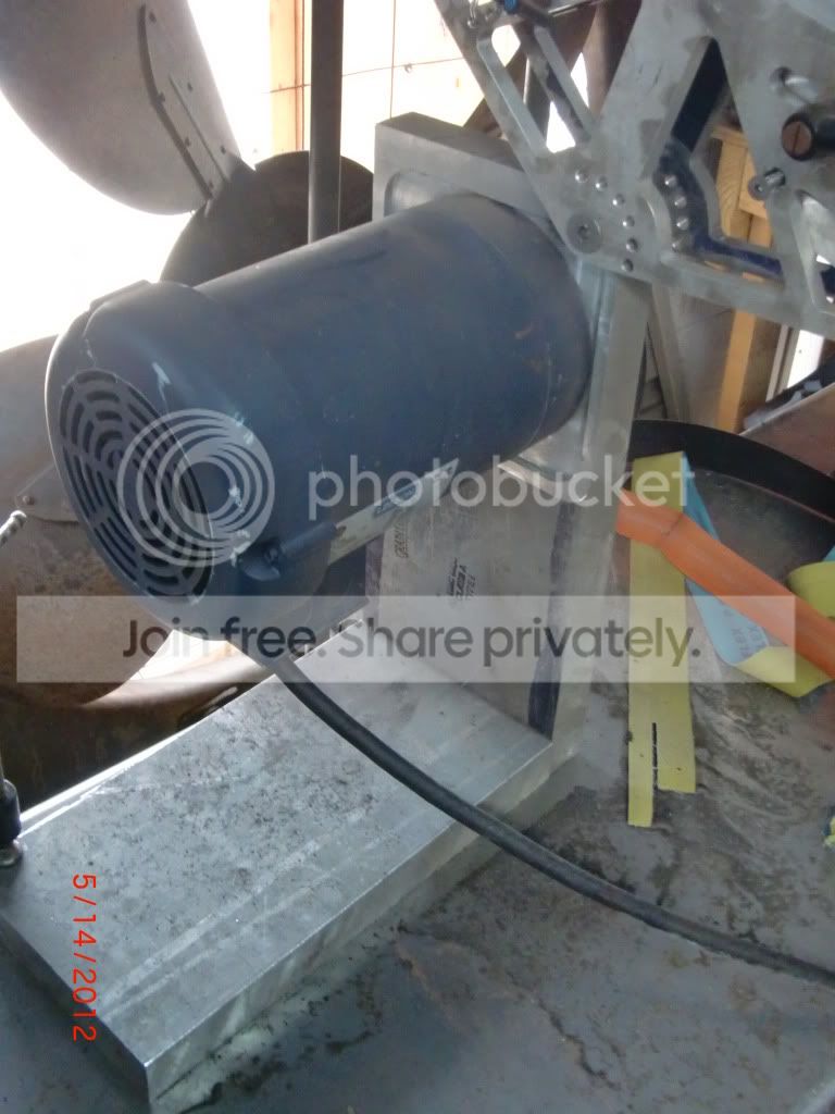

So I got this mostly usable last week and have ground out a couple knives with it. I have been making knives for at least 8-10 years and have never even ground a knife on a 2x72:eyeburn: I have been using a trusty old HF 6x48 for the last 6 years. surprisingly waiting for it to die, it never has?
I talked to Mick and read some of Brian's posts and decided I would build something to suit me.
I have prob 100 some odd hours into it, some good some bad:) its not perfect by any means but it works well and eats steel like nobody business!
Specs:
3HP 3PH VFD controlled lesson motor
.5" 6061 alum frame
1.5" 6061 tool arms
all stainless hardware
1.5" home made idler wheels

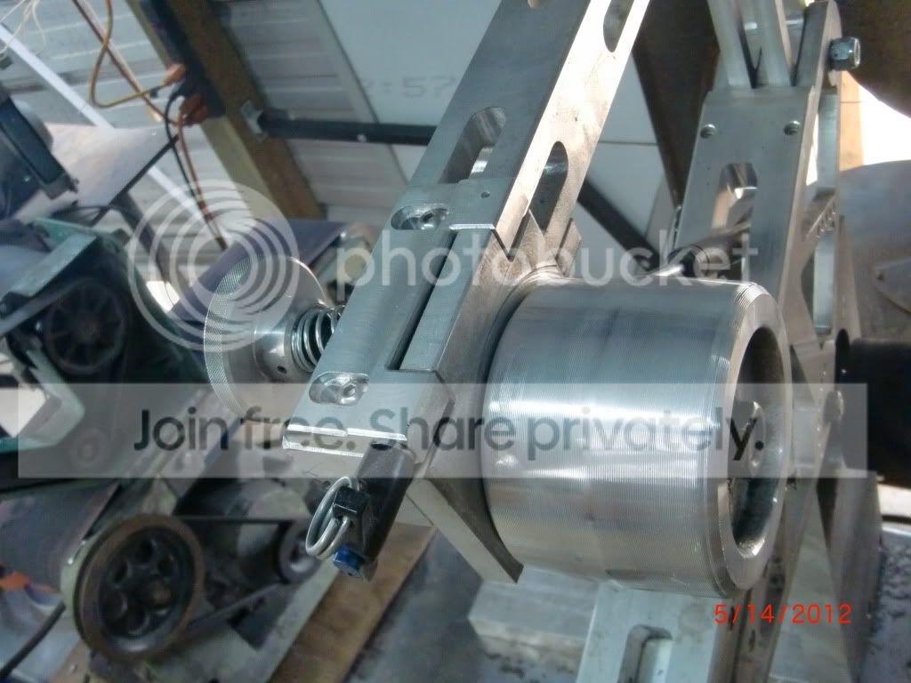

Beaumont tracking wheel
Beaumont 4" rubber drive wheel
.250" full hard 3V platen
Gas strut
I made this grinder completely in house and it is adjustable all the way out to a 180" belt length. I'm still doing some testing and waiting for a 3/4" 6061 bar to come in so I can finish the tool rest.
Not one tool is required to make any adjustment:eeek:
I'll do a vid soon if any body cares.
If you want any info on it or measurements let me know.

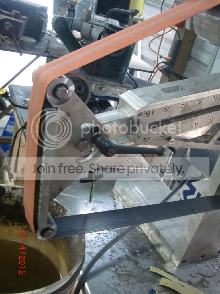

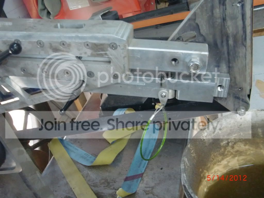

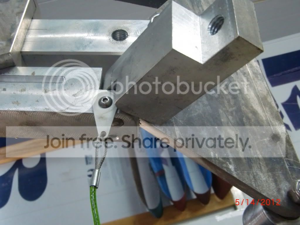

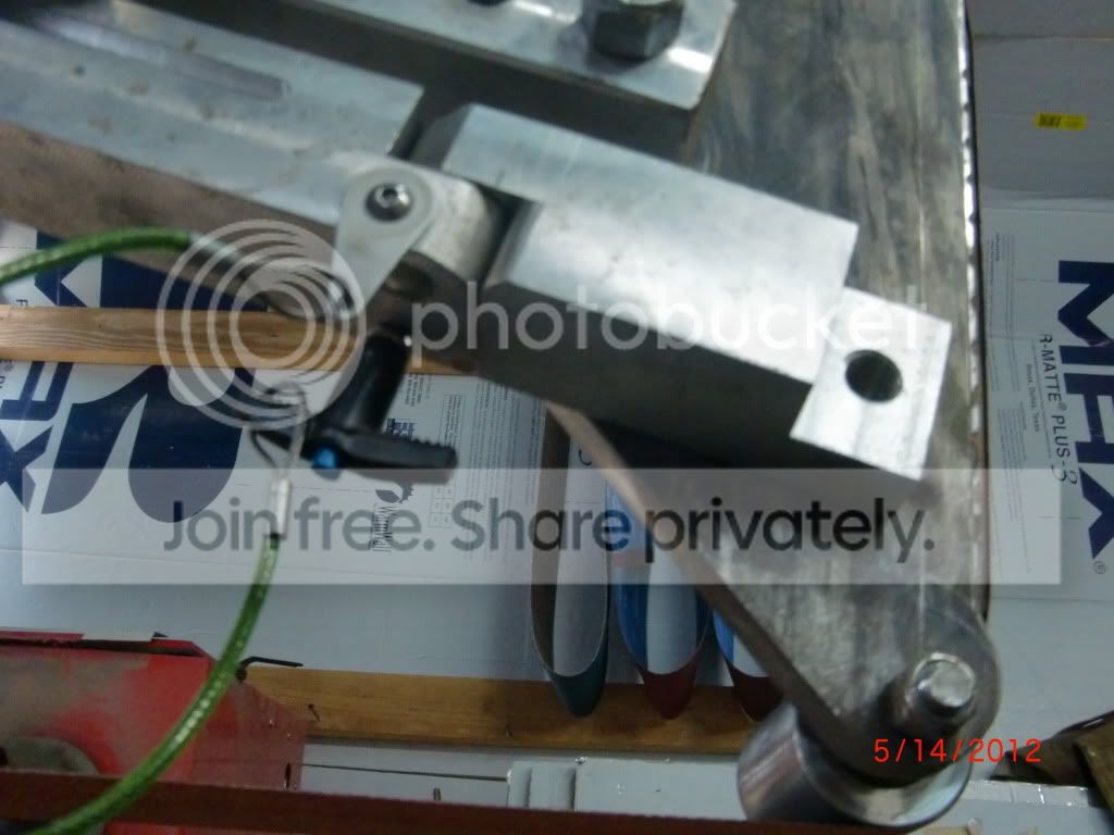

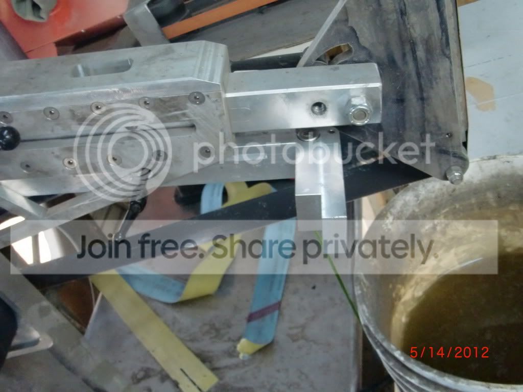

I messed up when I designed it and didnt give my self enough space under the main tool are for a second 1.5" opening for a tool rest. so I improvised and slot milled a bar and added some pins to the frame for it to rid on and a lever to lock it down.
I made to tool arm with an extra hing so that I could swing it out of the way when no in use for when changing belts:)
