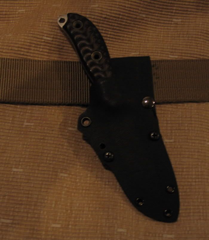

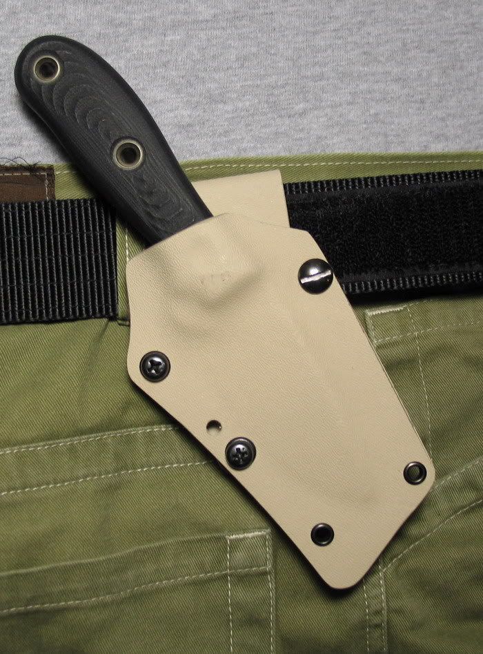

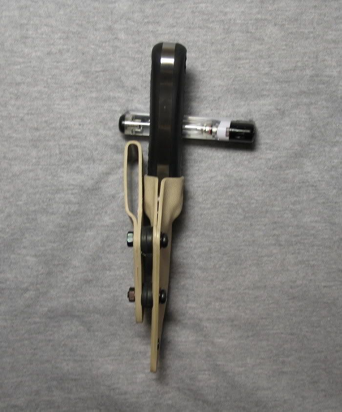

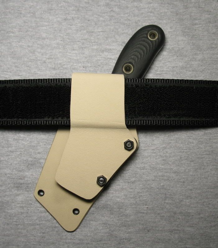

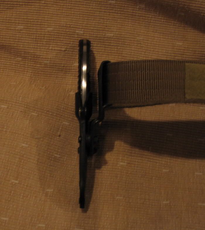

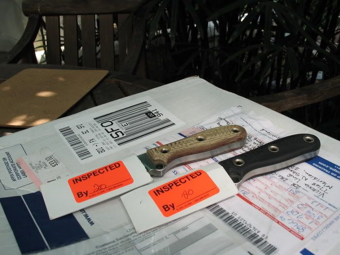

As it is always be problems for knives that weight balance is on the handle side and I always have problems to carry them Tip Down which is the most decure to medthod to hve knives on the belt and go to the forrest.
This how I try to develop them.

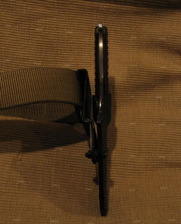

I put 1 Chicago Screw on so that I can adjust how tight the sheath will hold the knife and I adjust it base on where I go, for example I go to the forest and I need more secure for my knife then I tighten it more.

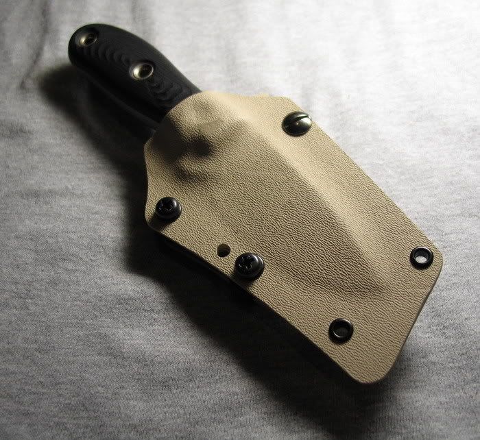

and this one

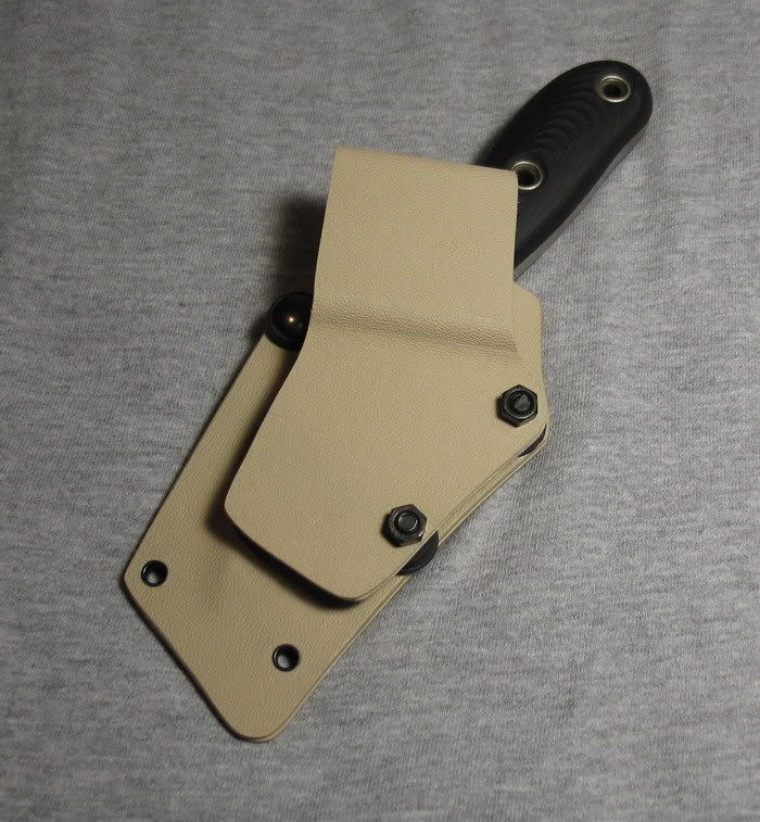

Nice kydex work Dick. I really like the ability to adjust the tension with the Chicago screw. Keep 'em coming.
Nice work man. I see you are a Wilderness fan as am I. How do you finish the edges of the Kydex? I usually hit mine up with 220 grit which seems to work well. I like your belt loop. It took me a while to come up with a basic belt loop that was relatively easy to bang out and also worked well.

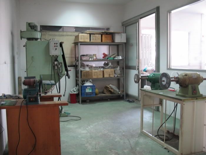

See my workshop.
I use mostly Buffing Wheel but I have to be very carefull not to press too hard against the sheath and the edge to be finisshed must go vertical to the wheel. It save a lot of time.

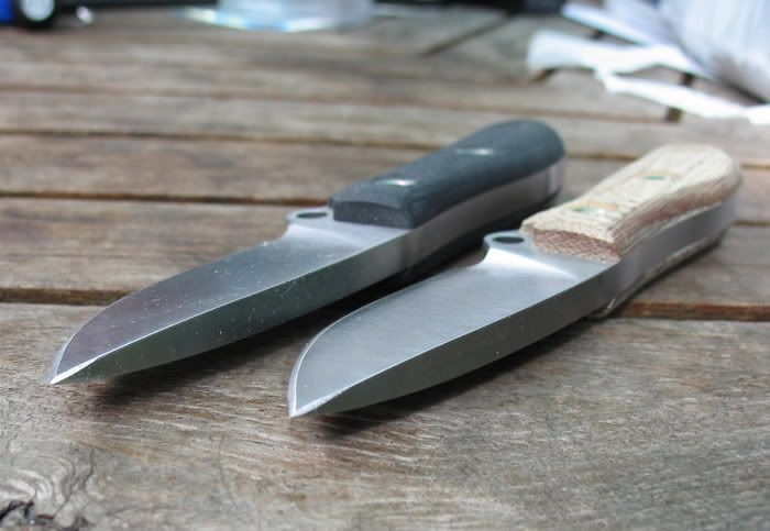

Dick - what model of knife are those in your first post?
thx - cpr
Sorry to resurrect an old thread here -
thx - cpr
orca - Those are the new 0.27" Busse Game Wardens that were recently available at the BCS...
the tan is micarta, the black is G-10. Both are satin. :thumbup:
