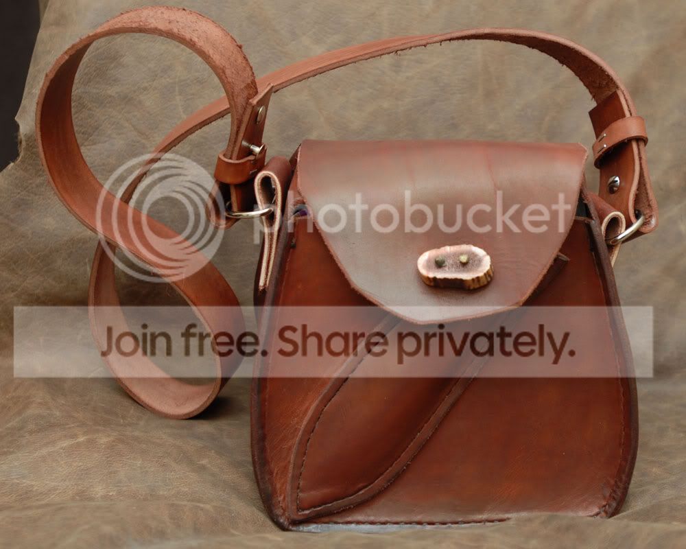

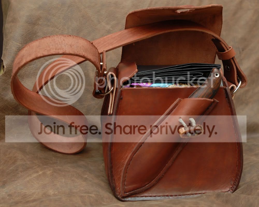

I have been wanting to make myself a Leather possibles bag for a while now. I had a Sunday to myself and decided to make one up. It was MUCH MORE work than I thought it would be.
I had never seen anyone build a sheath into their bag so I thought what the hell. Some things didn't work out as well as I would have liked. The flap could be a bit longer, but I am still going to take it out and use the crap out of it.
Specs:
Bottom: 7.5" Wide
Top: 6.5" Wide
Height: 7.5" Tall
Thickness (Side): 7" at base 5" at top
Questions, Comments, Constructive Criticism Welcome...
That is VERY cool! Nice work, and great idea building the sheath like that.
Wow.... :)
IIRC Nessmuk sewed his sheath in to his bag but I like the design of yours a lot. Very cool.
nice work! ...but I think they are called a "possibles" bag - not a "possibilities" bag.
Did you sew a welt into the sheath?
What oz. leather did you use, and how did you stitch it (machine or by hand)?

I stand corrected... Possibles Bag! I will change the title as to not look like a doofus! (Too late for that I am afraid)
Yes there is a Welt in the sheath
7-8 Oz. leather
Hand stiched
I like the attached sheath as well- very nice! :)
what are you plans for bits stored in the bag?
Very nice!
When I made mine for my first rendezvous I put the sheath like yours but on the back of the bag. I also sewed a antler button to the flap and had a piece of rawhide cord from inside the bag through a hole in the bottom. You just put the flap down and wound the cord around the button for a secure fit. You then don't have to worry about the flap hole getting bigger etc.
But once again very nice bag, you are a craftsman.
