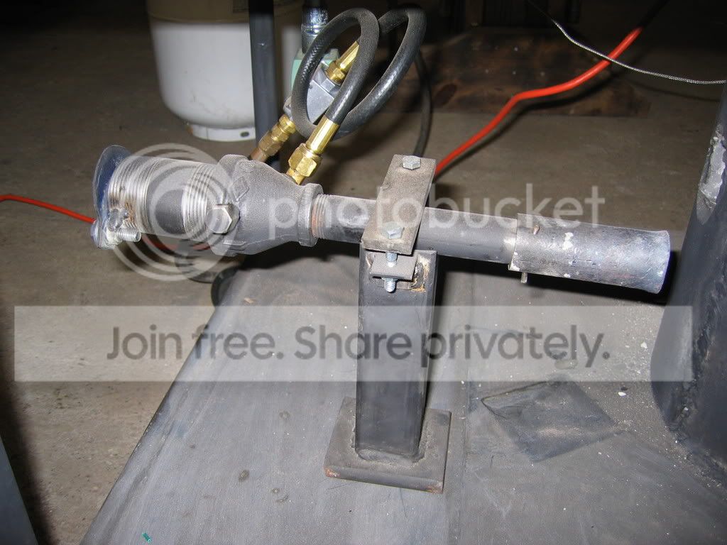

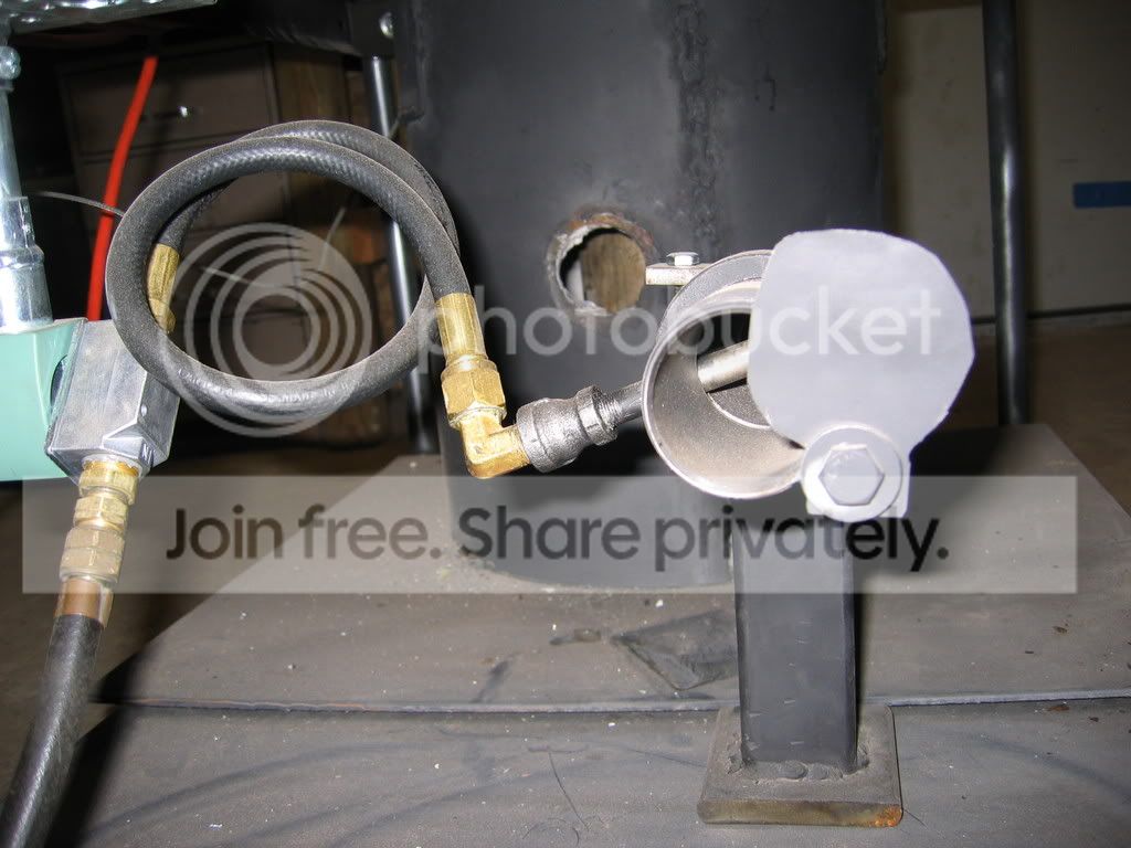

Here are a couple shots of the burner. Its a venturie burner that's very similar to the one found here: http://metalcast.boorman.us/reil_1.html The only thing I added was the flap at the back which gives it much more control.
You can see the solenoid valve in the right side of this picture. Like I said I found this on eBay after about a week. It's made by Asco and cost about $20 with shipping. Its important to get a valve that is normally closed meaning that when there is no power running to it the valve remains closed.

Nice job! My only question is where is your exhaust chimney? Typically it is handled by a vent port in your lid with a metal box or tube welded on to direct the heat away from you.

I actually built that today. I drilled a hole in the top with a hole saw and welded a piece of pipe facing towards the back at an angle. Can anyone with experience working with these explain what the proper way to initially fill them is? Should I put in a little salt at a time or just dump it all in to the level I want and fire it up?
Fill it up 7/8 of the way. Bring it up to melt, top it off until it is the desired fullness. leave some room at the top (3" or so).
