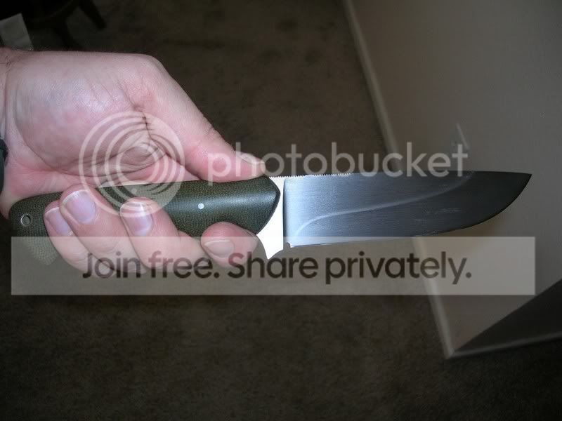

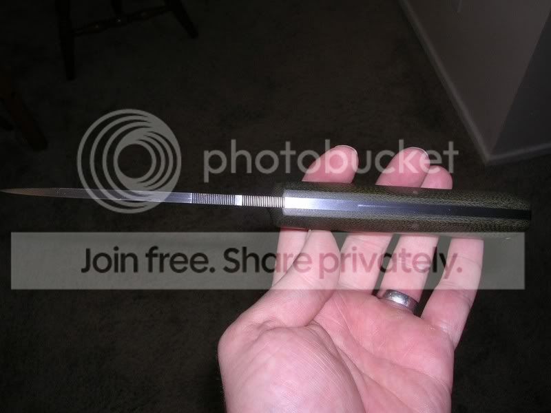

I won't be able to help unless you post pics of that beast.
Tknifes pics are clearer and show more detail than mine. Hope you don't mind Tknife. So for the record, these are Tknifes pictures but the knifes are almost identical. I have a 4 inch with black linen micarta.
