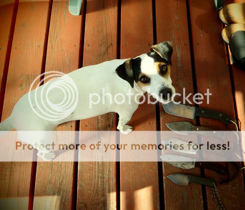

A knife that I really do like is my Dave Farmer Camp knife, an awesome blade that is very sharp, holds a great edge but is also easy to touch up. This one loses points for me though with the handle being a tad too thin and the blade to handle transition being too shallow which causes me to fear my hand sliding down the blade. This has never happened though so maybe my worries are unfounded !
My 6 month design is very closely modeled on the Farmer knife.
My Booshway was the blade that really sold me on the wide blades, this is still probably my favourite all round knife but at 3/16" stock is a little excessive for food prep etc.
And finally the last knife that influenced my 6 month knife is my little ML Survivalist. I love this knife, for it's size I don't think it could be any better, pretty perfect. I incorporated the handle blade transition of the ML into the 6 month knife, having a right angle like that gives me far more confidence.
Snicker approves of these knives as well !

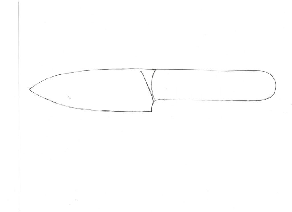

This was my first drawing I sent to Bryan Breeden~
And my second with the blade/handle transition changed~
Looks like you could cut your finger where the guard would be

Nah, check out the small ML, I push my hand up to the blade as hard as it will go and it's fine, very safe !;)
I like the handle profile on that one. I'm amazed at how many knives have brick shaped handles. Even from custom makers.
Hey Pit you ever think about going with thinner stock? I have a couple of trams and was thinking about cutting one down and trying 1/16" thick. I think with a wide blade it could be doable.
Yeah a lot of makers produce some awesome knives only to go and ruin them with skinny uncomfortable handles !!!
Never gone as thin as 1/16" but pretty sure it would cut like the devil and stand up fine for most tasks !

I like the design but notice there is no countour like a "palm swell" have you found straight handles to be much more versatile? I am a fan of drop edge spearpoints as well.
Bill
Bill
No palm swell just a super basic hand filling oval profile !
