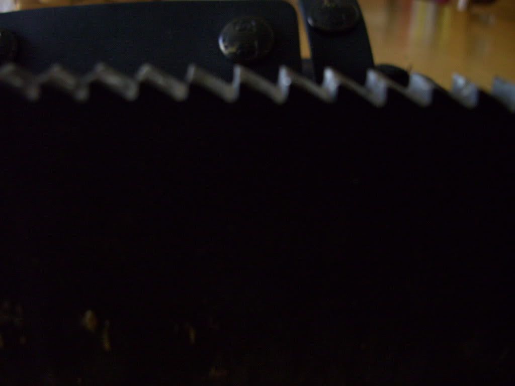

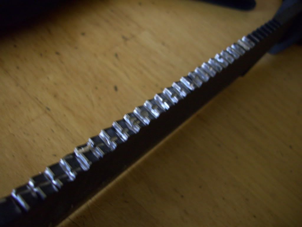

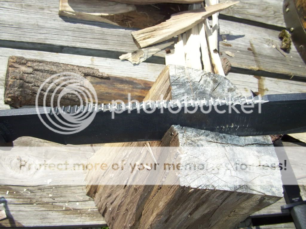

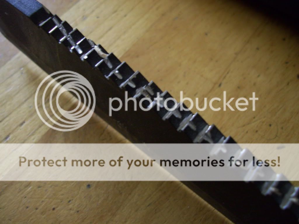

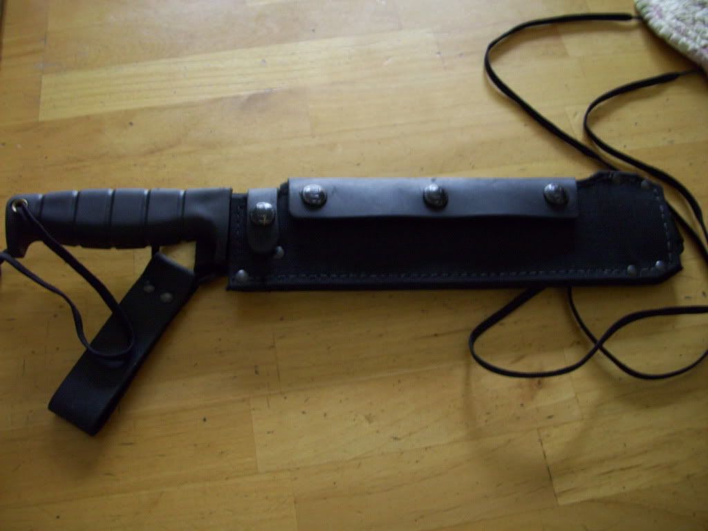

I too own an SP-8. If you are a DIY'er, then you will LOVE it. I say that because of the saw back. From the factory, IT SUCKS. It is NOT a 2 row saw. Mine now cuts like bastid, thanks to some modification with my dremel tool. I used the cut-off wheel. First i sharpened the tips of the saw on both sides, then i used it to make irregular angled grooves across the teeth. It now saws like nobody's business & does not clog up. I left about an inch of the sawback untouched because i like to rest my thumb on it when i choke up on it. My SP-8 is scary sharp the entire length. You can use it like a chisel too, because of the flat end (which is also razor sharp.) I LOVE it now. I hate things that don't work properly. When they don't, i fix em so they do. The sheath is awesome too IMHO, for a stock sheath. It has the most important feature for actually working with it & using it---a drop leg swivel set-up. Once you tie it around your leg, you can bend, squat, work, get into or out of vehicles/atv's/horses etc... without issue because it moves with you, not against you. It is a 1/4" thick & made in America. VERY HIGH "bang for the bucks."
EVERY thread needs pichers !!! LOL :D

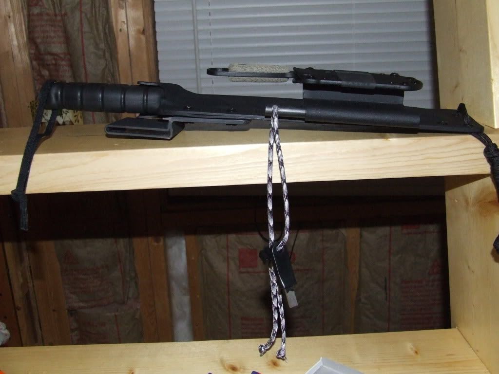

Thank you, and here we go.......
that band at the top makes a world of difference in the handle feel
