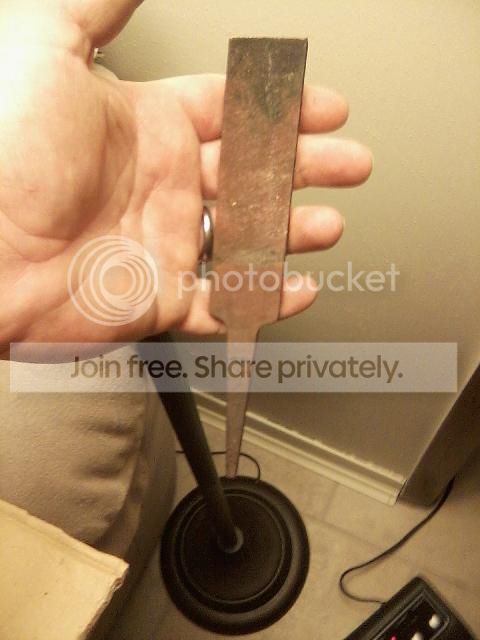

Well, went to the swap meet at lunch time. I found one good file to practice on for $1.64 with tax. Lucky for me a 10ft round Oak Tree fell apart at work and the rest of it still hasn't been scavenged by some of the people at the unit. Came home, made a fire. Force air with the exhaust side of my small shop vac. Voila! Nice orange file. It's cooling off in a nice pile of sand. The cut and grind start tomorrow. I hope I did all of that right. :o
Crossing my fingers hoping it's a good enough steel to take and keep an edge. We shall see. If nothing else, I have a cheap piece of steel to practice on rather than waste the O1 blank I have that's on it's way.

Now, as to when I annealed the file, I did not end up getting the spike/handle portion of the file orange/red. Is that going to be an issue?
OK, so I just went back to my file. I got myself into trouble. I buried it in some sand to cool down slowly. Well, unbeknownst to me. It started to rain while I sat in here. The file warped. Luckily, it only warped in one direction so it has a slight u shape to it. Fortunately, it's given me enough workable material that is flat. I'll lose half the file but that's why I bought a $1.50 file, something to learn on. Hopefully it cooled correctly and did not harden in the moist sand. :barf:
The Tang of a file is never hardened so there should be no need to anneal that portion. You can probably straighten your file cold since it is softened now, as long as you normalize before heat treating. Or make like a blacksmith and heat up your file again to straighten it. No need to cut it in half.
Depending on how large of a warp it is, you could run it for a temper cycle then bend it back to shape.
if it's literally a "U" shape, then you can either forge it back to shape, or grind it in half.

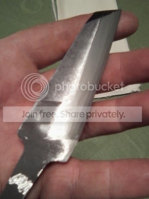

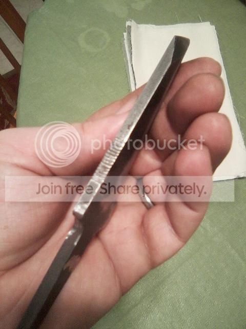

OK, I was fortunate enough to have a portion to work with right away. I will run a temper cycle to straighten the other half of the file. I wanted two sections anyhow. I have not cut more than I needed to so there is hope after all. I'll get pics up soon.
ETA: The warp is only about 1/4 of an inch end to end. I should be able to bend it back easily.
ETA 2: PICS

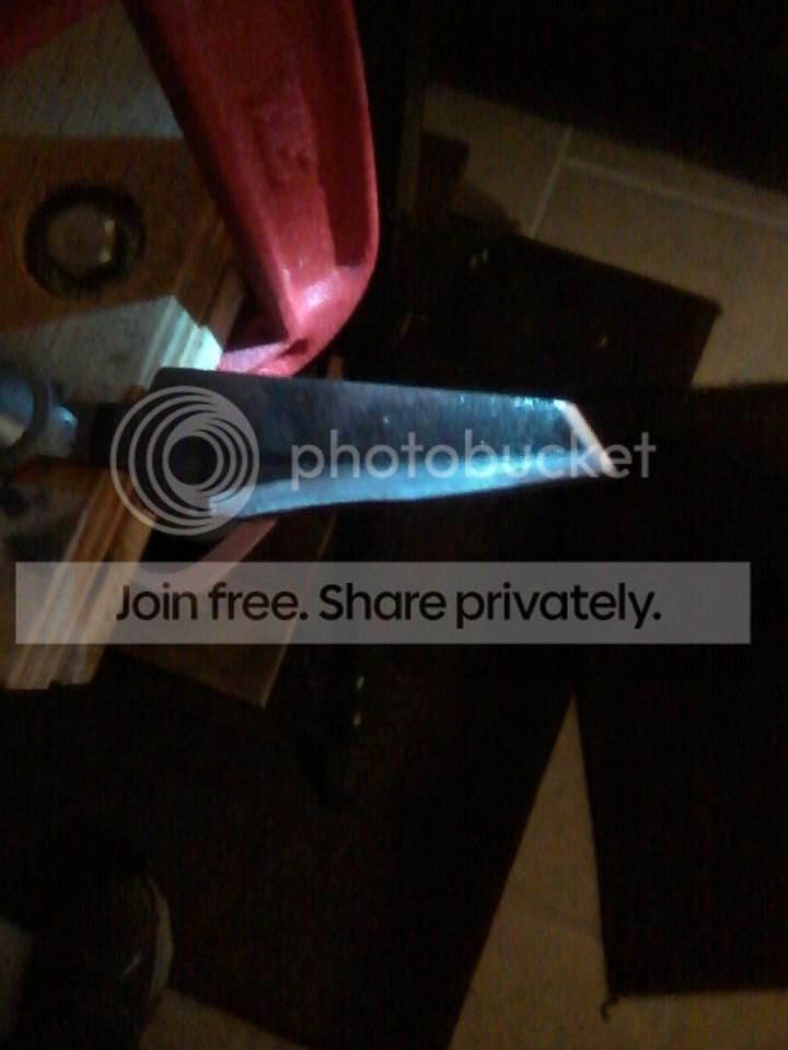

Gettin' there! Man, I need some cutting oil. That poor mini hack saw.
First Cut!
Please excuse the mess.
