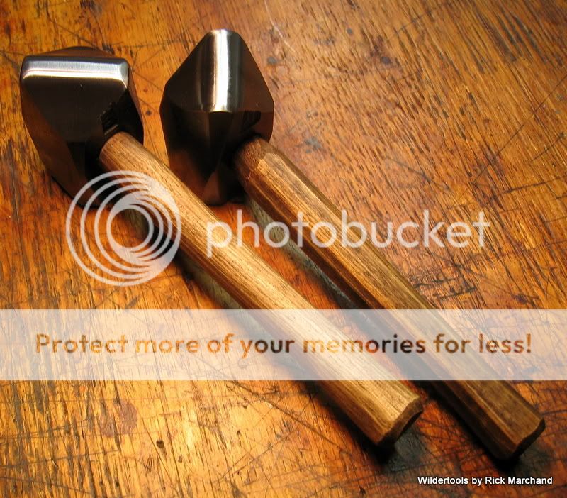

I have pretty much given up on a Sammer... I think he believes I should make my own or something but there is no way I'm drifting a hammer head by hand, so today I bought a couple of 4lb club hammers to experiment with.
This is what they started out as... I emailed the manufacturer (Garant) and they told me that the hammers are drop forged 1060.

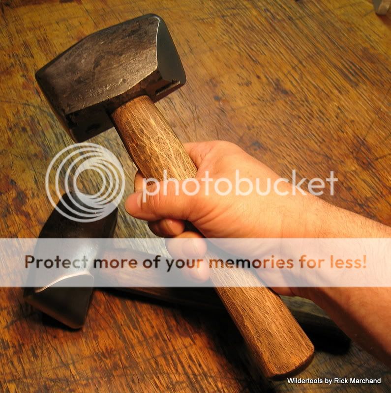

I removed the handles, redressed the faces and ground diagonal peens into them. Then I normalized and re-HT'd them, drawing back to a spring temper. One is 3.75lbs and the other is 3lbs. I was smacking some mild steel around today and really like the feel. I suggest you try the Hofi method.

Rick, what's with the diagonal peen face?
I'd expect a vertical or horizontal. does the diagonal offer a better angle relative to how things are naturally held with your tong-hand?

I have a diagonal peen hammer from Ed Caffrey, and it works great. With a vertical peen, you have to adjust your hold of your stock to make it 90 degrees to the face of the peen when using it to draw out the stock lengthwise. When using an angled peen, it puts your hand in a much more natural position relative to each other and helps maintain better body mechanics for certain drawing tasks.

The peen on a forging hammer is usually vertical or horizontal because it is designed for blacksmiths. They normally move softer metal either longer or wider, but rarely are making complex tapers on hardenable steel like we do with knives. The diagonal peen makes moving blade steel far more comfortable and controllable.

I first saw the diagonal peen on Ed Caffrey's table at Blade 2years ago. I thought it was a great idea. I am always contorting myself to fuller and the diagonal just makes sense. After making these guys, I now have a right hand, left hand, cross and straight. That should cover all the angles... badum-bum.
The bonus with the compact Hofi-concept is that you can angle the head and peen with the edge of the face. The hammers are almost square so a slight angle doesn't pose the same problems an elongated head would. It is just a different way.
Grinding was easy with a fresh 36grit blaze belt.

Are the eyes in those 2 hammers different sizes ?
you have lots of taper down to the eye on one, but not on the other.

Yes... my local hardware store only had one club hammer in stock, so I grabbed another the next town over. The eyes are different sizes and I didn't notice until I had them both together. I made them both from an old sledge handle. They are 9" long from the head. I need to shape the bigger one to a bit more of an octagonal feel... it helps to index the face while hammering.

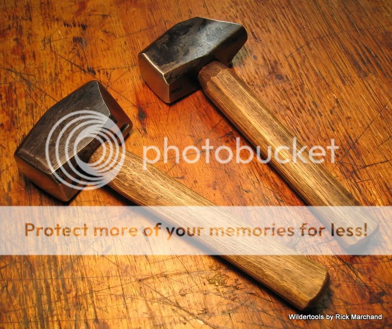

Rick, How long did it take you to grind away all that steel? Is there a small hamon on that one on the left. If you polish that up to 1500 grit and etch in vinegar, you might be able to really make that pop.
That's an illusion, Matthew. There is a bevel there... you can see it in the last two pics.
It really didn't take long. After I cut off and punched out the original handles, I was ready for HT in less than a half hour.
