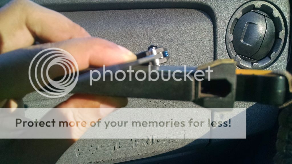

One thing to add to the technique, put a piece of tape around your finger. For protection and helps the thumb slide better.
Friend don't let friends sharpen away thumbs or let them get them sticky from tape :P
They suggest using the thumbstuds first;)
