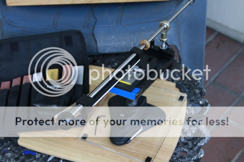

The base is simply molded plastic, and as you can see the obvious problem in the picture… I could not tighten the base enough to keep it from slipping. So, I had to fix it… a small piece of a non-slip pad inserted in the base of the pivot seemed to do the trick. (The suction base OTOH, did a remarkable job of holding on a variety of surfaces).

Yeah... can't argue that. Although, I'm not entirely sure I like the replacement you used for the pivot... it would seem to introduce a 'side to side' difference since the pivot is no longer centered in relationship to the blade table. Do you have to adjust for this? (Seems it would be more of a difference than the difference in the pivot design you've noted before in the original Apex).
I did note that most of the "looseness" in the generic pivot is where it attaches to the rod. I put a washer and drill stop collar underneath it, and eliminated the looseness almost entirely...
... not the most elegant solution, but one I had readily available. (The washer allows the pivot to rotate freely).

No, it does not introduce a side-to-side difference because as long as the pivot is anywhere on the line that is parallel to the edge of the knife (pivot base line, the whole line is one side of the triangle), the angle does not change so side-to-side movement makes no difference. With EP on the other hand, the pivot rotates around the pole moving the pivot base line closer or further to the knife edge.

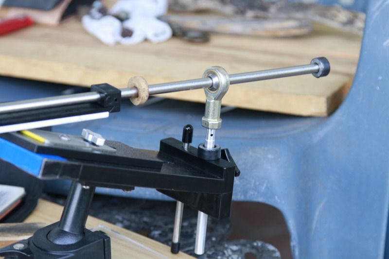

Hello here is my upgrades of Ruixin Pro Angle Knife Sharpener II upgrade, improvement, fix
Today i sharpened kitchen knife Tescoma azza on Ruixin Pro mod.

Quick bump on this thread because I've just splashed out on one of these. Going to use it for resetting bevels, and for some other stuff. I fully expect to make modifications, I only consider the original parts as a starting point.
I've ditched the ball joint and suction mount, too wobbly in my opinion. My bench doesn't have a smooth enough surface for the sucker to work anyway. So I've replaced that rig with a wooden base that fixes the table at 15 degrees. Progress so far ...
Still to come, the rose joint conversion for the swivel as shown by previous poster. Some sort of repeatable stops for the height adjuster - still turning over ideas for that. Stops for the sliding rod, at the moment I'm thinking bits of fuel pipe retained by pipe clips to give "soft" end stops. Need to source a short bit of 8mm rod for the riser, something not too hard for me to cut the thread.
