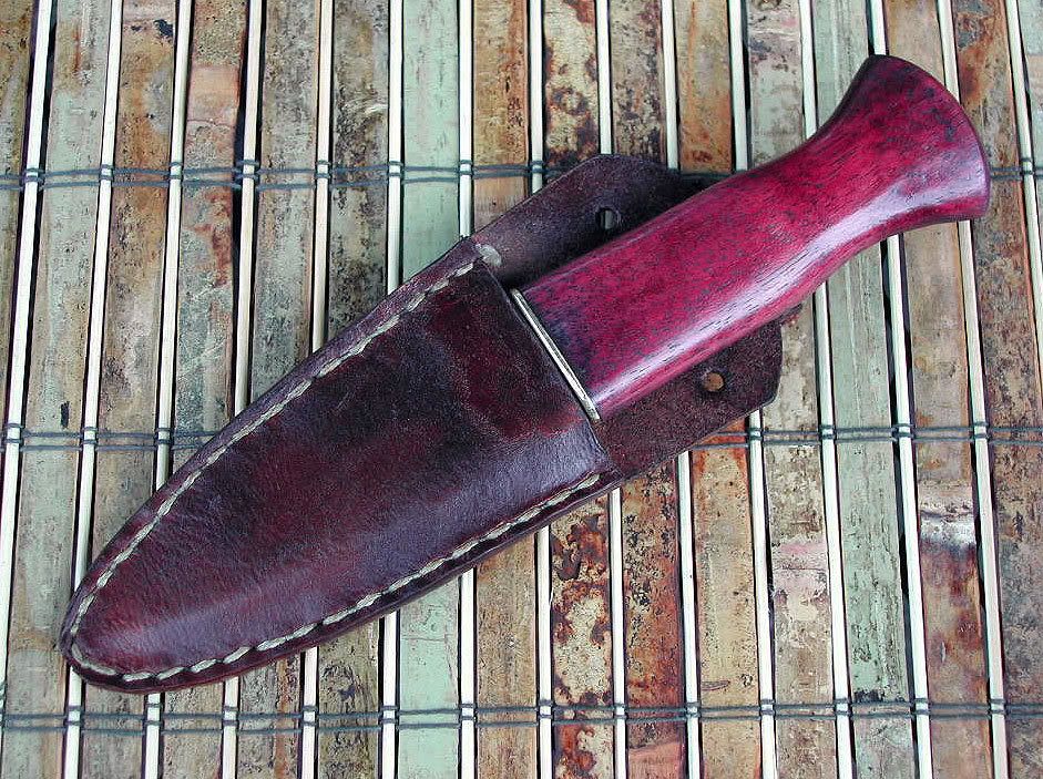

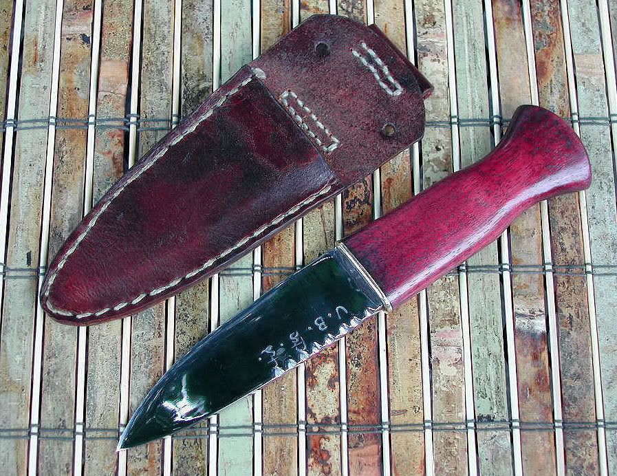

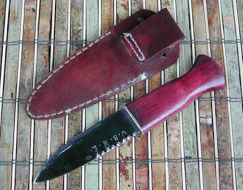

When I saw the purpleheart handled SG on 7/30, I felt it was meant to be mine. When it came I wasn't disappointed. The wood was beautiful, and the blade was well made, and sharp. The makers mark is a flower (Dil?).
The knife really didn't need any work, but I fine sanded the handle and buffed it, then put 3 coats of wipe-on poly on it. While I usually use Tru-oil, I didn't want to darken the beautiful color of the wood, and poly is more clear.
The simple sheath was well made, and punched to be used as a dangler type sheath. I like a dangler on my puukos, and JKM's, but with this wide flat blade, it seemed likely that I might cut the sheath when putting the knife back in. So I ventured into my first leather work and sewed on a belt loop. The sheath was then dipped into melted beeswax to darken, protect, and harden it.
Thanks Yangdu and Dil for a wonderful blade. It's going to work with me tomorrow!

I'm not a leather guy, but I've heard them talking about dipping the sheaths in a mixture of beeswax and mink oil or neatsfoot. I only had the beeswax.:o It makes the leather really firm, almost hard. For this particular sheath, that was what I wanted. I normally use Pecards Antique leather dressing. Hmm, maybe I should have put some of that in the beeswax.

Not knowing any better, I've melted canning parafin (from preserves given me) and saturated sheaths with it. Then pressure formed to fit the knife involved. Stiffens the leather nicely, and darkens it a bit.
Often, I'll coat with clear outside to keep the parafin from melting on clothes,

I have a question about these small bushcraft type knives, though. For swords, it's not suggested that one keep the blade in a leather sheath lest it rust, however there I notice lot of leather sheathes being used for knives like these for oudoor use. Is there anything done to the leather to prevent rust on the blade or do these knives require a lot of maintenance because of the corrosive properties of the leather sheathes?

I wouldn't store a carbon steel knife in a leather sheath for long periods of time. For example, I don't keep my Steve Voorhis custom carbon steel knife in it's sheath. But for a using knife that's going to be in and out, cutting stuff, and wiped down with oil occasionally, it doesn't seem to be a problem.

Pardon my ignorance,but, is the blade, (as it appears to be) double edged?
