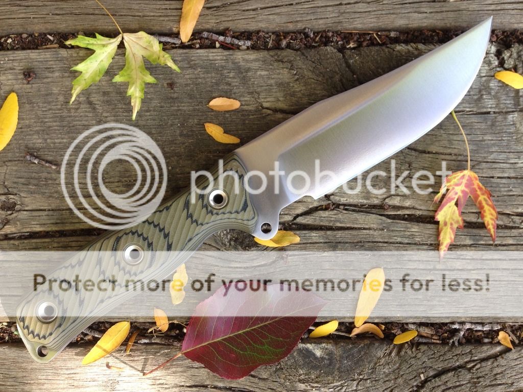

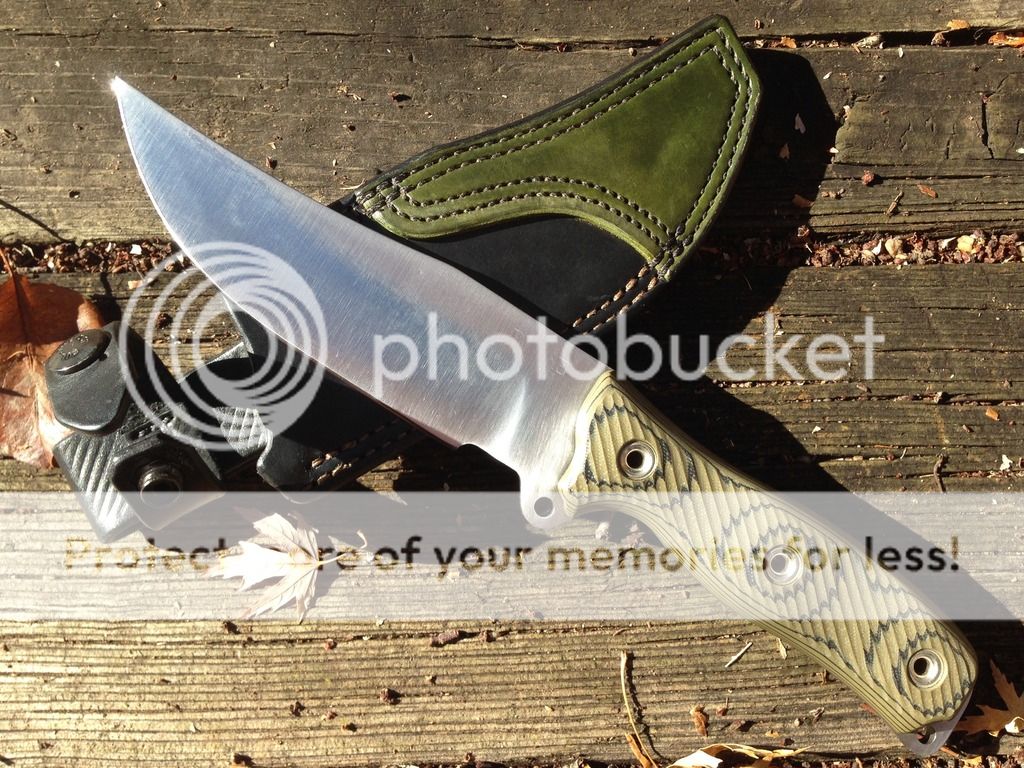

Thanks everyone! I think it turned out great, and I really like the satin finish on this blade! I already like this knife more than the RMD, and that IS saying something! :eek:
Very nice. What sort of belt grinder are you using?
Just the ole Harbor Freight 1x30, but it requires a little bit of help to get going with these belts. Of note, every Schotchbrite belt I've ever gotten has been pretty tight on the grinder, and required some pre-stretching and softening. I do this by wrapping it around the crank handle on my vice, and then really leaning into it and working it back and forth around the small-diameter (~1/2") steel rod. The coarse belt I got in this shipment was by far the worst.

That looks great! I love that color combo with the satin.

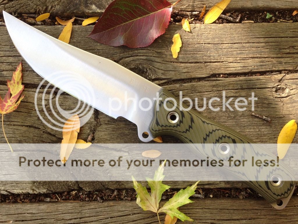

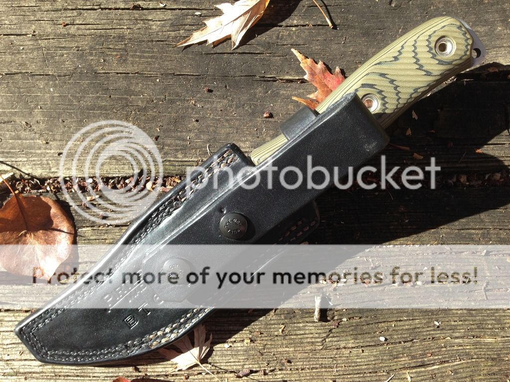

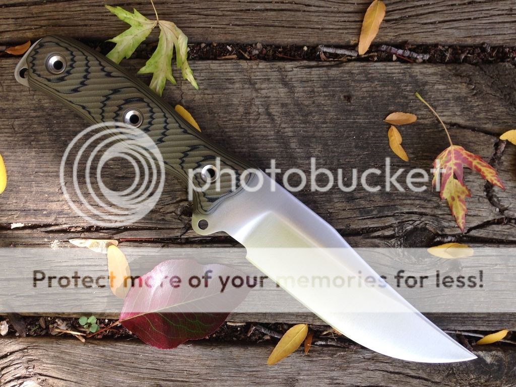

So I got some better pics today. I cleaned up the ricasso/talon hole areas a bit better, and it looks good now. You can't see it in the picture very well, but I've already gotten hairline scratches going lengthwise down the blade from insertion/removal from the cardboard sheath. :rolleyes: No biggie, as this is going to be a user, but sometimes it amazes me how easily a really nice satin finish can get scratched up. Oh well.

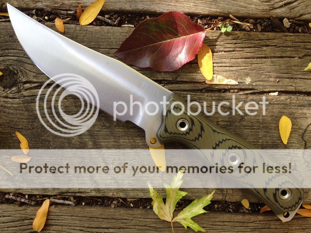

More Pics!!! These show the blade pretty well from some different angles, and turned out a lot better than yesterday's did IMO.

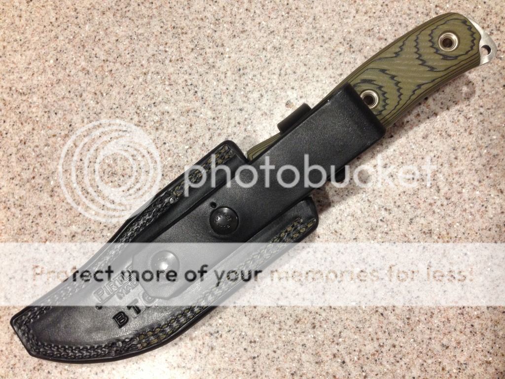

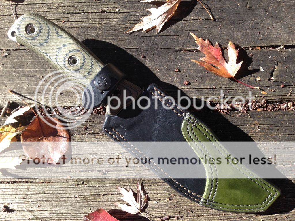

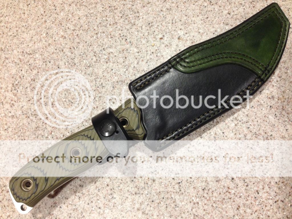

Putting my Pirtle sheath pics here. Thought I had already. :foot:

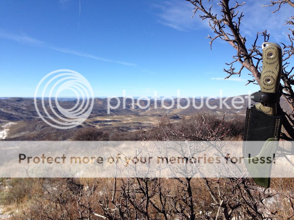

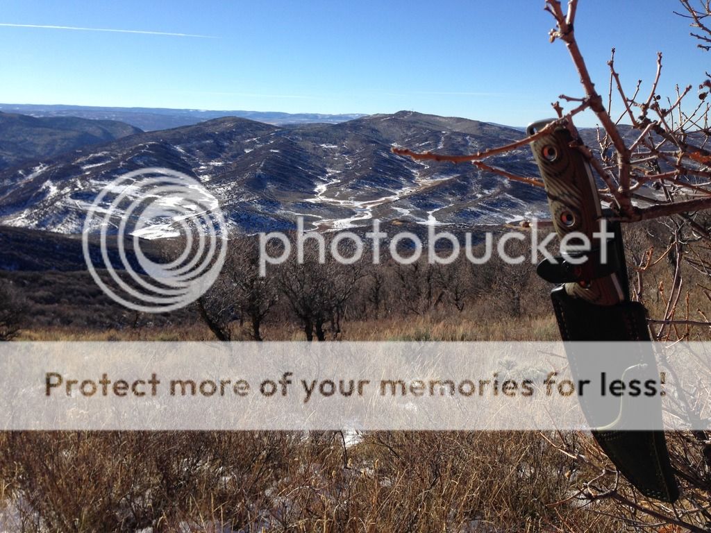

Took the BT6 Elk hunting last November...
I was quite happy with the BT6 as a hunting knife! :cool: :thumbup: Nice fine, thin tip, but still a hefty blade when needed. Unfortunately, it didn't get to do any butchering, maybe next year. :( :grumpy:

Wow, that green and black G10 looks very classy against the satin, and the Pirtle sheath dresses it up perfectly without getting gaudy. Really nice work and a beautiful result all around--truly a one-of-a-kind treasure.

Both knife and sheath look amazing! I guess I'll be looking into Pirtle sheaths next time I'm in the market for some leather!

Thanks! Everything about this package turned out just about perfect, and it is destined to ride on my belt for many hunts to come! :D I don't recall if I measured it after cleaning her up, so I just did. ;) 0.204" - 0.205" thick on the flats.
BTW, the knife rode out that snowstorm on my belt, and not a hint of rust later that evening, even at the pommel end where I didn't clean up the INFI dimples quite as much. Was glad to see that wasn't going to be an issue. :cool:
Polished INFI is almost patina-proof in my experience, as long as the decarb layer is cleaned away. Thanks for the measurement--what a great blade. :thumbup:
