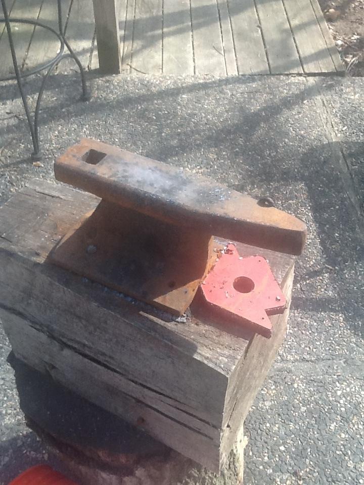

Im using a ebay 2 burner gas forge and forging in the orange range (when inside the forge) im forging in sunlight so its very difficult to tell where I am as it will go to orange to dull cherry once it hits the light.
Im also using a poorly setup raiload anvil that im more than sure is not level and it might have lost its HT. I know what its like to work on a real anvil (i am part of my local blacksmith guild) and its much better but i dont have the money for a real anvil.

Orange is too low. You should be forging in the yellow range and stop at red-orange. 2100F down to 1600F. A few Templi-stix would be a good investment. They are only a few bucks each. 1200, 1400, 1600, 2000 will do a lot toward keeping steel in the ranges you want. It will also teach you to know what that temp looks like colorwise.
A RR anvil will work OK, but lacks in mass a bit. Make sure it is firmly attached to a large base.

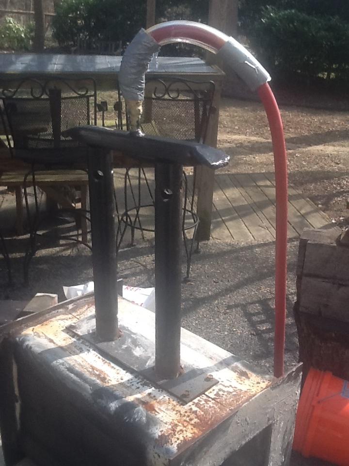

also the forge i have wont get much hotter than orange , i applied itc 100 and everything but it still wont get that high. Have no idea how to fix it.
Post some photos of the forge, the regulator and valves, and the tank you use. If you have an ebay link to the forge maker, that will help, too. Lets see if we can tweak it to run right. I have a lot of parts that may help.
If you are using a BBQ regulator and hose, I know what the problem is.

Here is my setup

While those types are not the best forge design, the forge should run plenty hot enough. It should run at pressures from 3-5PSI where it will got around 1500-1600, to 15PSI, where you can get near welding heat. Crank up the pressure and see what it does.
If it won't run any hotter, something is wrong with the manifold.
i had that ebay forge for a while and it will get hot enough if you crank it up and cover the front or back openings with ceramic wool or I even used fire brick. I eventually got rid of it and got a better designed forge.
Do you think its the forge thats bad or the burners? because the burners screw on and i can make my own , would that be a better option?
arent venturi burners adjustable ?
