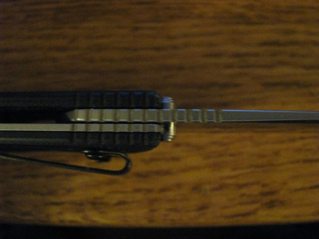

I just pimped a Spyderco Byrd Crow, and I have a Raven on the bench to do a similar mod to.
Replaced the black g-10 with pink. Added a lanyard tube as these come with only a hole (Raven will have this flared to fit better), tapped the liners for 4-40 clip screws as these are NOT tapped for the clip screws (?). Did have some problems with the LAST screw that kinda ruined the project. But, I am doing something different for the Raven. Pink, lanyard tube, and tapped liners, but something different for scale attachment.
pesky screw

great work !!! could you tell me where I can get the T-9 screws to fit my spydercos or what thread size they are so I can find them? Do you have any scales for a manix laying around?
I am assuming that because the standard Torx size for #2-56 screws is a T6, that if you go with these as replacements you need to increase your counter bore diameter/depth. Is that correct? That is a small thing, but it makes a big difference to me. The fact that the Sage's and the Chokwe have all T8 screws is a big plus to me. It looks better, and T6 just feels ready to be stripped, where T8's feel much much more solid, and I bet T9 feels better too.
I think that if you are talking about not drilling the scale holes, but just replacement, you may get by with the flat head T-8 without drilling (or counter-boring for the larger head). The flat head would torque in as the head is wedge shaped.
Opening the screw hole would be necessary for the button head MAYBE, depending on how much of an opening is on the stock scale.
I have some knives that have the counter bore a tad wider than the T-6, and the T-8 or T-9 works OK, just have to carefully tighten it down.
The biggest worry is the length of the screw. I cut one down (on an 8" sanding disk) until it seats tight, then mic it and then cut down the rest to match. you have to be careful not to make it so long as to bottom out before it is tight, or not leave room for two screws to fit, if it's screwed in that way.
And yes, the T-8 and T-9, although the same thread size, will not strip out the head as easy as a T-6. I ALWAYS upgrade the screws if they are T-6.
Same with the clip screws.
Another thing to think about is the pivot screw.
The odds are slim to none that it is a T-6. Mostly T-8 or T-9. Try to get the same T size (pivot) for the replacement scale screws so you only need one size driver to take the knife, apart.
Hope that helps.
