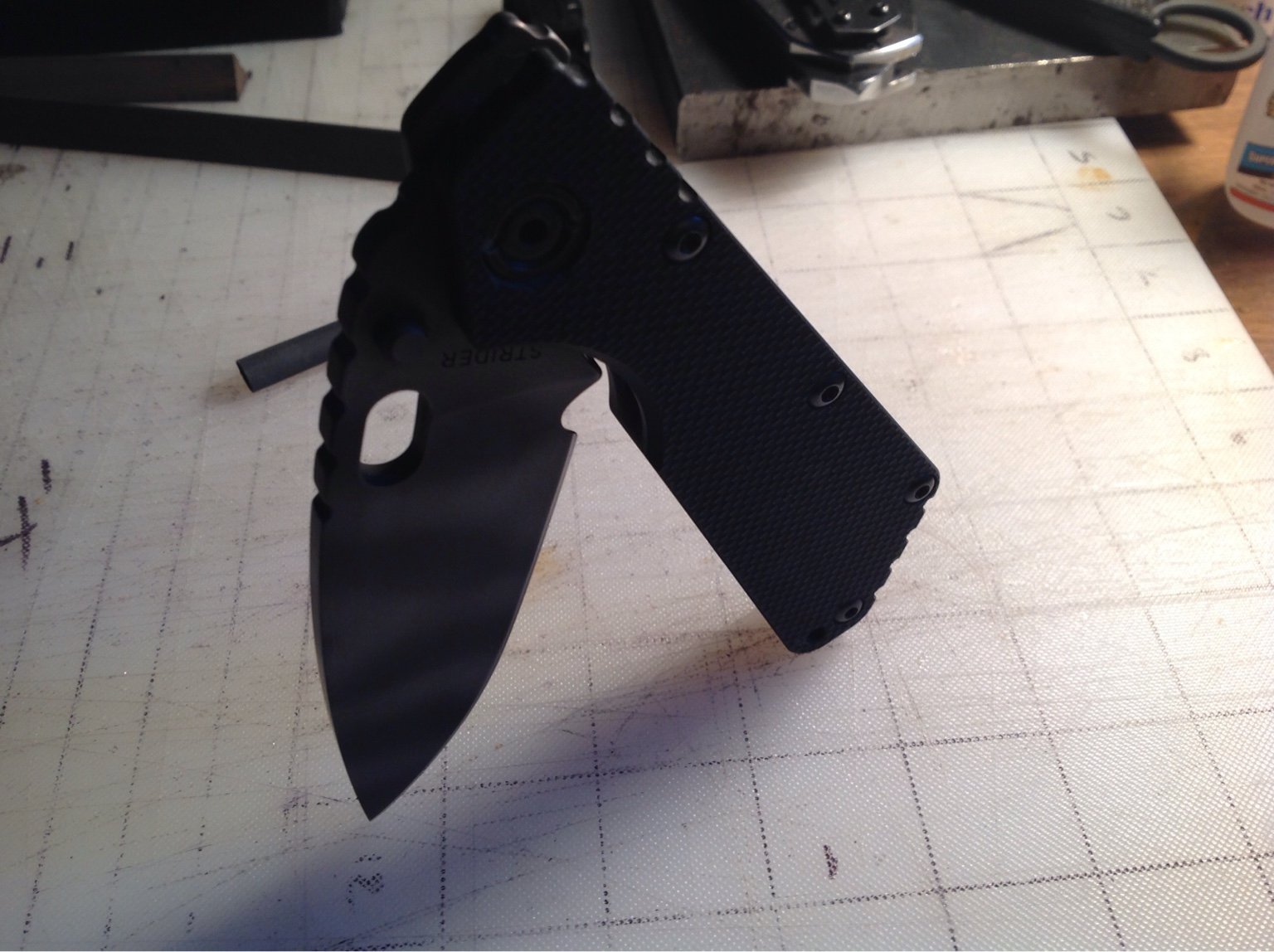

I love the Strider but the lock-rock and late lock-up bothered me. Here's my fix.

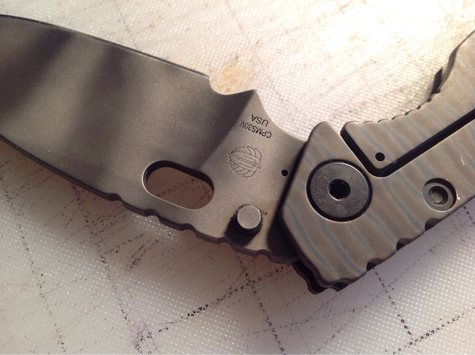

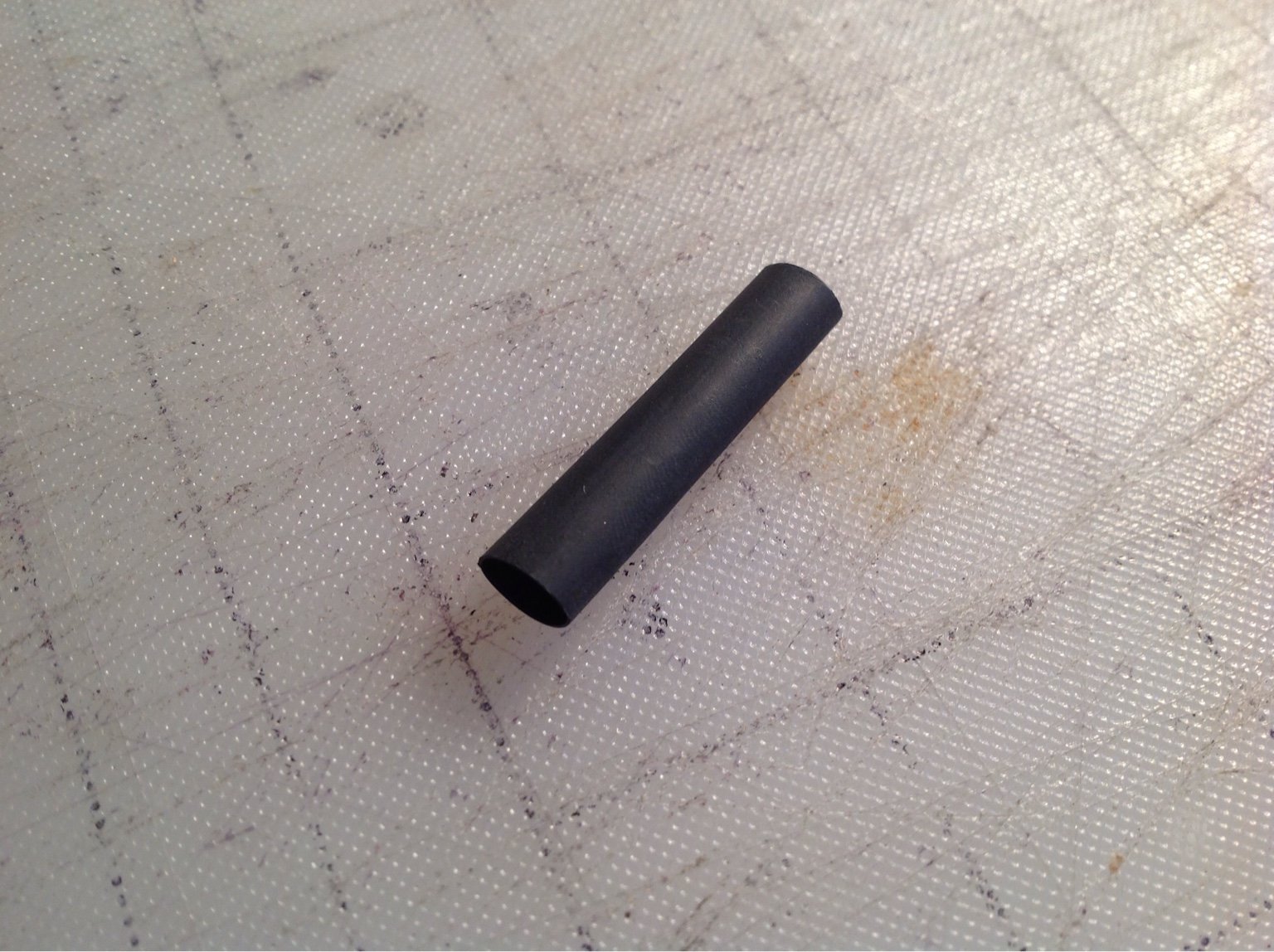

1) Locate a piece of electrical shrink tubing. Closest to diameter of stop pin the better. This was a bit large and still worked great.
2) Cut it to just less than the height of the stop pin.
3) Place on stop pin and apply heat. It will shrink to fit perfectly!
4) Do the other side.

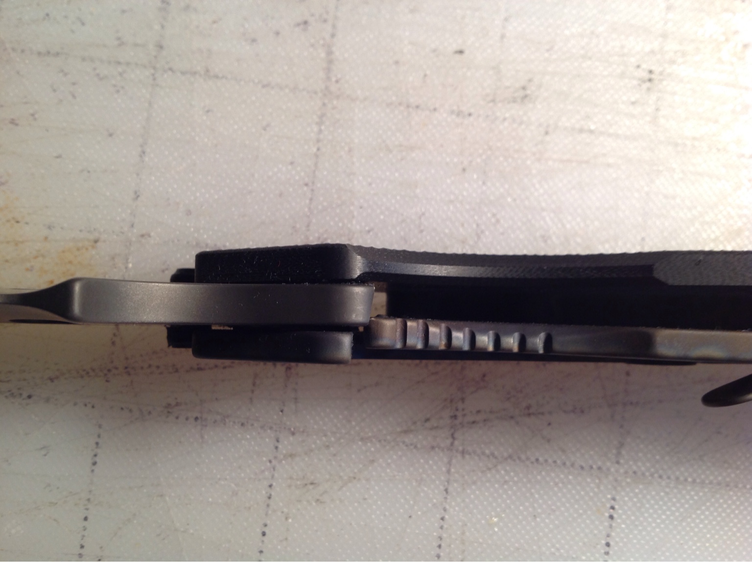

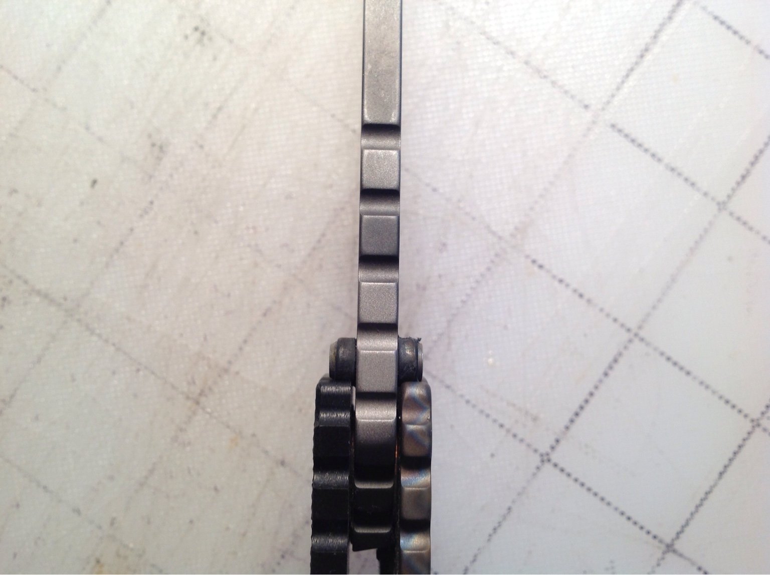

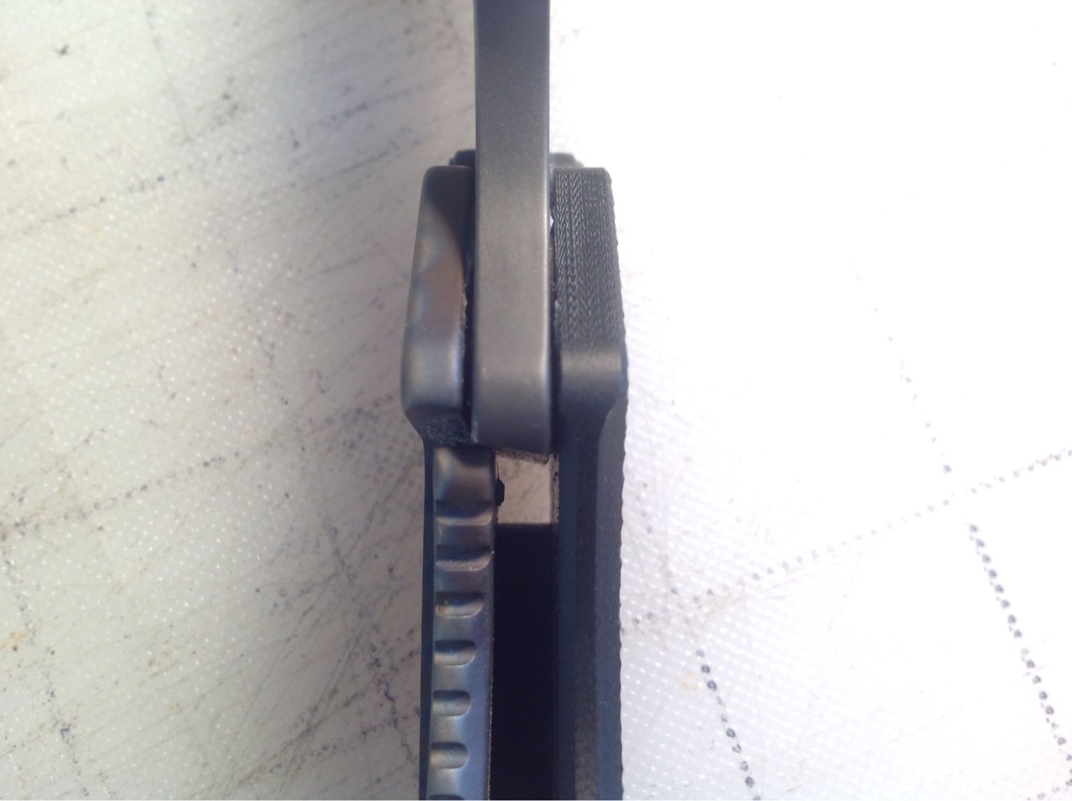

Lock-up is now at 10%
Zero blade play what so ever. Solid!
The best thing about this fix is, nothing is taken apart. No undue wear occurs. As the plastic wears in 15% lock-up will occur. Plastic is easy to replace if need be. Win win!
