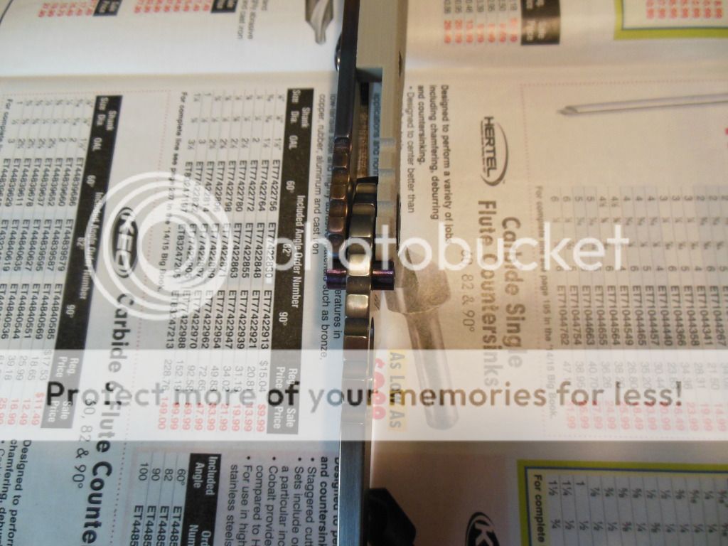

My Strider lock-fix

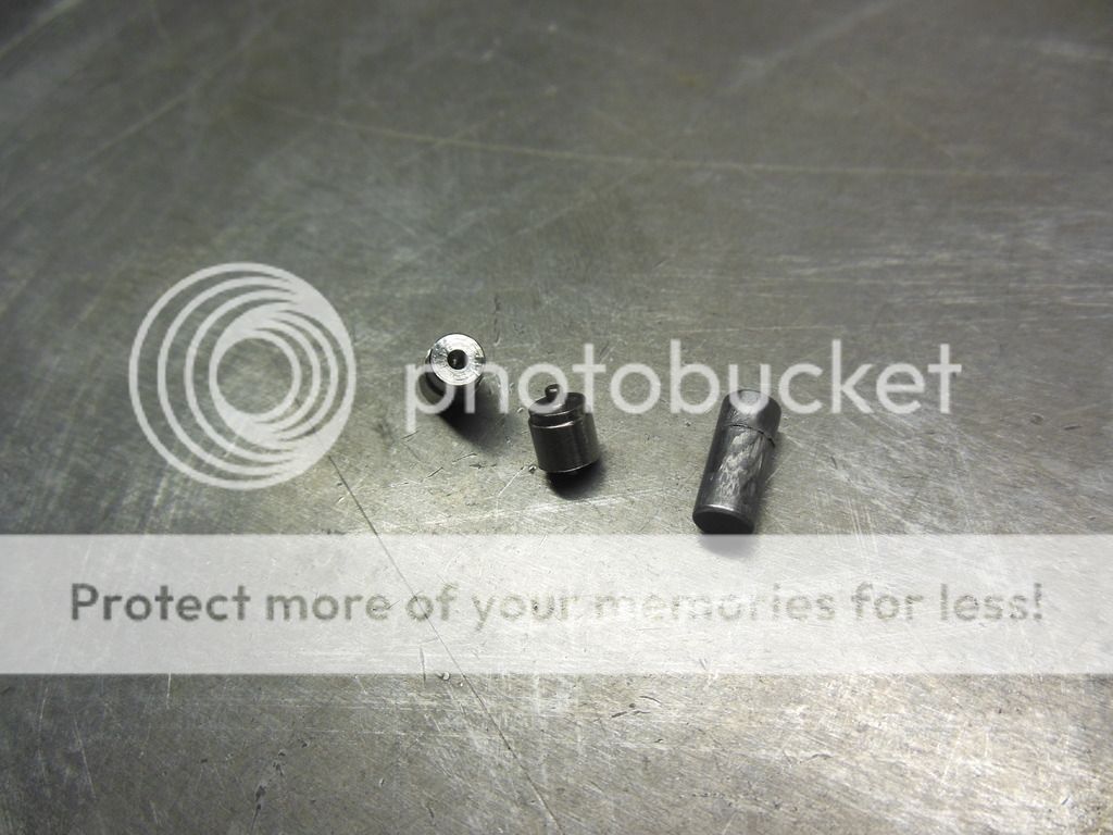

I don't know about other's SnG, but on mine new designed PD-1's, it developed problem after 3 weeks of breaking in - just normal open/close without aggressive flicks to loosen up the sluggish pivot - that was after I made a proper tool to loosen up the pivot without undue damage:
Lock up percentage increased everyday until lock rock was developed. "MY" root cause was the rough finish on the blade tang's locking interface, acting much like a file, which accelerated wear on the soft Ti lock bar with each open/close.
I am fairly capable as to the mechanics of making simple fixes, along with avoiding on warranty work that shouldn't have required in the first place and besides expensive shipping cost for warranty, also knowing warranty fix is not a permanent fix.
Among a host of other modes to make the SnG uniquely my own. I took care of the terrible interface tang finish, heat treated the Ti lock bar interface to resist wear and made two piece Ti interlocking stop pin for a permanent fix on a knife that should not have left the maker the way it was:
Strider's fix - normally will replace the original stop pin with a step stop pin, the larger side engage the Ti to alter the angle of the blade tang(slight boomerang like curve)to restore the earlier engagement of the Ti lock bar and the G-10(presentation) side will not be be touching the handle slab. The lopsided replacement lock pin is clearly visible on repaired knives.
Both shrink tubing and "O" type fix are temporary at best - although shrink tubing is better because it is harder after heat exposure and yields less. Heat shrink tubing been extensively tried by "Blacksheep" over at the "other" more exclusive hardcore forum. Since stop pin is a secondary lock, with the Ti lock bar being the other locking mechanism combined to form Strider's double lock design - solid locking is made, requiring to have metal to metal contacts.
Machined parts often tells the tale and resulted evidence can be interesting.

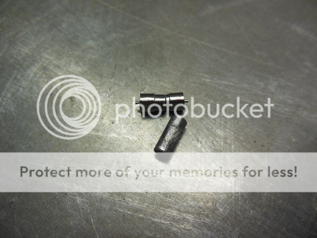

Original stop pin as shown next to my home made, roughed out two piece Ti interlocking stop pin:
Original's rather soft, removed steel stop pin, shown having multiple distortion, predominately along in the center portion, most likely to compensate for the less than perfect "press fit" dimension of the receiving hole - than it was "Press fit" into blade hole. As experience with most mass production product, lacking good quality controls, this company has experienced it fair shares of cracked blade due to improper relationship of "fit" between stop pin and receiving harden blade hole.

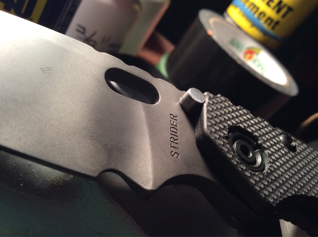

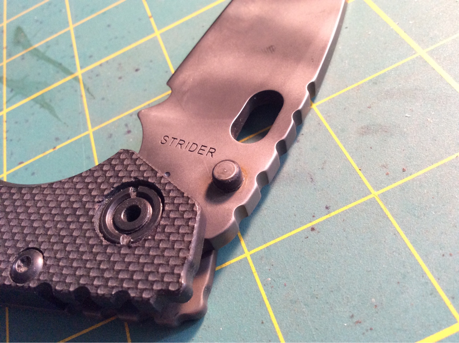

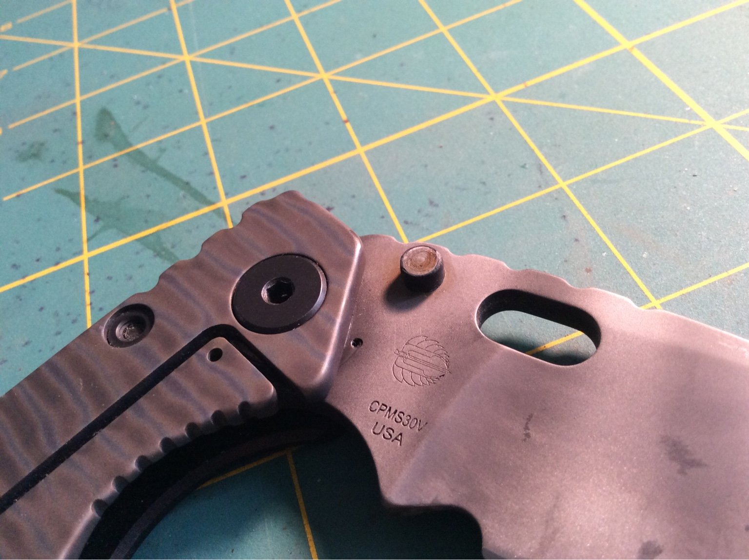

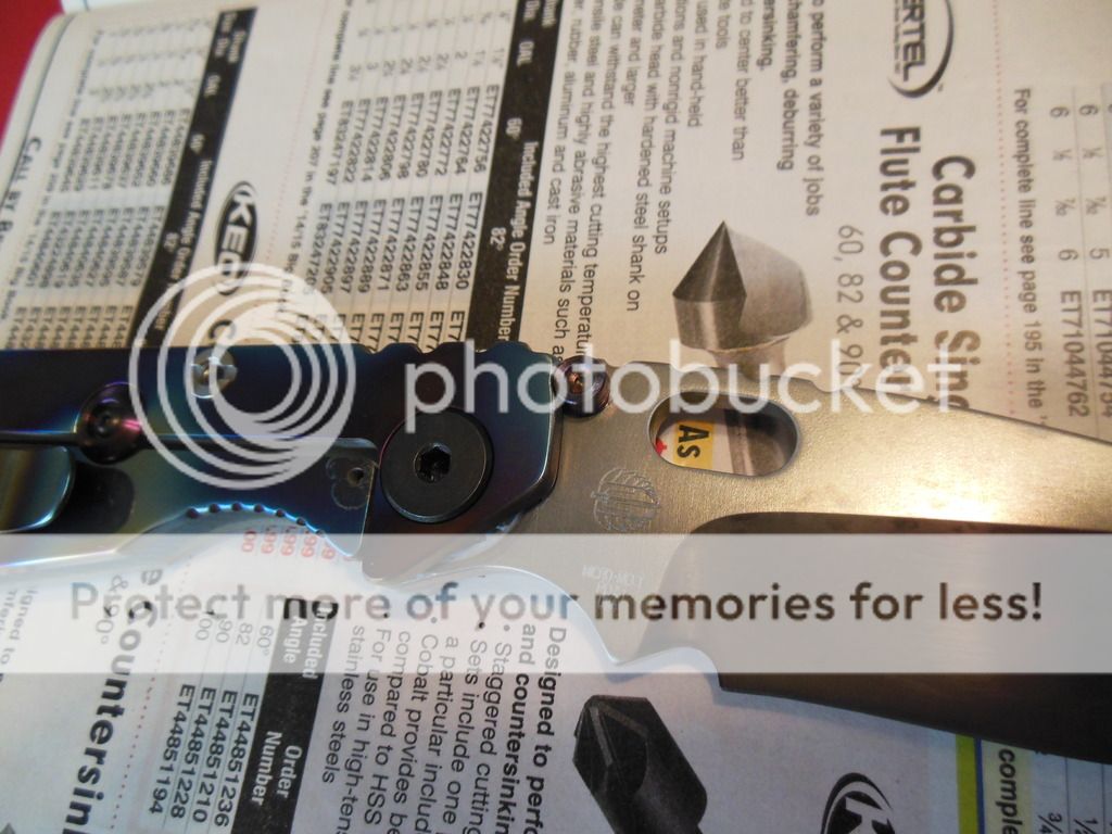

Wave mod? Didn't look like you did anything to it. Email Josh Lee and ask, I bet they will fix ya right up.
Double check my pics above; it's there... ;):D:thumbup:

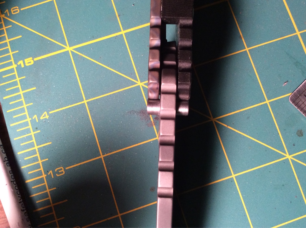

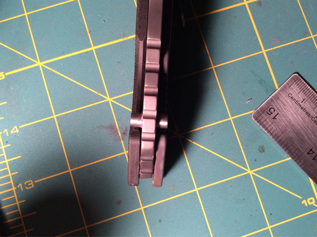

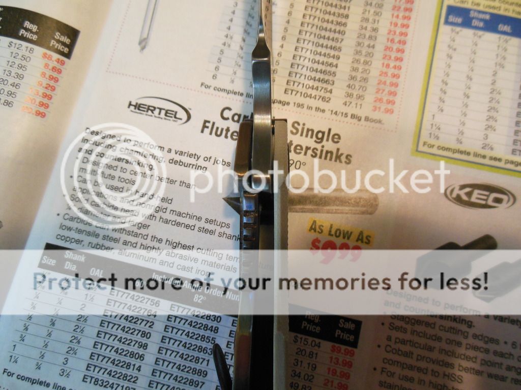

A better pic of it prior to the tubing being added plus two of the other knives I've waved:
At this point I'm not worried about sending it in; I may email them in future if it becomes an issue again.
I just received an email asking where to purchase the tubes. Here is my response:
Automotive store. Electrical section where connectors and such are found. It comes in various diameters and thicknesses. Get the thinnest. Get a few diameters and use the snuggest fitting. Trim it so it's about a millimetre below the top. Heat it enough that you don't fry the tube and don't damage the blade. Works great. Open blade gently before plastic hardens so it "seats" to the contour of the frame/g10. Leave open and let cool.

Just a follow-up report. This mod/fix is rock solid. I am happy with the results and no issues have surfaced to date.

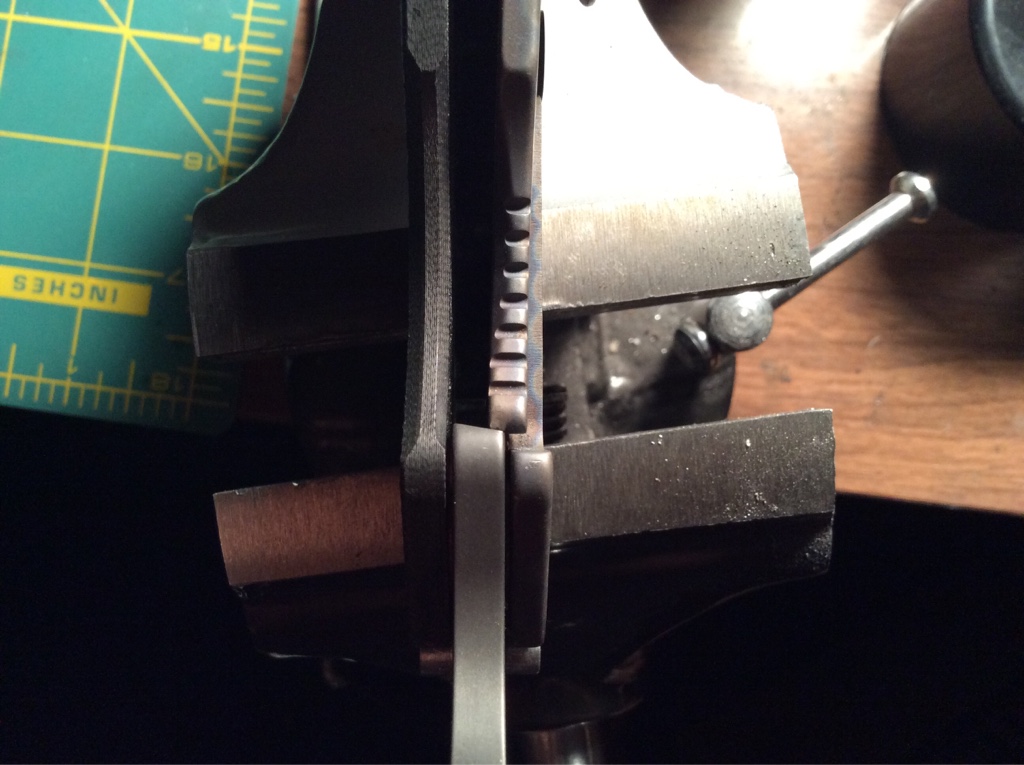

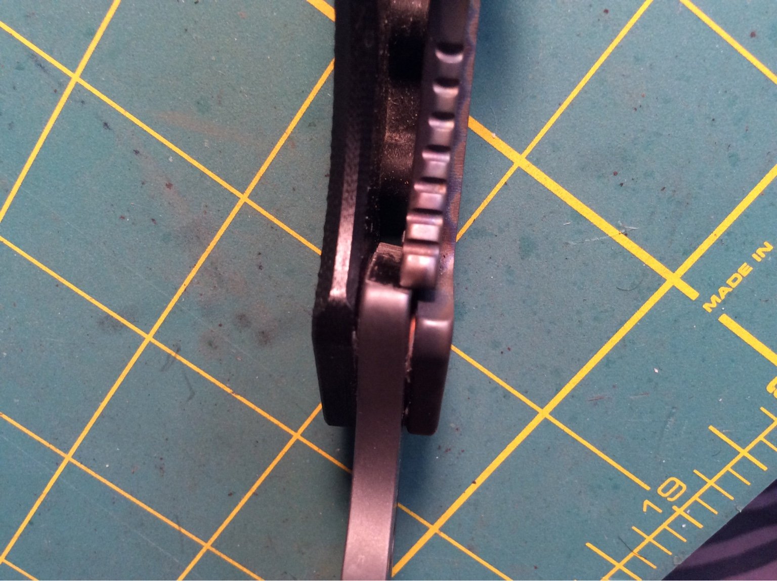

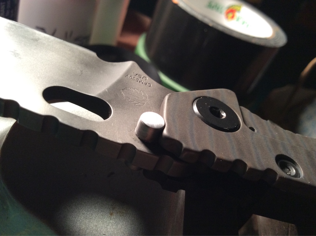

Well this will be my recap. I bought a piece of round stock metal and made the correct fix once and for all. I used a drill and a file and made a ghetto lathe. The blade is untouched. Lock-up is solid. Rock is gone. Acceptable lock engagement. Sending it back was not an option as some of the stuff I read was pretty scary. Anyway pride of ownership has its rewards. A job well done!
