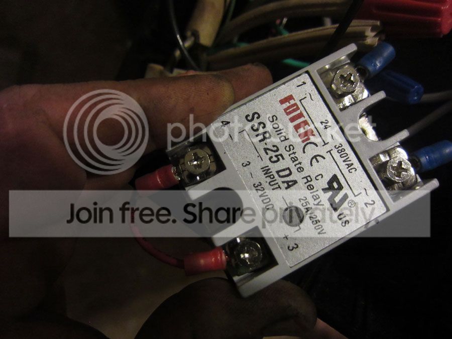

I started a thread a couple of weeks ago about using a big top loading kiln for heat treating swords. Well... Y'all were right. Heat rises. :-) So I decided to take it apart to re-use the soft bricks, the elements and the power. I then took a smaller Aim pottery kiln and removed the back and stripped the elements and then welded up an angle iron frame. The idea was to use the smaller kiln as the door and then stack the fire bricks from the other kiln to elongate it. So here it is now with all the bricks cemented and framed up. I next need to come up with a top that will be easy to remove in case of a future element failure... and then tackle wiring. I have a PID/SSR set-up built from the sticky on this forum so I just need to convert it to 220. I'd love some advice on that.
Anyway... so far I'm happy with how it's coming together!
By the way... I had originally built my PID/SSR set-up to run a controlled forge so I intended it to be a 110 set-up. But I just opened my box and noticed that the SSR indicates 240V. I never noticed that before. Am I interpreting this correctly?
If that is indeed correct then all I have to do is put on the heat sink, build a bigger metal box and install computer cooling fan??
Thanks Mark..
Okay I just saw the other thread that was just posted which had a wiring diagram for 220. So... It looks like I could run my kiln with the SSR pictured above... but two would provide the safety feature of making sure no power is going to the coils.
But.. my kiln will have the original power controls that were on the original kiln. These controls include a power switch... basically the hi/low knobs that ran the kiln. So ... would I still want the second SSR then?

Here is how I have my Oven wired. 2 SSRs shut down both sides of the 220. With just one side shut down the other side of the 220 is still hot to ground and your oven frame should be ground.
Notice that I have a door switch, it is a push button mounted so it is off when the door is not closed, the second switch is a toggle on the control box that shuts the elements down while I mess with the PID. Check the terminal numbers on your PID as mine is one that I can program the ramp soak. Jim

I use two of those same ssr's in both kiln I have built. They will work well.
