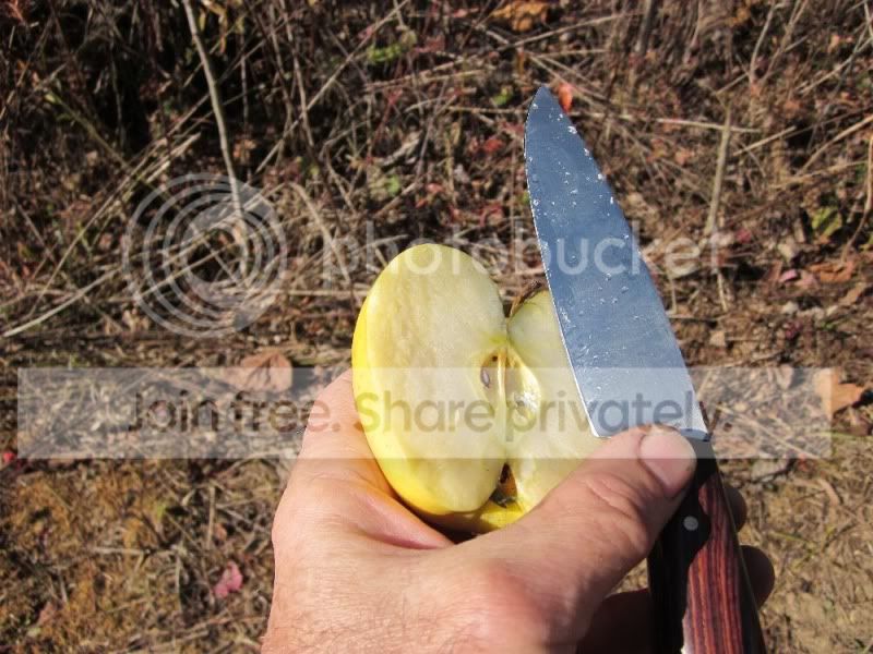

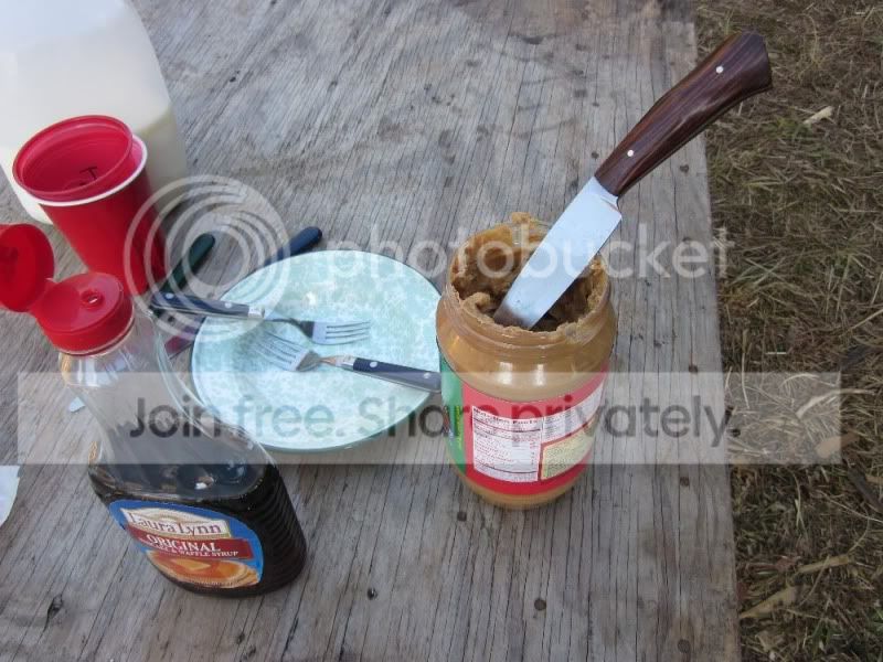

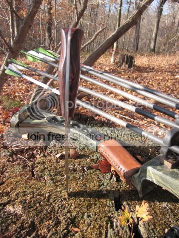

I have made a few knives from 52100 tested by chopping 2x4's, cuting rope and shaving arm hair but I wanted to put the steel to an actual use test. So, as much as I hated having to do this I packed up this knife and went to deer camp for a couple of weeks. I made this one a little longer and thinner than I normally would for myself but I had a lot of different uses planned. Hopefully putting up a lot of venison.

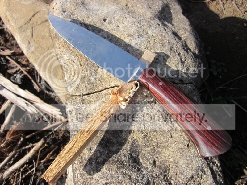

Two fires a day started with shaved fatwood.
The apple did not stain the 52100 until I left it in the scabbard with the apple juice still on the blade. Just a slight dull gray stain like vinegar might cause with extended exposure. No rust.

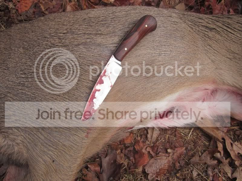

A small doe is field dressed.

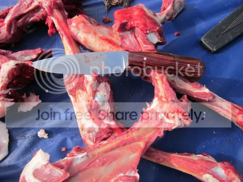

Skinned, boned and cut to steaks and roasts.

When I got home I looked at my edge with a 10X glass and found no chips or folding of the edge. The chromium in this steel not only makes it tough, it makes it fairly stain resistant. A knife from 52100 could easily be kept rust free; I like that. Using Ed Fowler's heat treating methods the knife had a very fine grain and cut meat, wood and other materials very well. Does 52100 make a better hunting knife than the 5160 that I have been using? I don't know yet, I will have to continue my testing for a few more years.....darn.

I'm suprised. Cutting peanut butter usually chips the blade every time.
