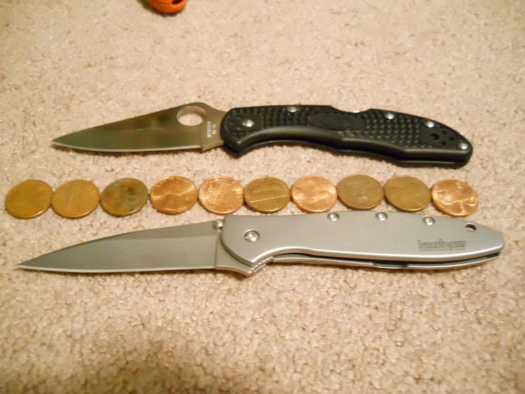

Its almost exactly the same size as a Kershaw Leek.
It is really light.
Pretty close to the weight of a full sized Griptilian, but a bit less.
The size makes it sheeple-friendly, and it is a great in-pocket knife.

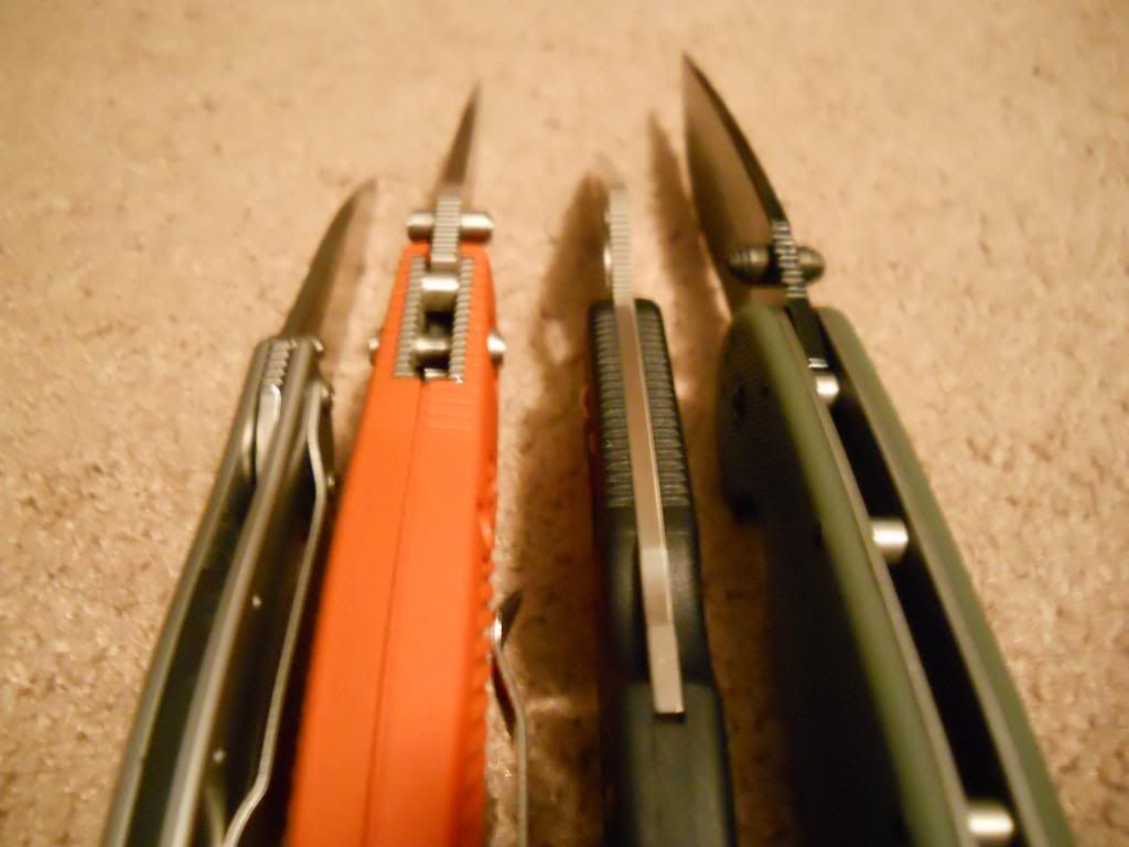

The handle fills my large hand perfectly.
Leel, Griptilian, Delica, RAT-1

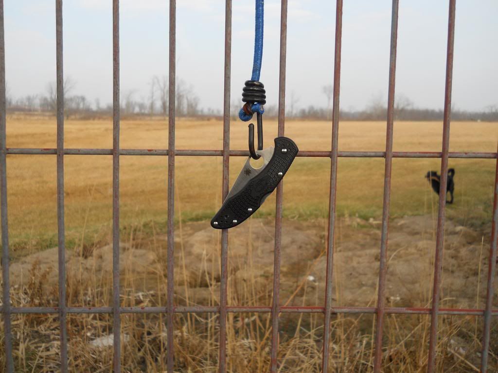

The lanyard hole is small, and it's tough to get paracord to go through.
I have been unsuccessfull at getting it to go through whole, but it can be done.

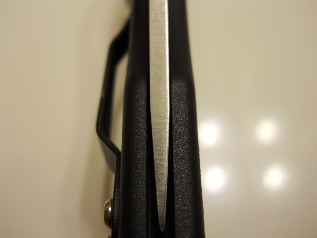

Blade is pretty centered. Not perfect.
Opens stiff. Not very smooth. The washers are small and thin.
No bladeplay horizontally, minor lock-rock vertical. (It takes alot of pressure to feel the lock-rock.)

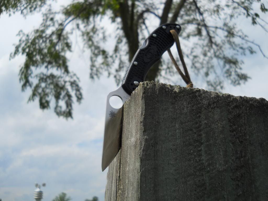

Is it tough?
I dropped it about 4 feet onto concrete.
It got a flat-spot in the handle. It did not crack or chip the FRN.
I spent hours cutting thick cardboard and boxing tape a couple weeks back.
I wouldnt say it got dull, but it needed some touch-ups.
No bladeplay, and it didnt loosen up. The same day I did all of this cutting was when I dropped it as well.

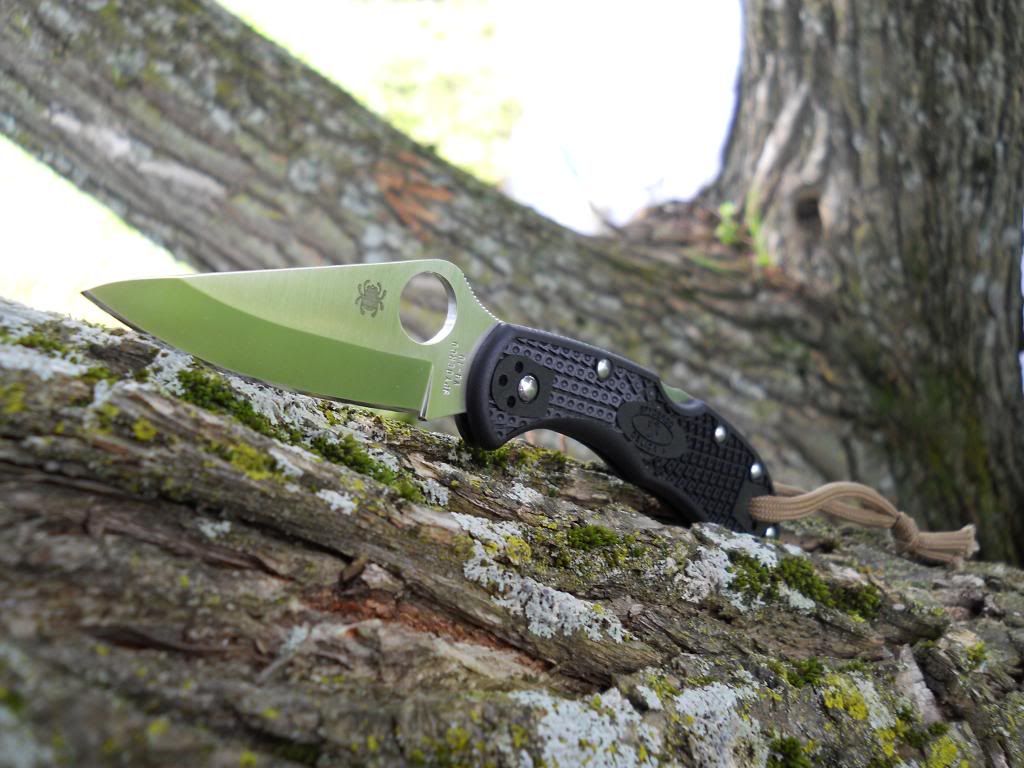

This VG-10 stuff is great.
It can be touched up really quickly, and it stays sharp and clean-edged for a long time.
It rolls instead of chipping so even stropping it on your jeans works really good.

Great little review. FYI, I can get 550 paracord through the lanyard hole with no problem and all of the strands left inside. Just takes a bit of patience.

Try cutting the paracord at about a 60 degree angle, just get it started and yank it through with a pair of needle nose pliers.
Every time I tried cutting it flat, the outer layer wouldn't go through.
That should work though.
