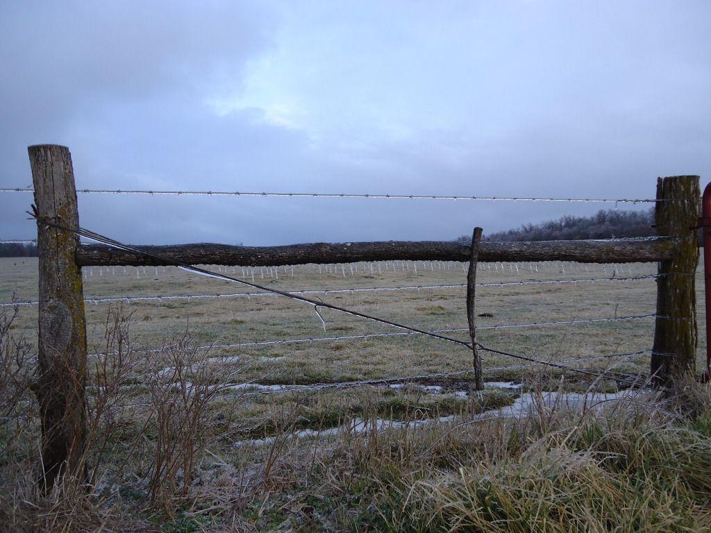

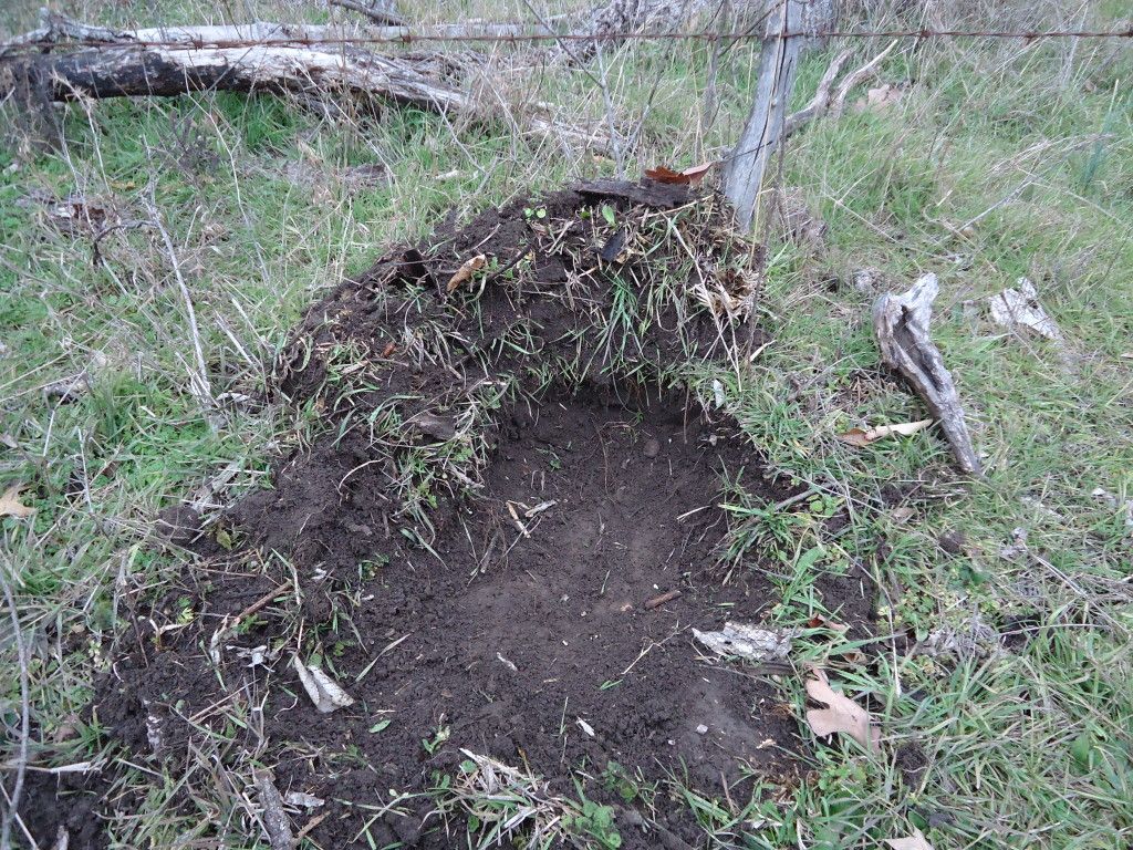

I dug out an area for the set. This set is located in a fencerow and just off one of our roads through the woods, which wildlife also use. I have seen a coyote in this spot while out turkey hunting.
All the dirt I removed was used to make a bank to border the rear and sides of the set. This is to make the set accessible only from the front.
I secured the trap chain using two stakes inserted diagonally in opposing directions.

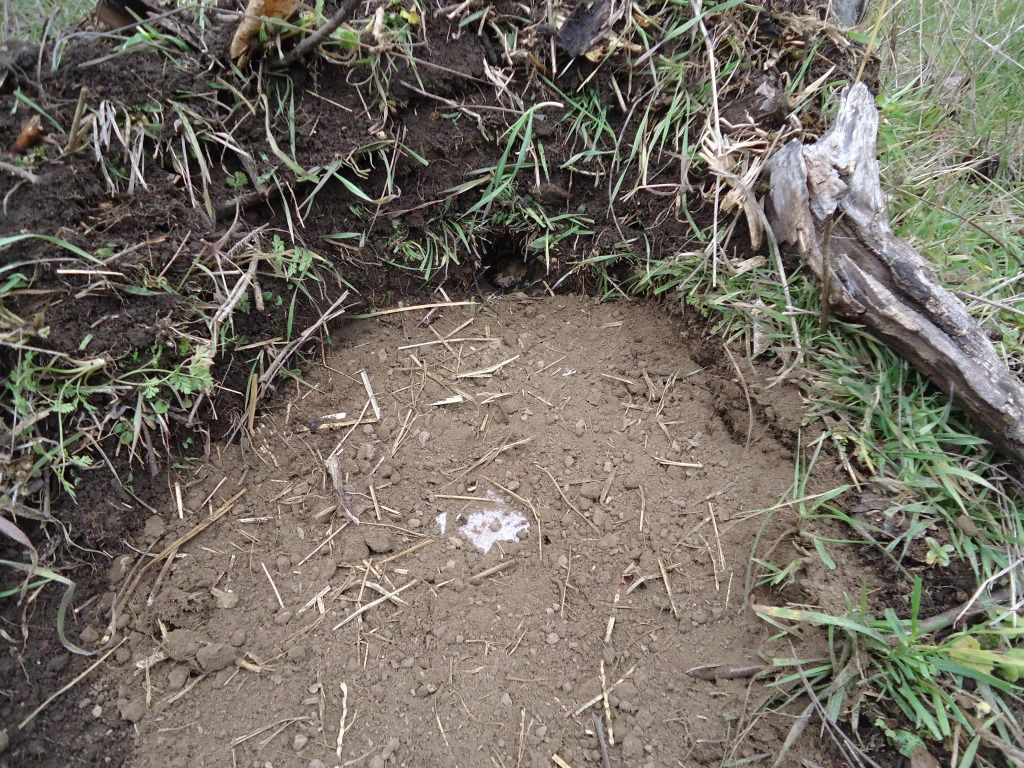

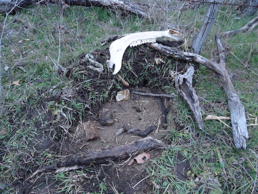

Trap set. The trap must be bedded so that it does not move if an animal steps on the jaws.

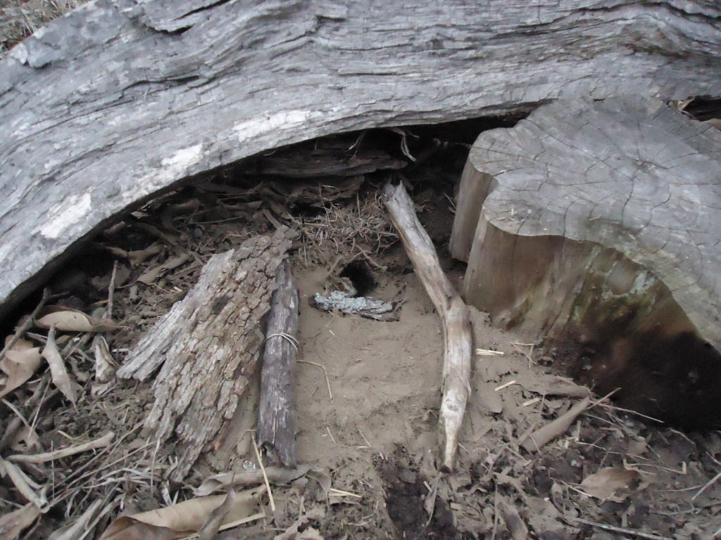

The pan is covered, and loose dirt is used to cover the trap. At this point, the trap pan should be the lowest spot in the set. I punched a narrow hole, in which to put the bait. I used some pork loin left over from Christmas for bait.

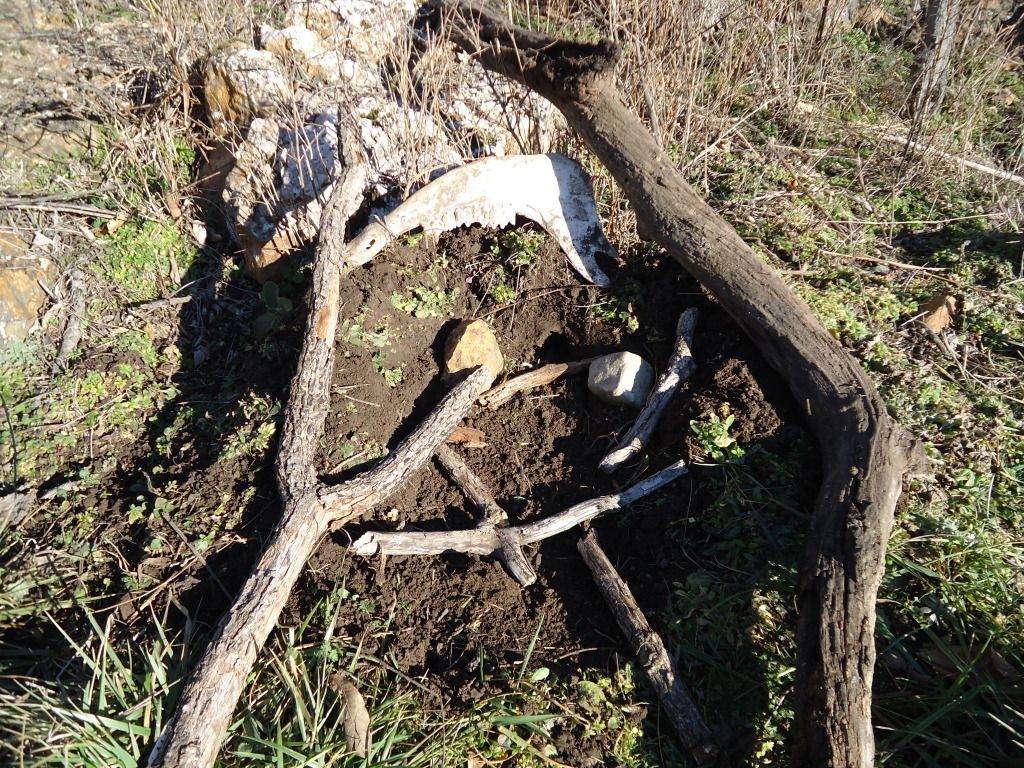

I placed sticks and rocks around the trap. The goal is to make the trap pan the only comfortable place in the set for an animal to place their foot. I then covered the trap pan.

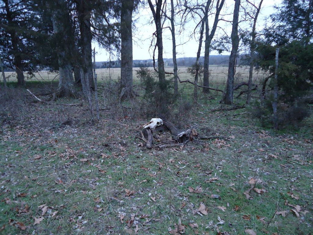

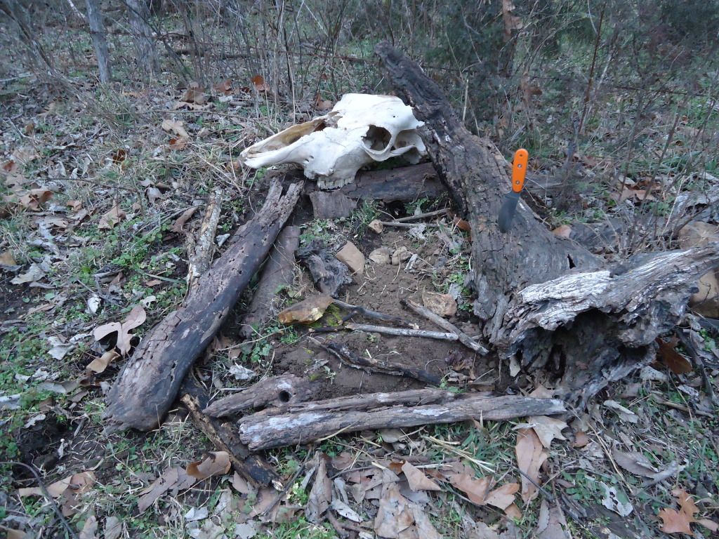

I then moved on the second set location. This set is North of the previous one on the same fencerow. Like the other one, there is a road just to the west, and woods beyond that. To the east is pasture. There is a trail nearby where something crosses under the fence.

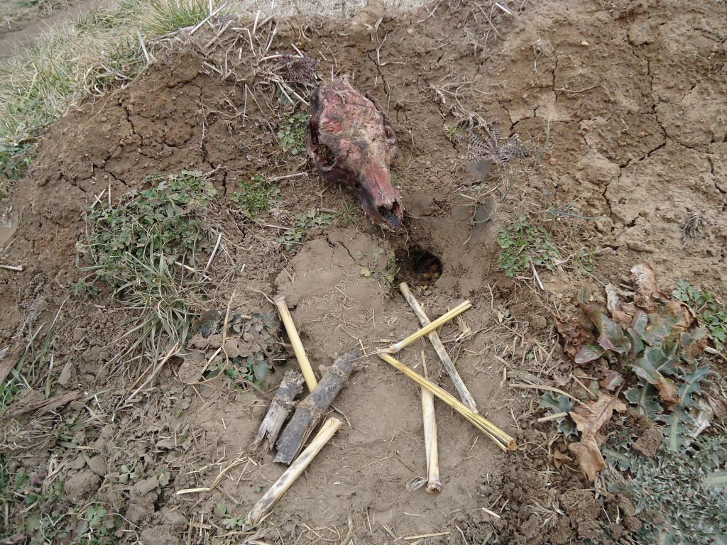

I found some cow bones, and used the skull as a visual attractant to this trap set.
Same process as before. I used some scrap cotton material for pan covers.
Finished set.

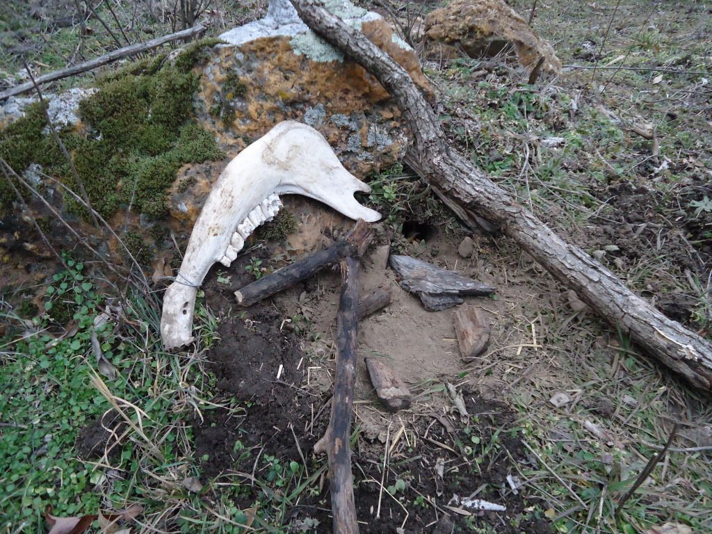

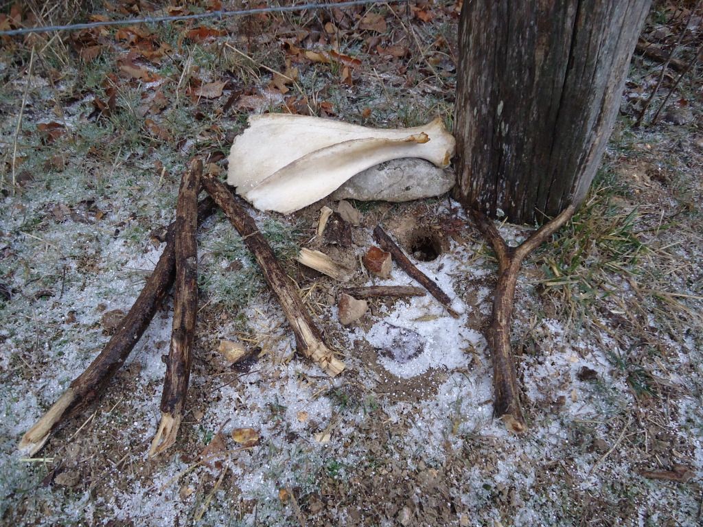

Since I had found the cow bones, I went back and added the jaw bone as a visual attractant to the first trap.

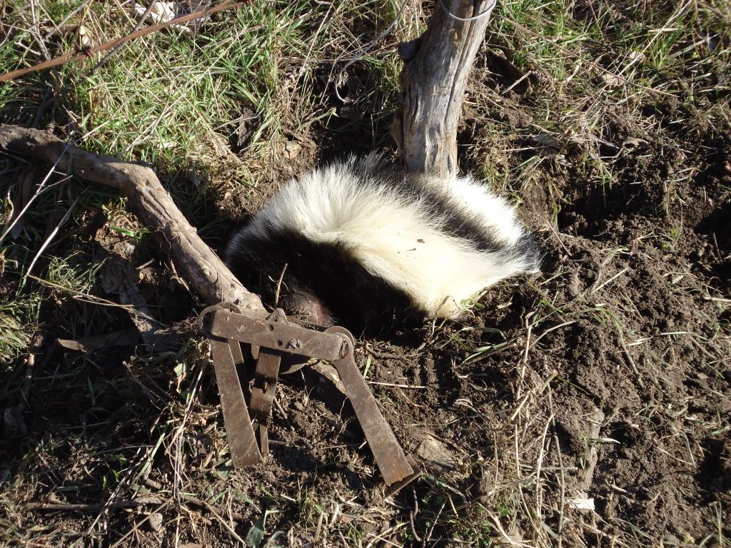

The next morning, I checked the traps. Nothing in trap 2. But as I neared trap 1, I could see movement.
A skunk.
Sorry, no up close, live pictures of this guy.
Dispatched the skunk.
A good looking hide, too bad skunk pelts aren't worth anything. Still, I was quite excited that I caught something in my first ever trap set.

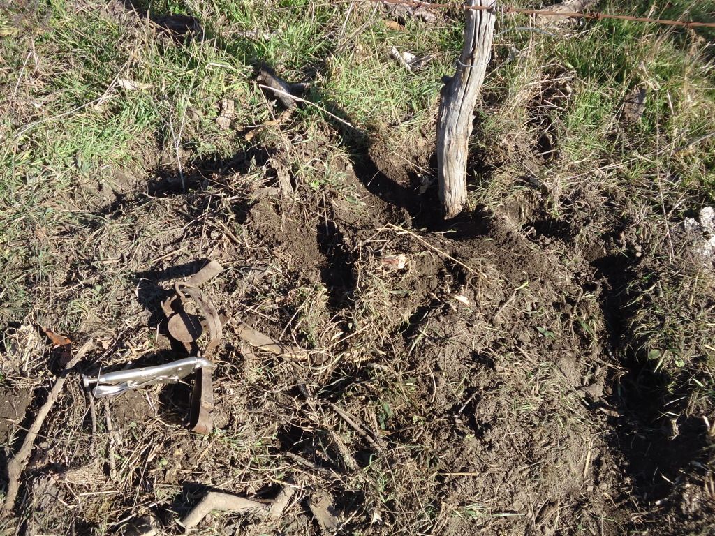

This is what the set looked like after the skunk got through with it.

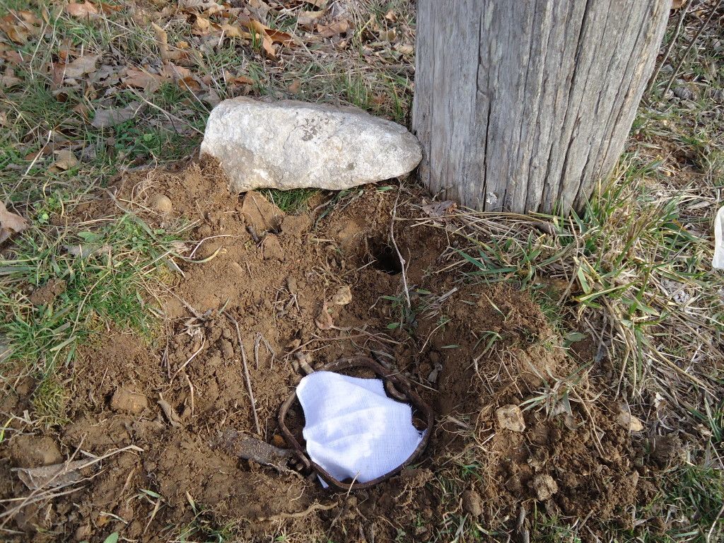

I reset the trap a few yards away next to a rock.

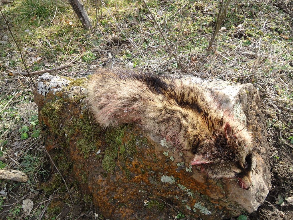

and I dispatched the coon with a shot to the head.
Now I have a hide to do something with.

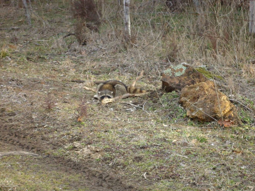

I put the carcass in a tree and reset the trap underneath it.

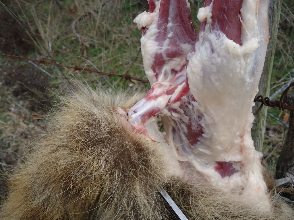

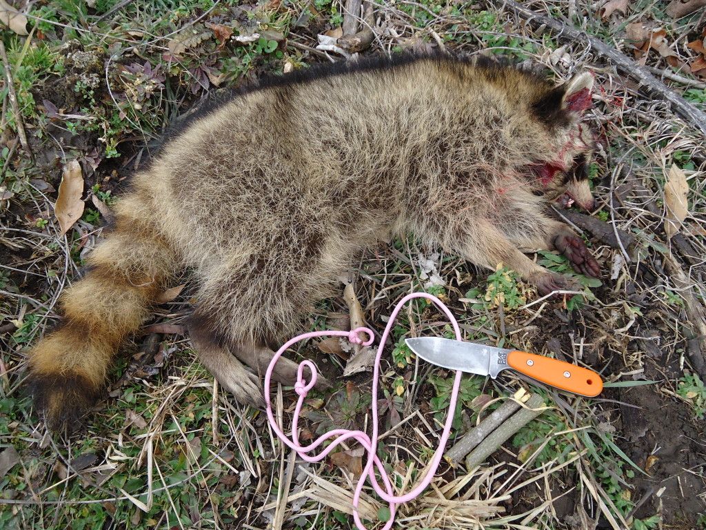

This is the process I follow when skinning a coon. I am certainly not an expert skinner, but these techniques were taught to me by an experienced coon hunter and seem to work.
First, the equipment I use. I'm not going to say that a certain knife is better for skinning than any other, but I prefer a small fixed blade. I find that longer blades are unwieldy. In fact, the 3.25 inch BK-14 I'm using is too big for the old coon hunters I hunt with. They generally use very small, slim fixed blades or the spey blade on a traditional folder. I also carry a length of paracord with loops on each end and two finger-sized, green sticks. These items will be explained later.
Skinning will be much easier while the animal is still warm.

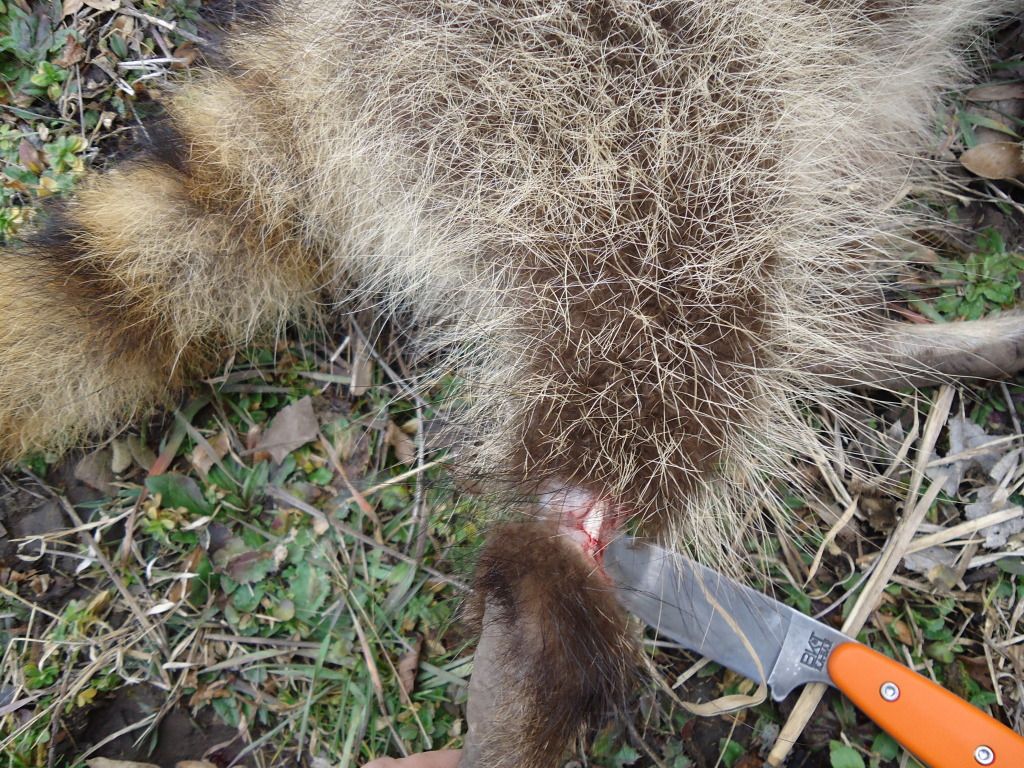

Start by cutting through the hide all the way around the rear ankles.
Then cut up the inside of each leg.

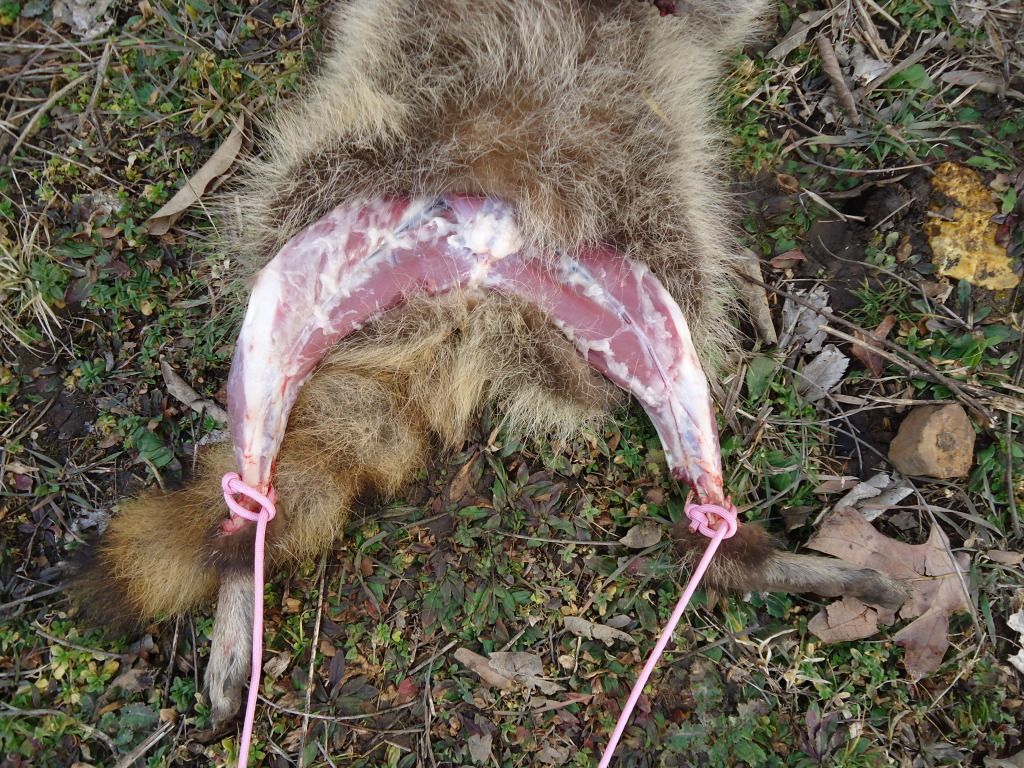

Strip the hide from each rear leg. The hide can be somewhat peeled off by just pulling, but often you will need to assist in separating the hide from the flesh underneath by lightly slicing where the skin and muscle are attached... without cutting through the hide.
At this point, I loop the paracord around the ankles, and hang the coon from a tree limb, or in this case a fence post.
Continue removing the hide

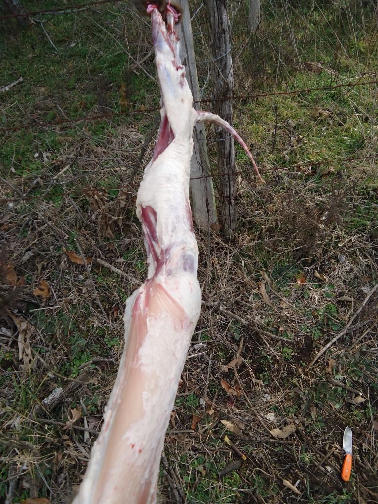

until the hide is separated all the way around the tail.
Remove the hide a little way up the tail.
They make a tool for stripping the tail, but we have always just used two sticks. Place a stick on each side of the tail, grip them tightly, and pull hard. This will strip the hide off the tail.

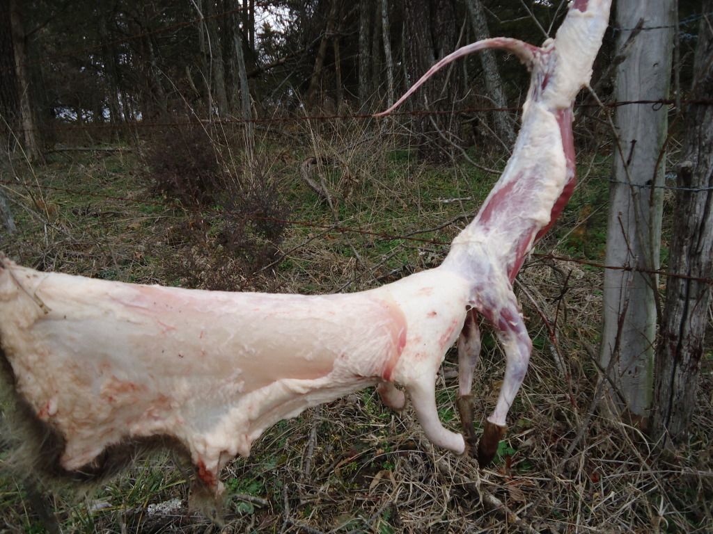

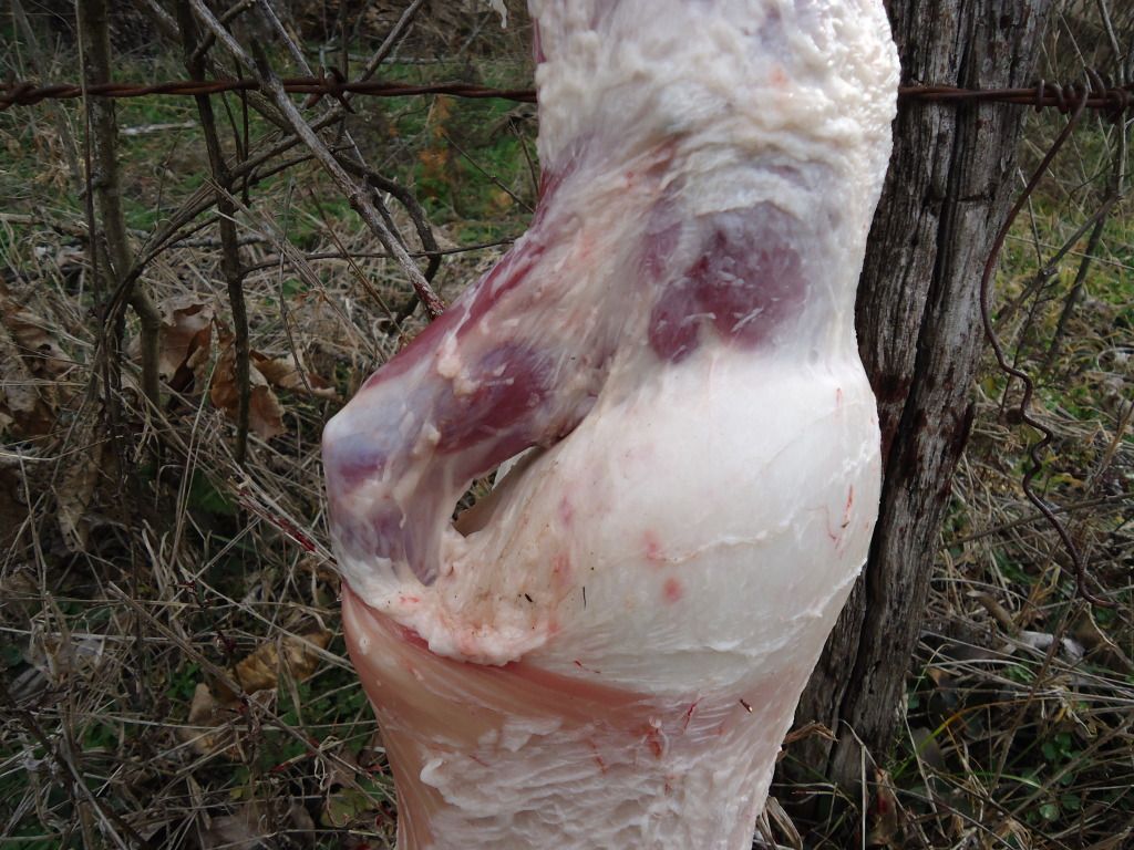

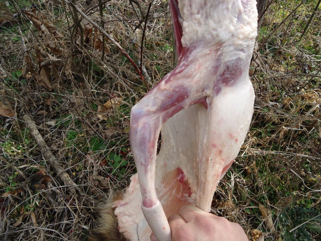

After the tail is stripped, the hide can usually be pulled hard and peeled off up to the shoulders.

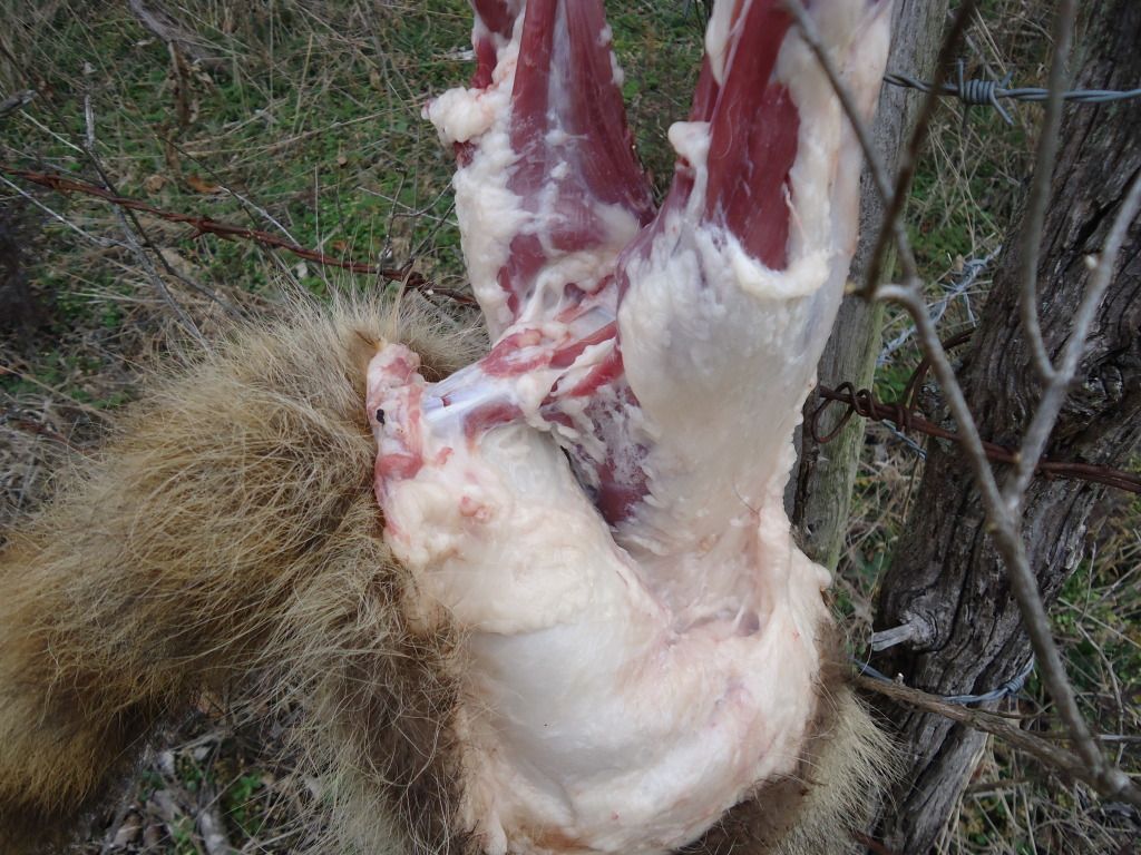

Now, carefully remove the hide until the forearm can be exposed.
By hooking your fingers under the elbow and pulling the hide with your other hand, the skin can be peeled off the lower arm.
Then sever the hide around the wrist.
After getting the skin off the legs, peel the hide down to the head.
The head is the hard part. Work slowly, pulling and cutting until you get to the ears.
Cut through the ear cartilage and remove the ears with the hide.

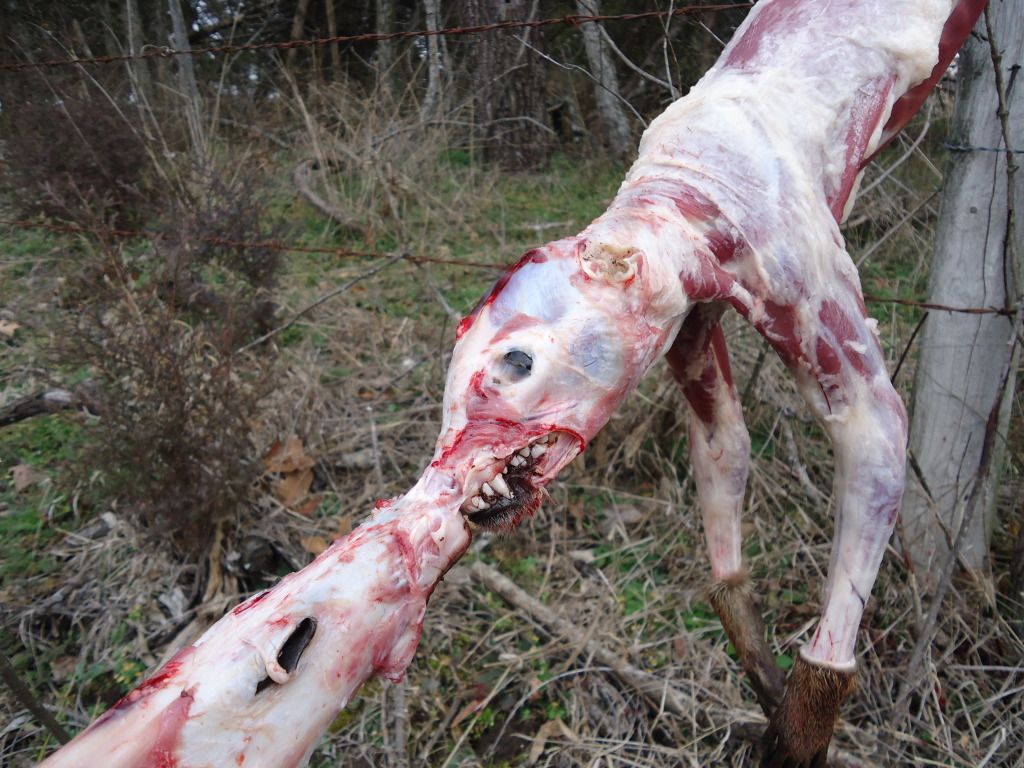

It is often helpful to use the ear holes as handles while pulling and cutting all around the head. Carefully cut around the eyes.

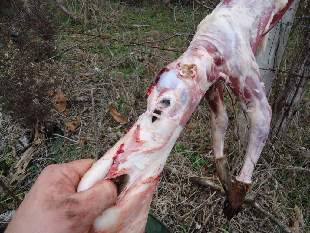

Continue removing the skin down the face. Cut through and detach the hide at the lips.
I didn't do very well on the lower jaw.
At the nose, cut under the nose so that it stays with the hide. After this cut, the hide will be detached from the carcass.
Turn the hide right side out
