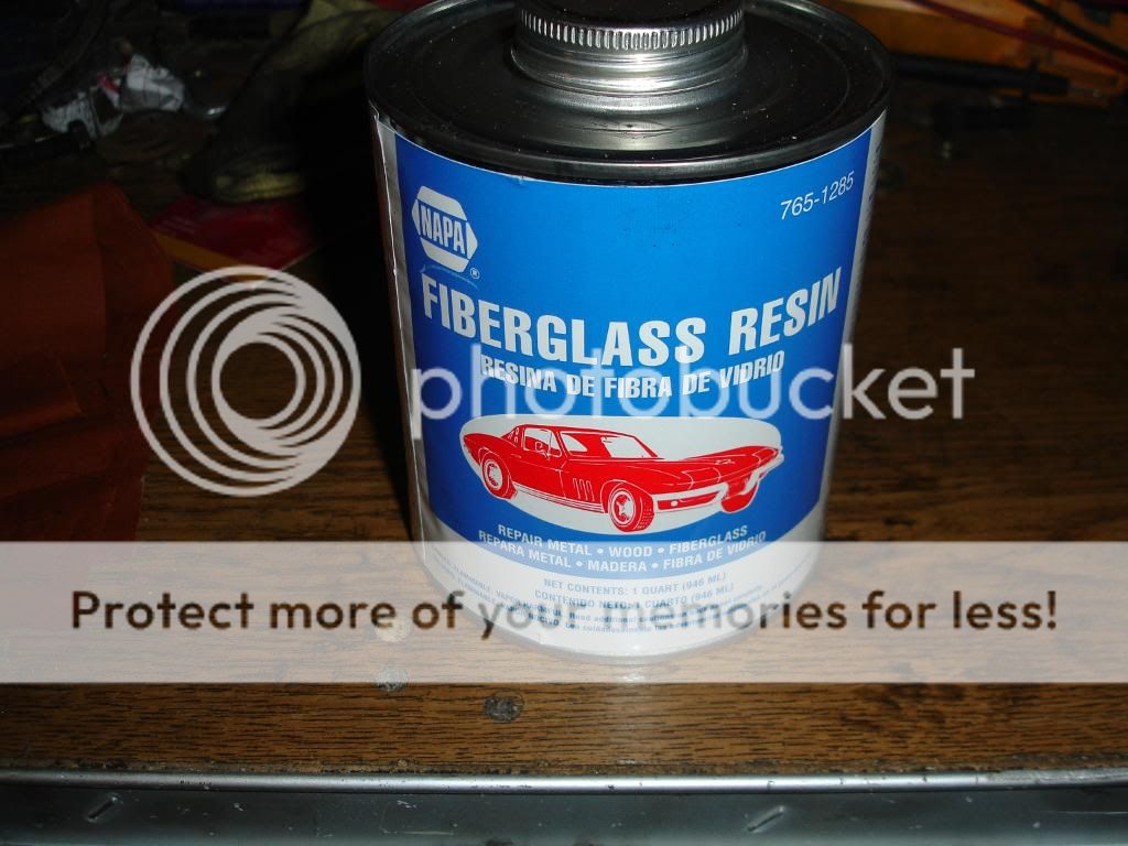

So I like the look of the micarta scales, and I didn't want to spend the $40 on a pre-made set where I would have no choice in color so I decided to try to make my own.
Today I got home to an empty house and what better time to do it other than then. I went out and got some Napa flavored resin and got some scrap fabric from the fabric store the other day. So the scales will be a mix of felt and linen; burnt orange and tan.
This will be an as I go posting of pics. And since I already 'glued' it all together I just have a pic of the colors that I used for the scales for ya. Tomorrow I will be taking it apart from the press.
'Till tomorrow here ya go. The colors I'm using.

Also to the o.p. could you put up a pic of the resin you used?

Also thanks for the pic of the resin. I used that for the first couple batches, I wasted so much trying to get the mixture right,First batch dried too fast, second never set up,and the smell, holy crap. I had to switch to something easier to manage.
Yes I did. I just took it out of, and I'm gonna let it sit inside the house for a while before I start cutting it up.
I'll get 'em up as soon as I take 'em.
