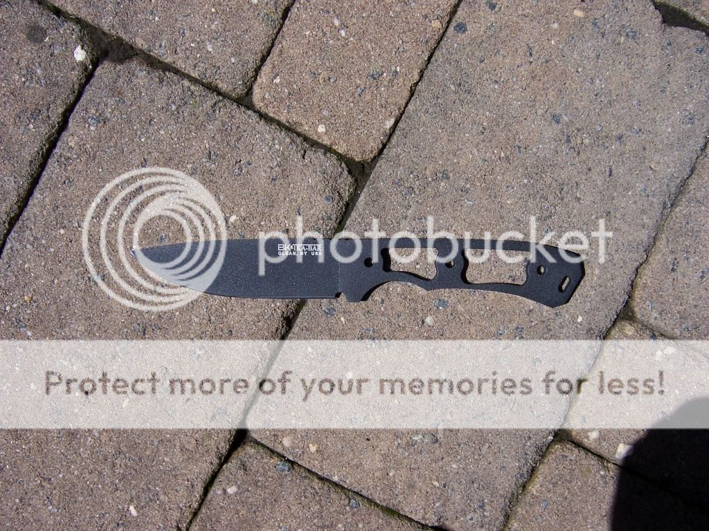

My turn to mod a BK16
Aug 13, 2008
1,277

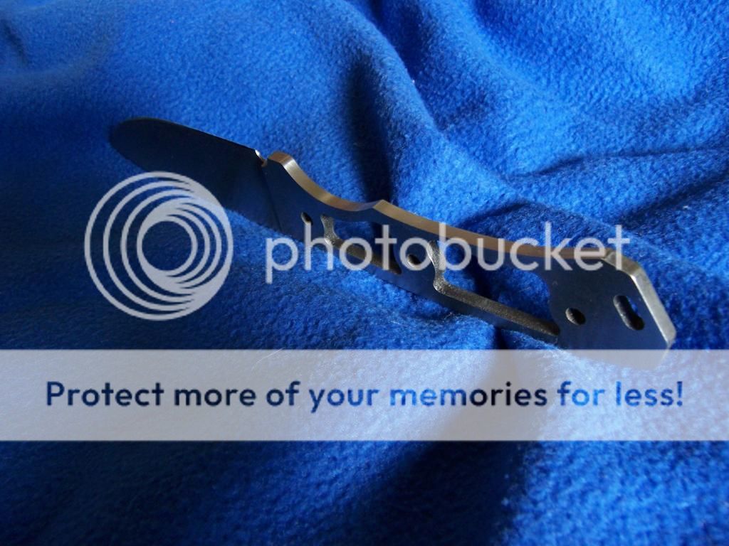

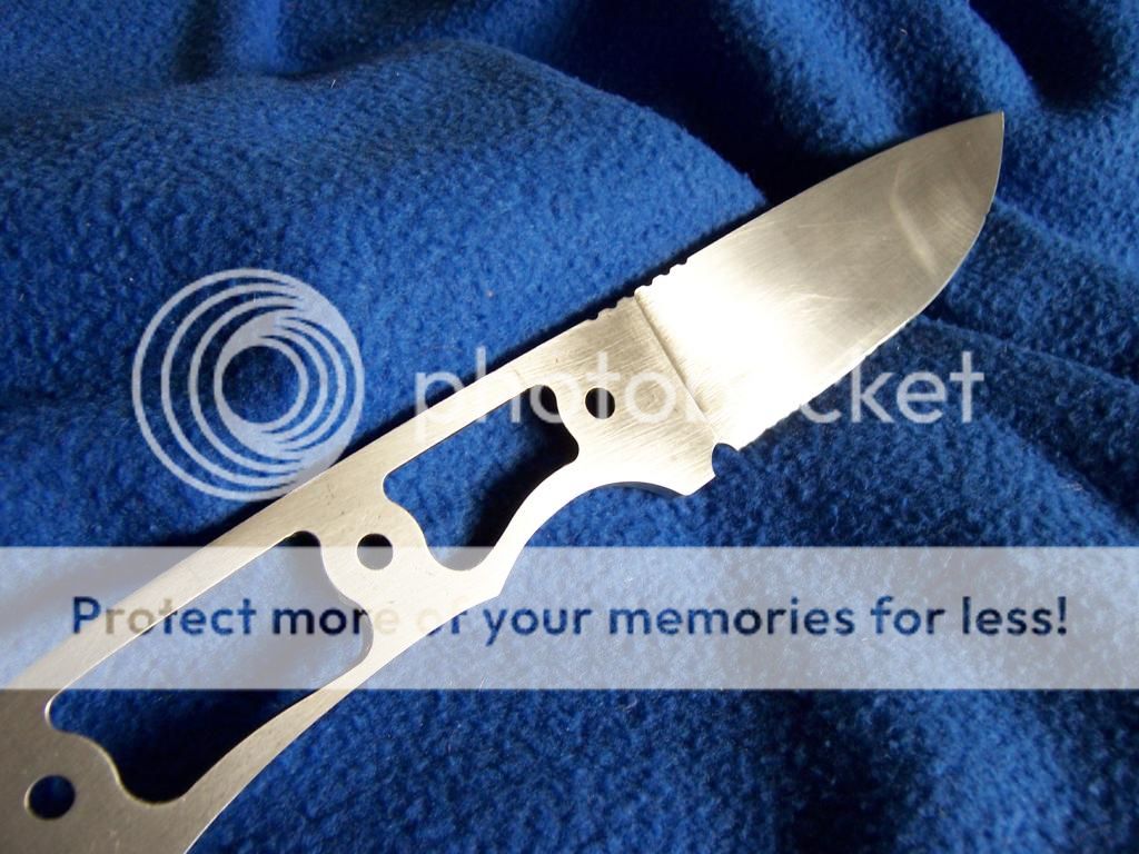

After seeing all the fun Dexwithers, Granitestateofmind and tjswarbrick have been having lately, I decided need to have a turn. I made drawings, a template and then drew the outline on the blade and handle. Next I started grinding on the belt grinder to achieve the shape. I kept everything cool with cold water and a light touch with the grinder. When the TLAFAR principle was reached, I stopped. Here's the resulting shape to start my mod. I didn't forget the 11 and 14 that I started. I could not wait to work outside in the sun today. The entire shape was changed except for the lanyard hole. That will be removed later.
TLAFAR= That Looks And Feels About Right

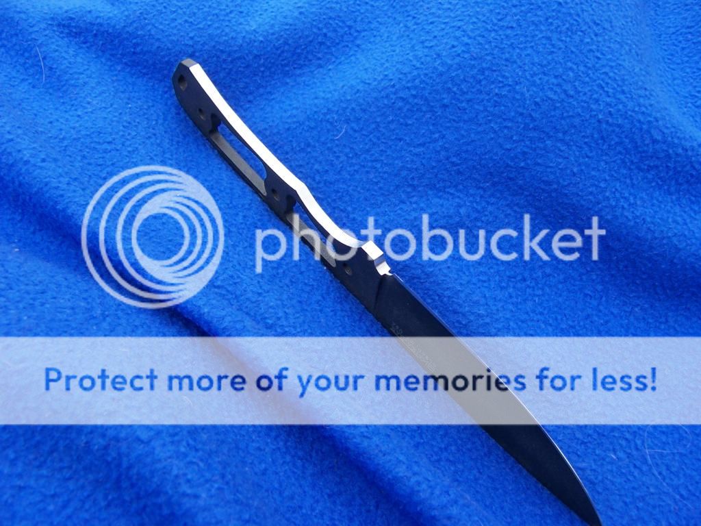

Had to do just a bit more. I cleaned up the sharpening choil.

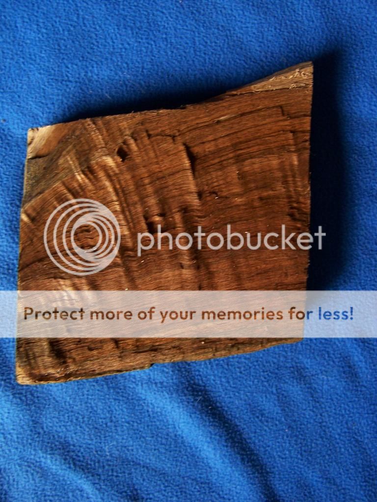

Thanks for the comments and encouragement everyone. I decided to prepare some walnut for the 11, 14 and 16 scales.

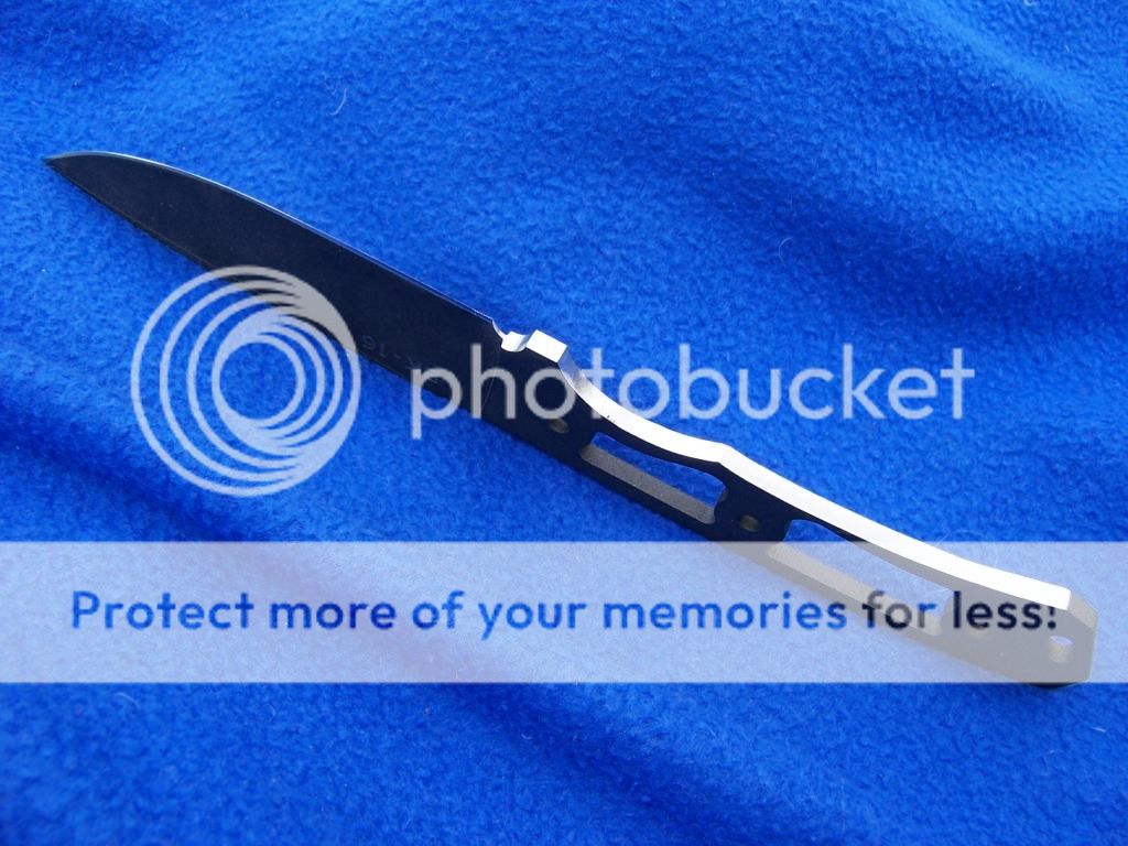

A little bit more progress today. I started to remove tool and grinding marks after I stripped the 16. I started with 180 wet or dry lubed with WD-40 and backed with my Great Planes sanding block. This step will take me a few hours before moving to the 220.

Nice job on the sanding. Sure wish Ka-bar wouldn't give us so many grind marks tho.
Not up to my pre injury speed. There is a lot of wet sanding to do before this knife has the metal finish I'm looking for. Getting the blade finish smooth is time consuming and the ricasso has deep marks from the manufacturing process that require some serious attention in order to keep everything square. This is the walnut I will be using for scales.
