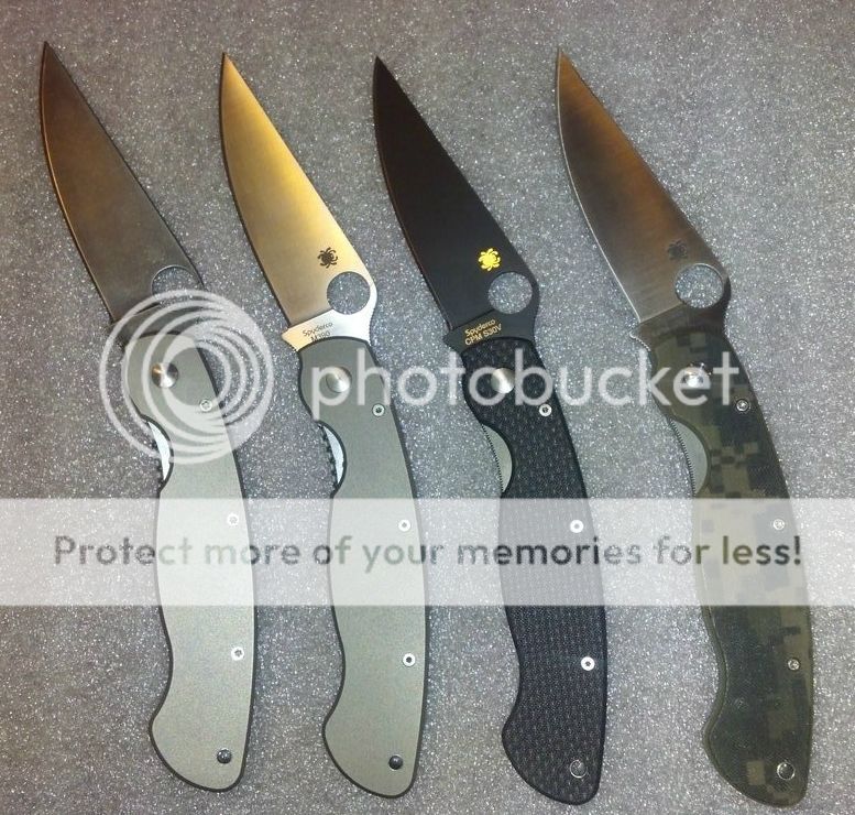

I've been thinking about trying this for some time. I poured a big glass of liquid courage and went for it tonight.
Ended up with a CTS-XHP blade with RIL Titanium lock side and brown G10 back side. I was thinking about using my Orange one for the back scale but decided, with the way the value on that one is increasing I'd leave it alone. Sooo no filing or smoothing necessary, everything went right together. A bit of extra gap on the liner lock version due to operator error, crimped one bushing in the process. I suspect by tightening it up more than usual it will come back in line. Both lock normally and no sticking when thumbing to close. Altogether I'd say not a job for the neophyte. Easy to get things wrong during reassembly. My main goal was weight. The TI is just too heavy at 5.8 oz. The regular is 4.2. My orange weighs in at 4.4. The RIL with CTS and brown is now 5.3 oz and the leftover is 5.1 oz. Doesn't seem like much but it really can make a difference.

I've been lucky I guess, and that my swaps have gone well. I've really only had one Ti Military, and the blade from my M390 went into that one. I had a CPM-M4 Military whose framelock side I kept, and I was able to get a Ti non-lock scale for it from a fellow member who used a brown G10 scale on his Ti Military. The black S30V blade from my Digicam went into the CF/M390 handle, and the satin S30V from the Ti Military went into the Digicam. Lockup and centering is also pretty much perfect on them too. Also eventually upgraded the screws to T8's and put standoffs in all of them.

Whoops! My bad. I went to set up the knives this morning and discovered the LL version pivot was not screwing down properly. The liner lock insert has the flat for the pivot index 180 out from the titanium side and was crush fitting against the end of the pivot pin. I removed the liner, rounded the hole, smoothed the pin and all is well. There is plenty of index provided by the ti side! I suspect this may have been your problem with the CF.
Yessir. I've been drinking some expensive single malts but broke out my bottle of Bulleit Rye last night. Only a couple of drams but that's some potent stuff. Interesting side note is that the liner lock version, now that it's modified to go together properly has the best blade centering I've ever seen on a Mili!

Each blade is fit by hand with the lock bar was my understanding. That would explain the difficulty.
Always possible I guess. My sample of 2 (not statistically significant) matched up pretty close. The LL engages at what I consider to be the minimum safe amount, a bit more than the width of the liner, and the RIL goes a bit past 50%. Close enough for me!
A little more information I've come up with. While playing with adjustments to smooth and lighten the action to be close to the unmodified orange I discovered the indents for the retaining balls are different sizes. I'm not equipped to start machining and drilling and searching for a proper ball bearing so I returned all to original configurations. They would work as they were modified but not perfectly. Oh well it was an interesting experiment and I learned some things in the process. At my age that's a good thing!
