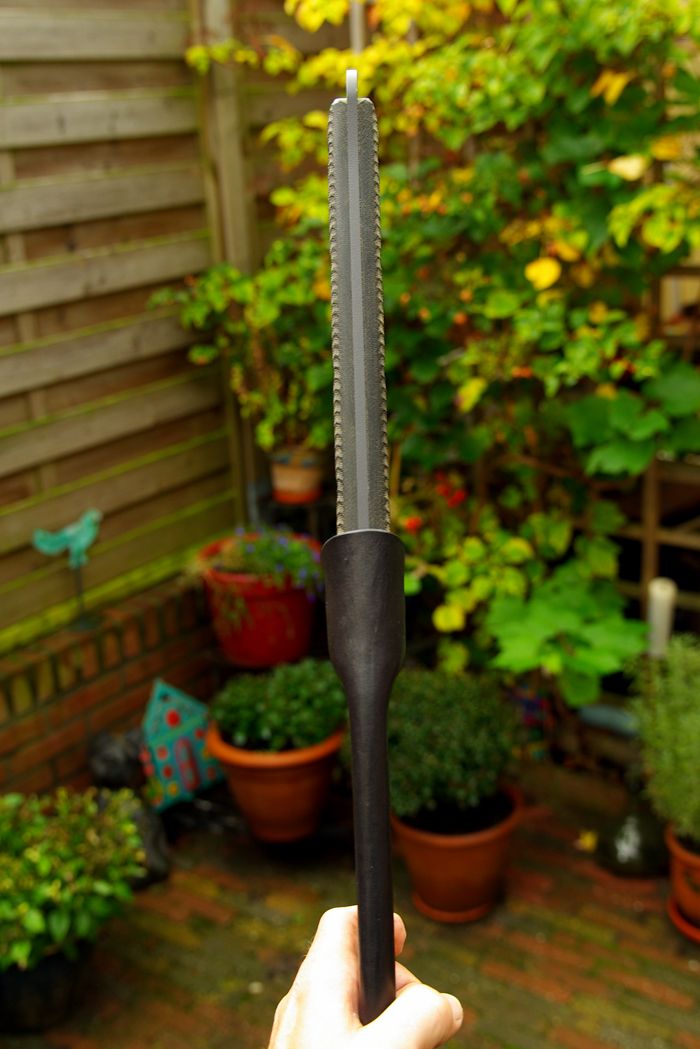

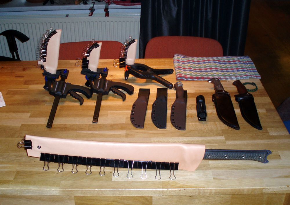

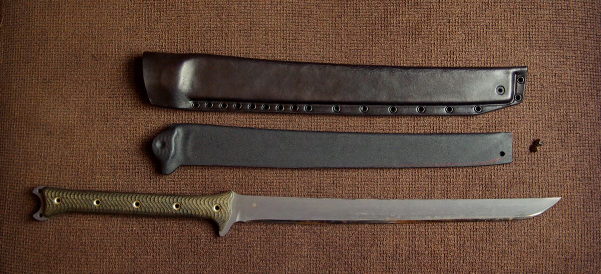

Finally I got to finish my first sheath for the Waki..
I had Wookie do the forming on the liners, and he did an excellent job on them.

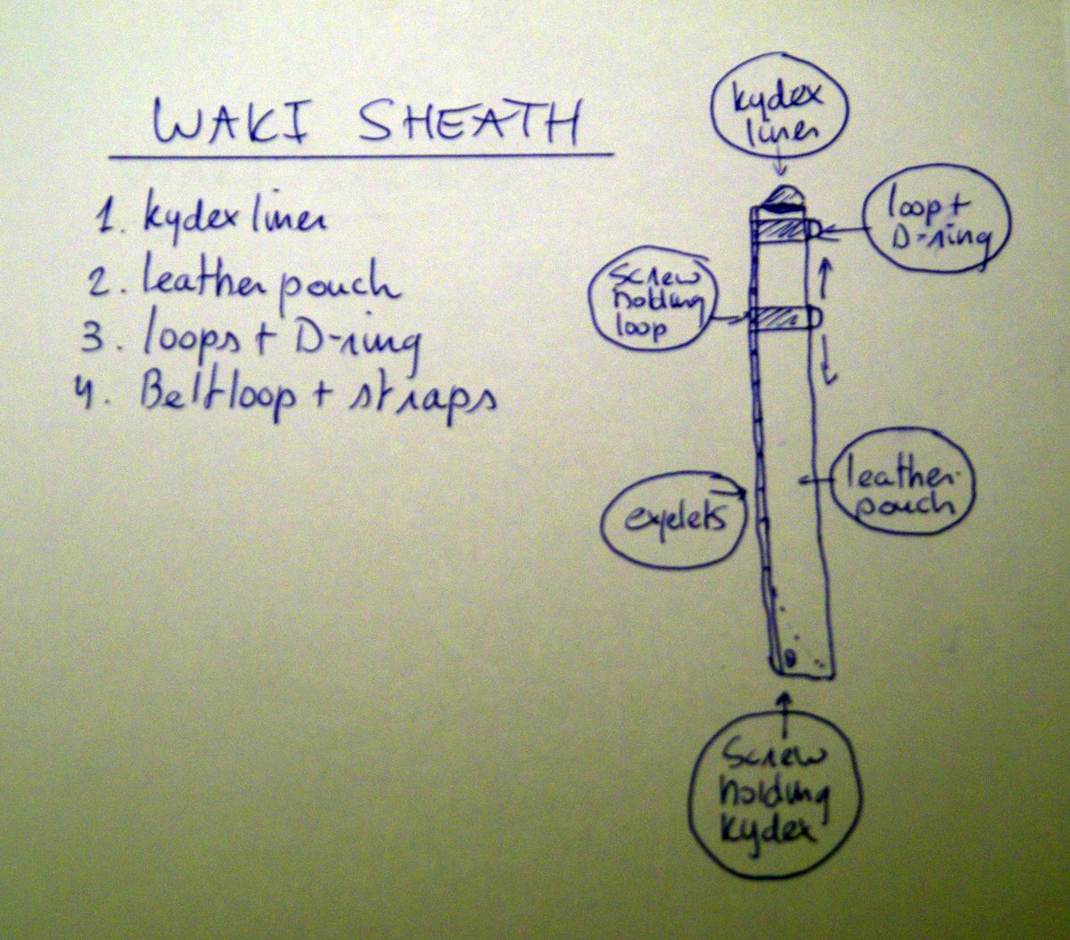

Kydex is 0.093”, and the pouch is stiff halftanned leather. This will serve as a platform for all kinds of attachement options. It could have loops for back carry, dangler carry, baldric style, etc, yet to be made J
First Sketch..
Leather drying up:
Done:
I hope you like it..

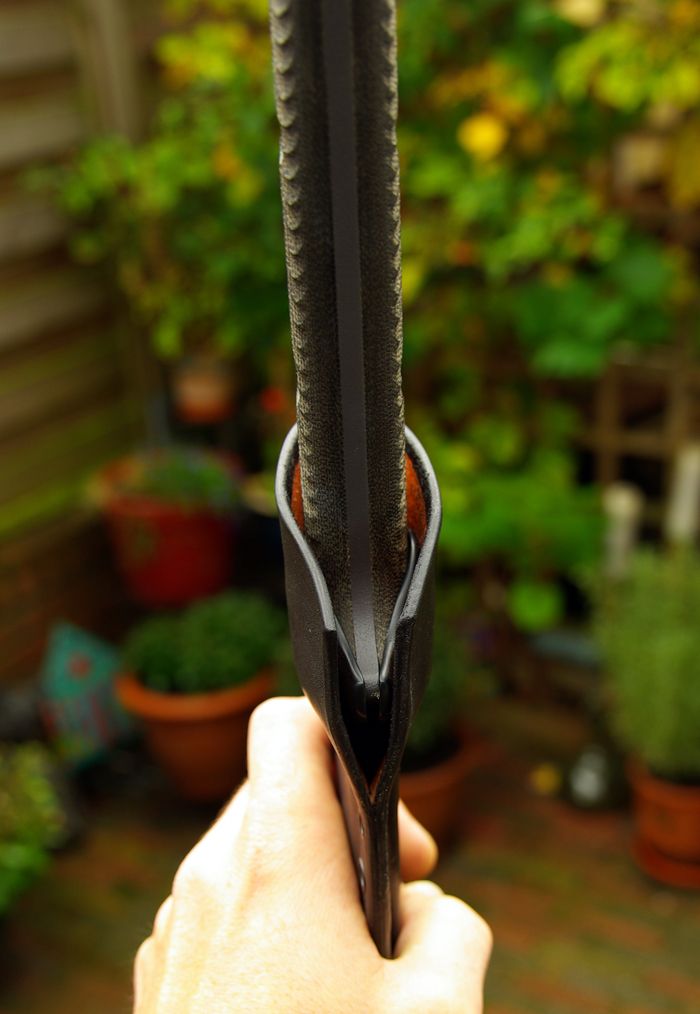

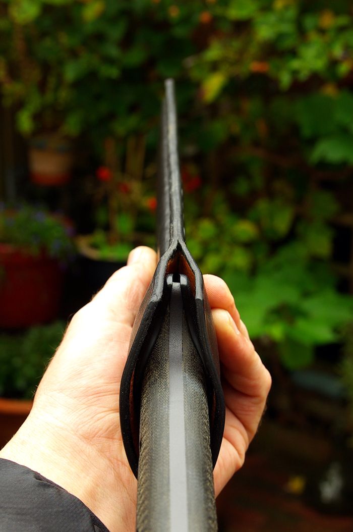

Don't you think an exoskeleton kydex structure will serve the sheath purpose better?
Kydex is harder and stronger than leather but scratches satin blade from time to time.
Would it be nice to put leather inside to protect the blade surface?
Yes.. Kydex with a leather liner will work fine..
It could even be made in a way that the sheath could be opened up for cleaning and waxing the leather.. That's the nice thing about having a custom sheath made.. You get to call the shots :)

I have to say your design suits Waki better than my suggestion.
Unless you have satin or DC blade surface, direct leather contact probably is not a good idea.
By the way, will it be OK to extend the sheath (both kydex & leather) further down the handle to the second hole?
