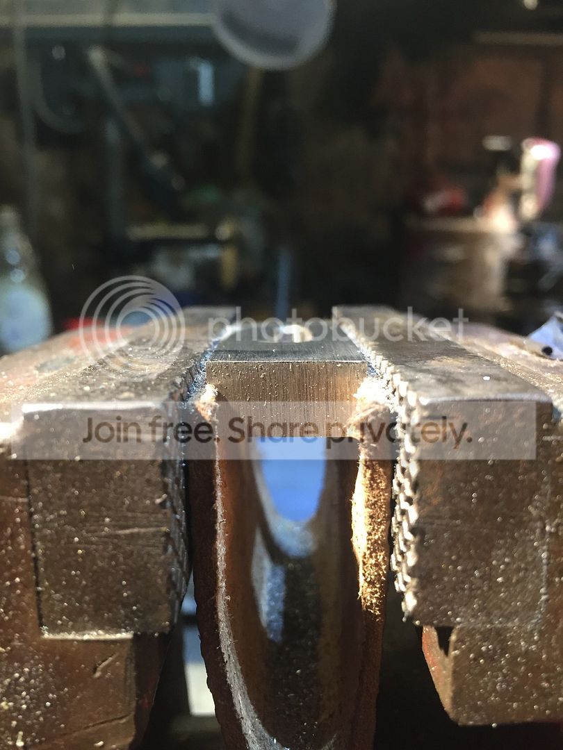

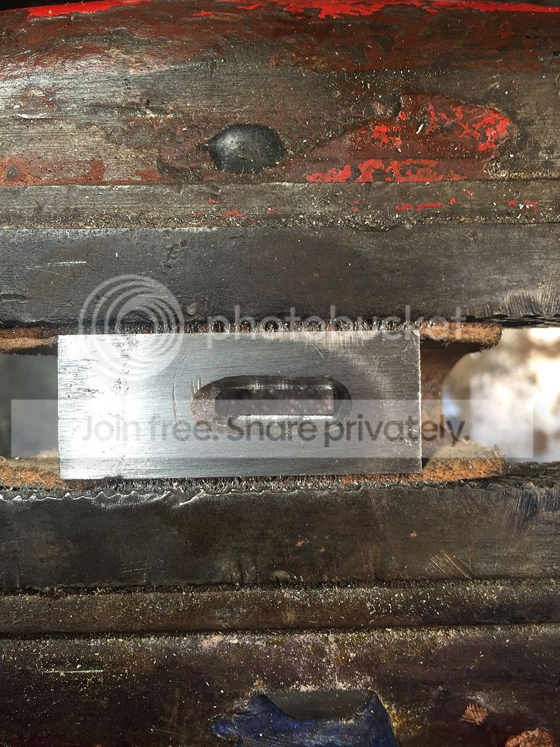

So in just about every thread I've read about slotting guards the OP usually tells you to relief the back of the guard so you only have to file about 20thou or so instead of the entire thickness of the guard. Nick Wheeler shows this in his epic thread. Well that's a great idea if you have a mill. I tried endmills in the drill and all that shit you aren't suppose to do and it never turned out how I needed it too. So I came up with this idea. I may not be the first to do this but thought I'd share. First I lay out the guard and drill a series of hole, get the Dremel and connect the dots. Once it's opened up I file the hole square like normal. The guard doesn't even go 1/4 of the way up the tang. Then I put it in my vice and make sure that it's as even across the top of the vise as possible.

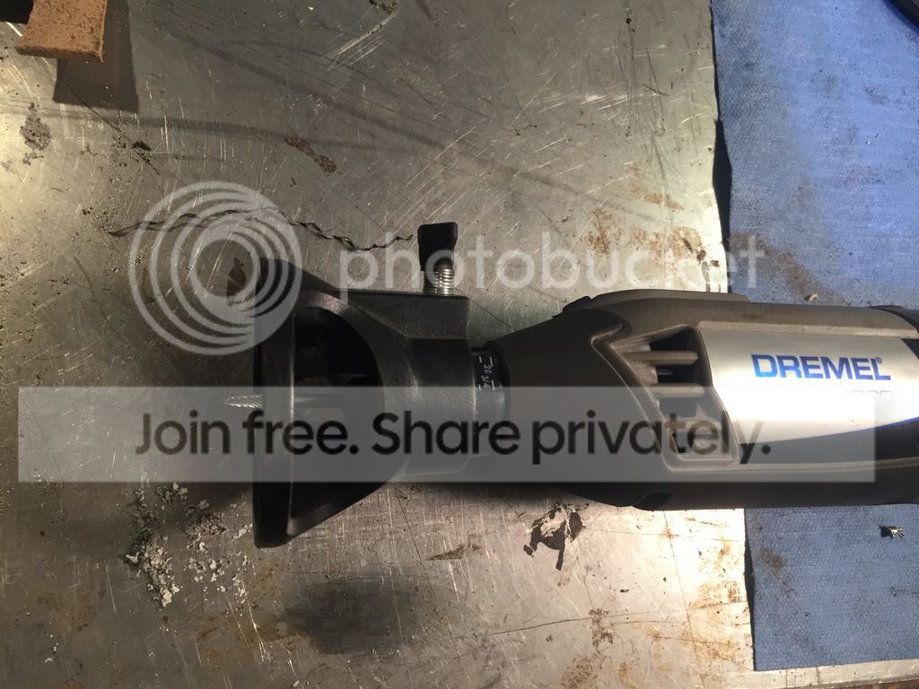

Then I chuck up a tapered burr bit into my Dremel, and put on the "router" attachment. Then I put it into the slot and adjust how deep I wanna cut.

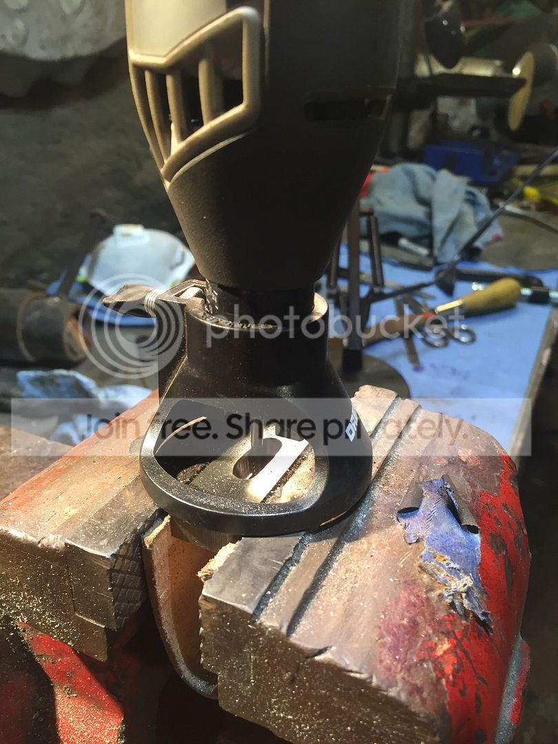

Once everything is tight (make sure your bit is tight or the damn thing will make a hell of a mess) I set it in onto the vise and inside the guard and start cutting. I cut against the rotation of the bit. Seems easier to control.
Then just keep going around until you have the backside relieved to where you want it. Then you only have to finish filing that small portion of metal and not the entire guard thickness. I've done this on my last two guards and the fit is 100 times better than I could get before. If you have any questions or ideas I'd love to hear them. I've learned a lot from this site and thought I should add a little something.
