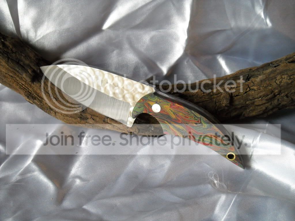

First of all, most of you probably dont know who the hell I am. For the most part I was a collector of knives but then got inspired by many to try my hand at knifemaking. I have only been at this seriously for about 3 months. That was when I got my Coote. I started with a little old Dayton 2x42" and damn near gave up. I am happy I didnt. I have fallen in love with this trade. This is my 4th blade and I think it turned out ok. I didnt finish filing the spine since my wife wants to test it first. I will let that be her decision.
Be easy on my guys/gals. This is nothing like what I see on the forum. Just a simple blade that tested my learning curve a little.
Here is a little something I made for the wife. An early Anniversary, Late Valentines and for carrying my boy in her tummy for me. As you can see, Jr. is growing like a weed already:D
After drooling over Martin Olexeys "Six Cleaver" I got inspired to make the wife a blade.
I traded Martin for some of his Smashed Hippie Micarta from Butch Harner. Thanks for the trade and inspiration buddy!
Specs:
Aldo's 1084
7 1/4" OAL
Red Liners
SS pin
Brass Lanyard tube
Jeweling on the flats and spine
Kydex sheath w/Tek-Lok
Thank you all for looking!
Chris

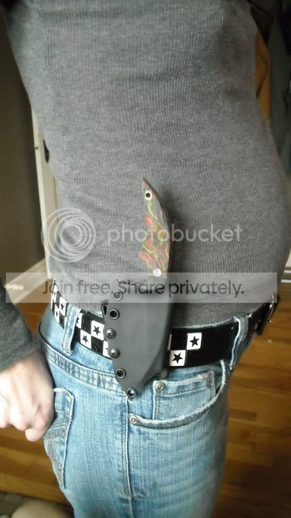

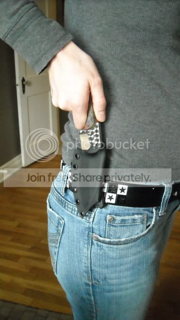

Question: With it riding that high on the belt, does it seems the handle might poke the wearer in the side from time to time???

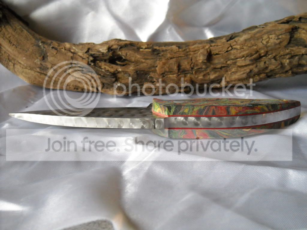

A very nice job for your fourth.Just a few thoughts on how to make it better.
First,the sharp corners on the handle are gonna cause hot spots in the hand,put a slight radius on them. Will make it feel better.
Second,I would have brought the grind line up about a 1/4" to even out the blade,thats just a personal opinion.
Really good,keep it up.
Stan

I noticed that when she put strapped it on, I asked her if I could round off the tang end a bit and she said no...lol I said the same thing, might be a little pokey. I might make a new sheath for it, or maybe do a drop leg type thing for her.

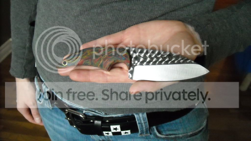

Thank you very much GB! I was clueless on this as well. I admired Martin Olexey's work he did on the "Six Cleaver" and asked him all about it. You more or less chuck a Cratex rod in your press and overlap each circle to your taste. I am still learning it myself....This was the third time I tried it. Gets better with practice, trust me....LOL
How did you do the engine turning, I love that look!!! Great piece BTW!

Yeah, I noticed that too. On the others I have made I rounded and blended them better. I will most likely take your advice and round them off a bit. Who likes blisters and blunt objects to the palm of our hands? I will take your advice my friend. I like the shaloow grind though, but I see what you mean!!

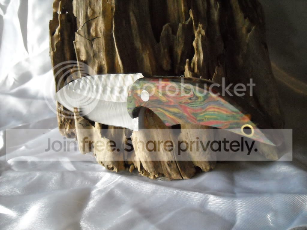

Well everything about it says it's "not my cup of tea", so to speak. But damn almost everthing about it says I like it! :confused:
I like the wild Micarta, I like the jeweling, not wild about the shape of the handle, I hate the Kydex (pesonal prefrence) but overall, let's just go with, I like it! :thumbup:

I am going to round off the squared micarta. Once I get my small wheel attachment from Norm it will help in my handle work. Plus I can do some texturing. Thanks for your honesty:thumbup::D

I just took Martins advice. Bought some cratex rods. You just chuck them in your press....I went with the fastest speed, but could probably slow it down a bit. He told me to just overlap each circle as straight as I can. I would practice on some scrap first to get a feel for it. I kind of rushed it after my quick practice lesson and my brothers did not turn out as well. My wifes looks good and think I got better at it. Oh, and he also said wire brush wheels work too with buffing compound. I have not tried it that way, I like the rubber/Cratex abrasives. But again...I have not tried the brush yet.
