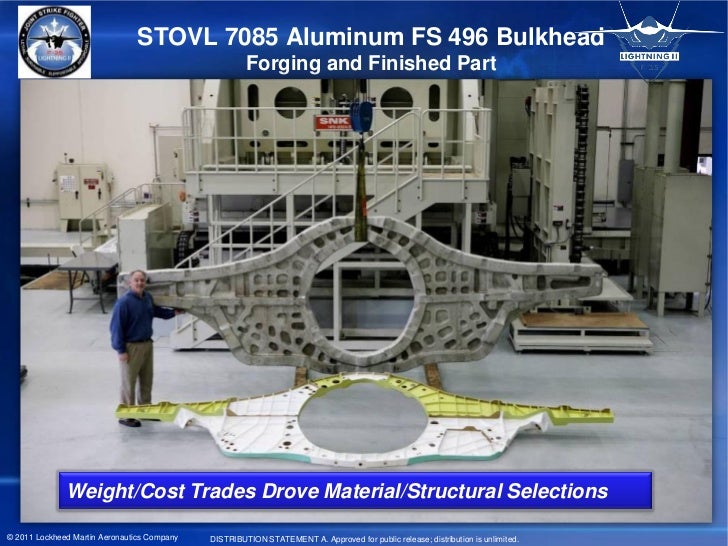

That's the good old F-35 I bet. It has a huge Titanium firewall/bulkkead that was showcased on PBS in the Nova episode Battle of the X-Planes. It's been a few yeas since I watched it but I'm betting it's made from 6-4.
Only the F-35B STOVL variant for the Marines / Royal Navy with the giant lift fan that sits just aft of the pilot has this bulkhead. It's to protect the pilot in case the lift fan comes apart catastrophically while running. ;) However, I have NO idea what kind of Ti was/is used for this part. (I did engineering/test work on the -B for ~5 years.)

If I remember the pictures I was shown correctly that F-35 STOVL bulkhead/firewall is ribbed, still a big hunk of Ti. Here's a link to the 496 bulk heads that run along the fuselage. The firewall/bulkhead behind the pilot in the STOVL variant is similar, thicker, Ti not Al and without the big hole of course.
https://image.slidesharecdn.com/ncs...-martin-presentation-12-728.jpg?cb=1345446363
Don't think that plate came from that bird. Really guessing a fancy pressure vessel of some kind.
Good point about the ribbing/machining on the bulkheads. This is done obviously to reduce weight. I do not recall exactly what the bulkhead behind the pilot looks like, as it's been over 10 years ago now, but I would also agree that it is really unlikely that piece of Ti came from JSF.
