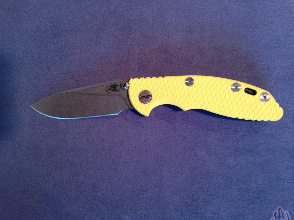

So a month ago I purchased an XM-18 3" from an authorized dealer who has been reliable in the past. I also bought yellow scales, and since it was my first Hinderer and I did not have the tool, the dealer offered to replace the black scale with the yellow scale for me. Picture below.
Well, being inspired by Need2Know (thanks for the instructions, BTW), I decided to replace the standoffs and scale with Blue. I bought a Hinderer armorer tool (5/64 bit - I checked) to do it.
Guess what: the 5/64 bit was too big to even fit in the screw holes. So I had to frantically search my tools for a smaller bit (was unmarked, but maybe 3/64) and completed the change.
But if 5/64 is the standard, what the heck are the screws in my knife??? I called the dealer and he said Hinderer either changed the size OR I was sold the wrong size tool (although the bit is marked 5/64).
My concern: if I resell or send for a repair in the future, will my knife be considered altered because they aren't 5/64? And why do they fit so perfectly otherwise? Any help with this mystery would be appreciated.
Well I have some information hope it helps. 5/64 fits my XM-3.5" but not my XM-3". Sorry the wrench is not marked so I am not sure of the size. It seems like the allen wrench for the 3" is smaller than for the 3.5". I think you are safe.
.047 is 3/64 or .078 is 5/64 couldn't you just measure your armorers tool with calipers?
Thanks to both of you - I am much relieved. I'll replace the bit in my Armorer tool and all will be well. Hey, at least I was able to change out the standoffs and scales on my own (with N2K's instructions), and being disabled, that is a feat on its own. I really feel good about being able to reassemble it perfectly. Thanks again, I am much relieved.
No worries. The 3" is unique to itself (as you discovered) the XM-18 3.5" and 24- 4" share the same size.
So, your 3" is fine (not altered).

I just picked up a 3" XM to go with my 3.5" XM. The scale screw heads were stripped and I had to back them out with an EZ out. Before trying to make a set, I decided to put a call into Rob over at Hinderer. For the price, I just ordered a new set and he (Rob) told me they (the screws for the 3") are a 1/16 HEX.

The bit that is standard with the Armorer's tool is 5/64". If you are really nice to Mr. Orlando, he might substitute a 1/16" when you order :) I use the Thorp drivers, use caution with the 1/16" screws, the Thorp is tough enough to strip the screws. Cheap hex wrenches/bits will round off and ruin the screws.
Oh I have plenty of tools. It is just when I bought my Armorer tool from Howe, I specifically asked if it would work with the 3" and he said "yes." So I was mystified. All my screws are snug enough, that I won't need Loctite. If my pivot moves around, I'll use teflon tape.
