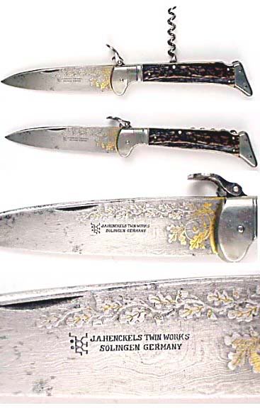

It's a fair conclusion that pattern wielded damascus was in near continuous production in Germany during the 20th century -
Henckels from the late 1800's - 1930's cataloged deluxe jagdmesser and hirschfager like the below -
Other German examples -

I'm sure if one tried they could fill in all the decades of the 20th century with German damascus examples.
