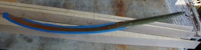

I was wondering would anyone be able to direct me to where I could possibly have a shaft for my naginata and yari ordered?
I currently have both a modern made naginata and yari that need a shaft, would it also be possible to have the shaft be made in aluminum?

I make my own out of ash wood. You are going to have to fit it to the blades/tangs anyway.
You could check placed like Shadows of Leaves and Bugei and see if any sell bank shafts.
Also if you do decide to make your own, you can buy “heavy duty closet shafts” from Lowe’s, if you don’t care about traditional construction. They are 1 1/2”-2” spliced oak shafts, all you’d have to do is reduce the diameter a bit for yari, and make it kinda apple-seed in cross section for the naginata...
they sell them in pretty obscene lengths too, I just picked up an 8 foot one I plan to make into a yari, after I make the blade. Someday.

I have considered doing that, my concern consists mostly on getting the proper fittings for the shaft. And I do also want it lacquered.
As well would a shaft made of aluminum be a viable option?
If you want a ninja version, make it out of anything.
If you want a traditional shaft it should be wood, preferably ho, aspen, or ash. You can get square cut slices off a 6/4 plank and quickly carve them down with a draw knife ... or just grind them round on a 36 grit belt. The end for the naginata will need to be split and fitted to the blade nakago. The yari end will likely need a hole for the tang and be tapered to fit the socket.

If so I’d shy away from aluminum, it pretty soft and pliable in the easy to get sizes and won’t hold up to the impacts of training.

I was planning on using them for martial arts practice, along with using them on targets for both stabbing and slashing.
There are a lot of suitable grades of Aluminum, maybe some thick wall 6061 would do the trick. I would prefer wood for the slight bit of flex it has.
Just an update, so I decided to go ahead with using ashwood as a shaft and ordered one for my yari, but I need a shaft with a wider diameter than what i've seen available. (I've only found ashwood poles with a diameter of only 1 1/4 inches, I need at least a 1 1/2 inch diamater shaft for the naginata)
Get a 6/4 or 8/4 plank of ash from a good lumber yard and have it ripped into square sticks. Make them round with hand tools or power grinders. taper and fit as needed.

My last Naginata was make as a take down weapon that would fit in a sword bag Besides the blades being removed, the shaft was dovetailed together under the mid-shaft wrap. The hammered copper collars reinforced the blade tangs as well as the shaft center joint..

Some shots of the shaft in assembly and fitting of the blades and joint:
